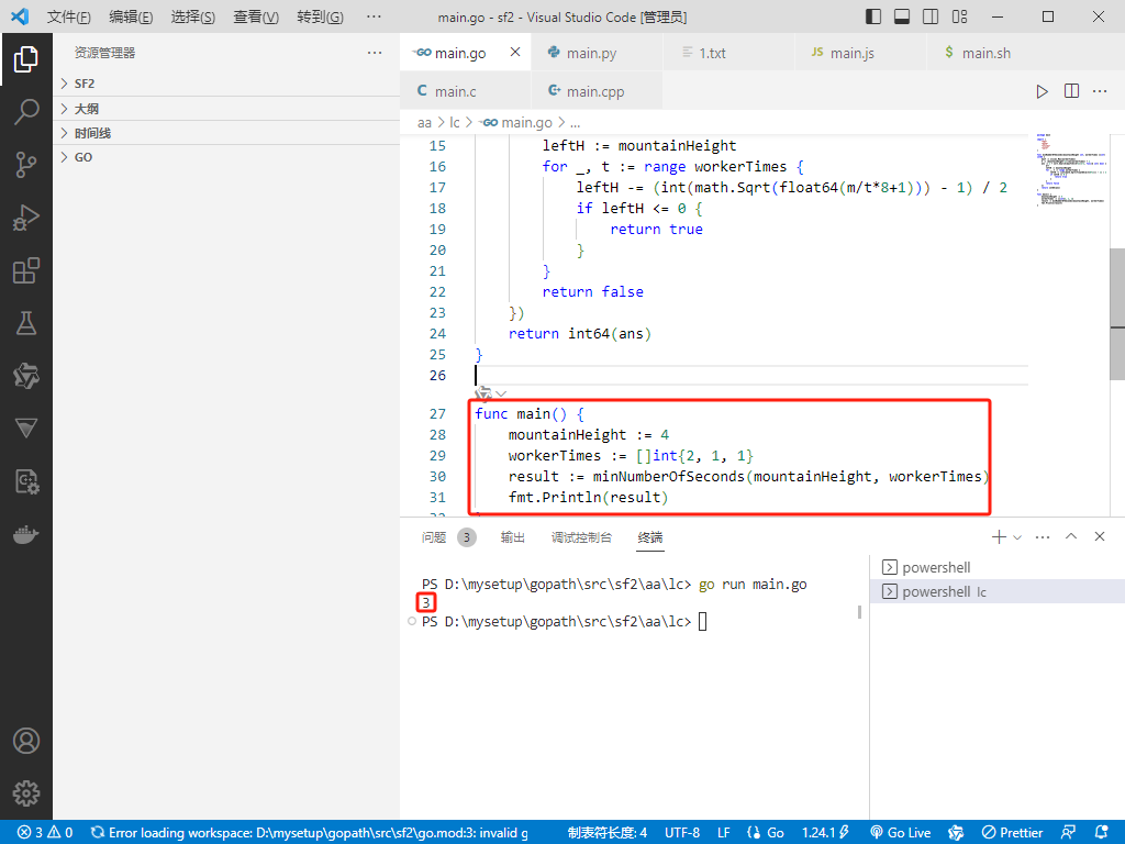

Go完整代码如下:
package main
import (
	"fmt"
	"math"
	"slices"
	"sort"
func minNumberOfSeconds(mountainHeight int, workerTimes []int) int64 {
	maxT := slices.Max(workerTimes)
	h := (mountainHeight-1)/len(workerTimes) + 1
	ans := 1 + sort.Search(maxT*h*(h+1)/2-1, func(m int) bool {
		m++
		leftH := mountainHeight
		for _, t := range workerTimes {
			leftH -= (int(math.Sqrt(float64(m/t*8+1))) - 1) / 2
			if leftH <= 0 {
				return true
		return false
	return int64(ans)
func main() {
	mountainHeight := 4
	workerTimes := []int{2, 1, 1}
	result := minNumberOfSeconds(mountainHeight, workerTimes)
	fmt.Println(result)

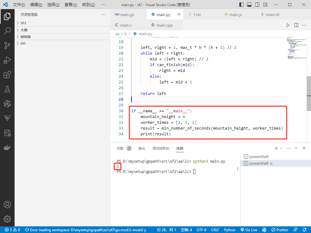

Python完整代码如下:
# -*-coding:utf-8-*-
import math
def min_number_of_seconds(mountain_height: int, worker_times: list[int]) -> int:
    max_t = max(worker_times)
    h = (mountain_height - 1) // len(worker_times) + 1
    def can_finish(m: int) -> bool:
        left_h = mountain_height
        for t in worker_times:
            # 等效于 Go 代码的:(int(math.Sqrt(float64(m/t*8+1))) - 1) / 2
            count = (int(math.isqrt(m // t * 8 + 1)) - 1) // 2
            left_h -= count
            if left_h <= 0:
                return True
        return False
    left, right = 1, max_t * h * (h + 1) // 2
    while left < right:
        mid = (left + right) // 2
        if can_finish(mid):
            right = mid
        else:
            left = mid + 1
    return left
if __name__ == "__main__":
    mountain_height = 4
    worker_times = [2, 1, 1]
    result = min_number_of_seconds(mountain_height, worker_times)
    print(result)
