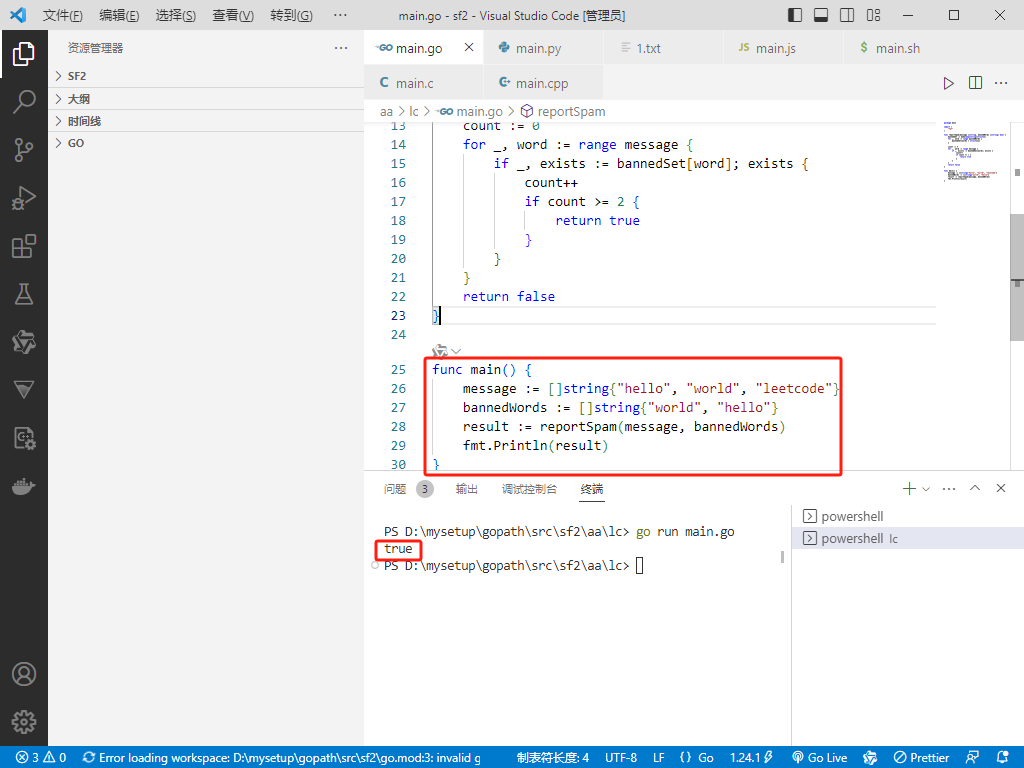

Go完整代码如下:
package main
import (
	"fmt"
func reportSpam(message []string, bannedWords []string) bool {
	bannedSet := make(map[string]struct{})
	for _, word := range bannedWords {
		bannedSet[word] = struct{}{}
	count := 0
	for _, word := range message {
		if _, exists := bannedSet[word]; exists {
			count++
			if count >= 2 {
				return true
	return false
func main() {
	message := []string{"hello", "world", "leetcode"}
	bannedWords := []string{"world", "hello"}
	result := reportSpam(message, bannedWords)
	fmt.Println(result)

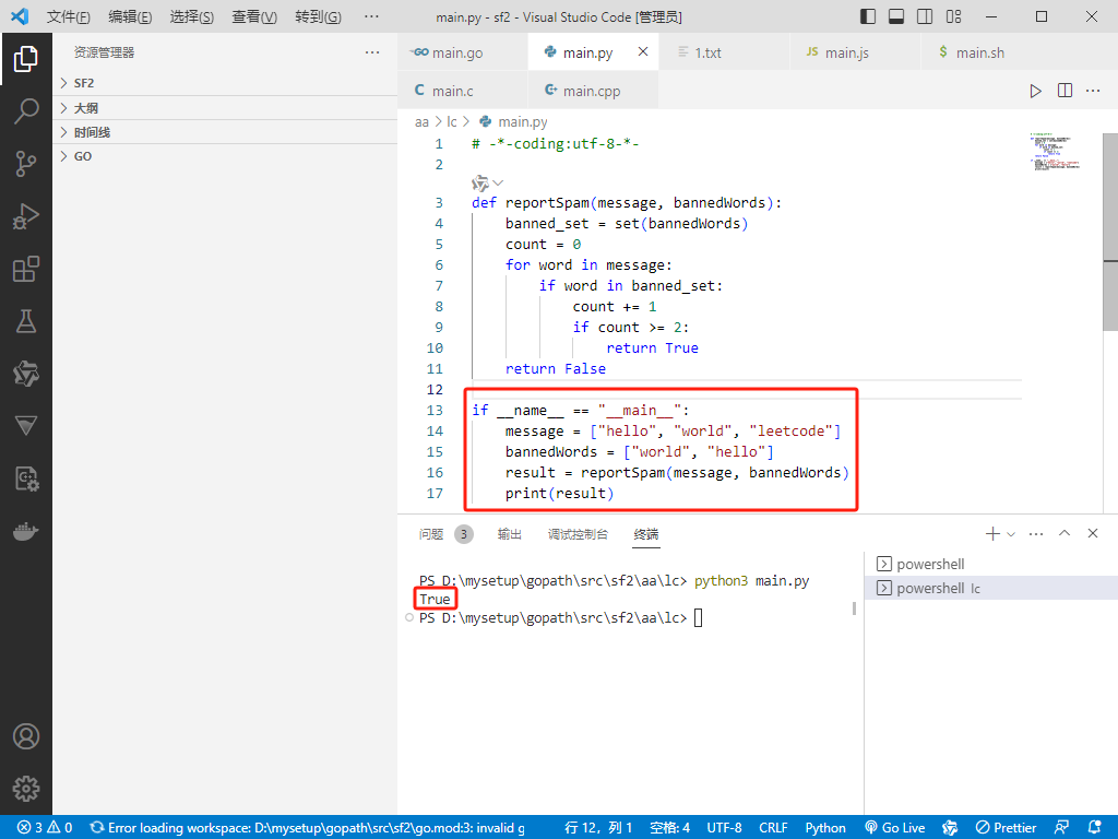

Python完整代码如下:
# -*-coding:utf-8-*-
def reportSpam(message, bannedWords):
    banned_set = set(bannedWords)
    count = 0
    for word in message:
        if word in banned_set:
            count += 1
            if count >= 2:
                return True
    return False
if __name__ == "__main__":
    message = ["hello", "world", "leetcode"]
    bannedWords = ["world", "hello"]
    result = reportSpam(message, bannedWords)
    print(result)
