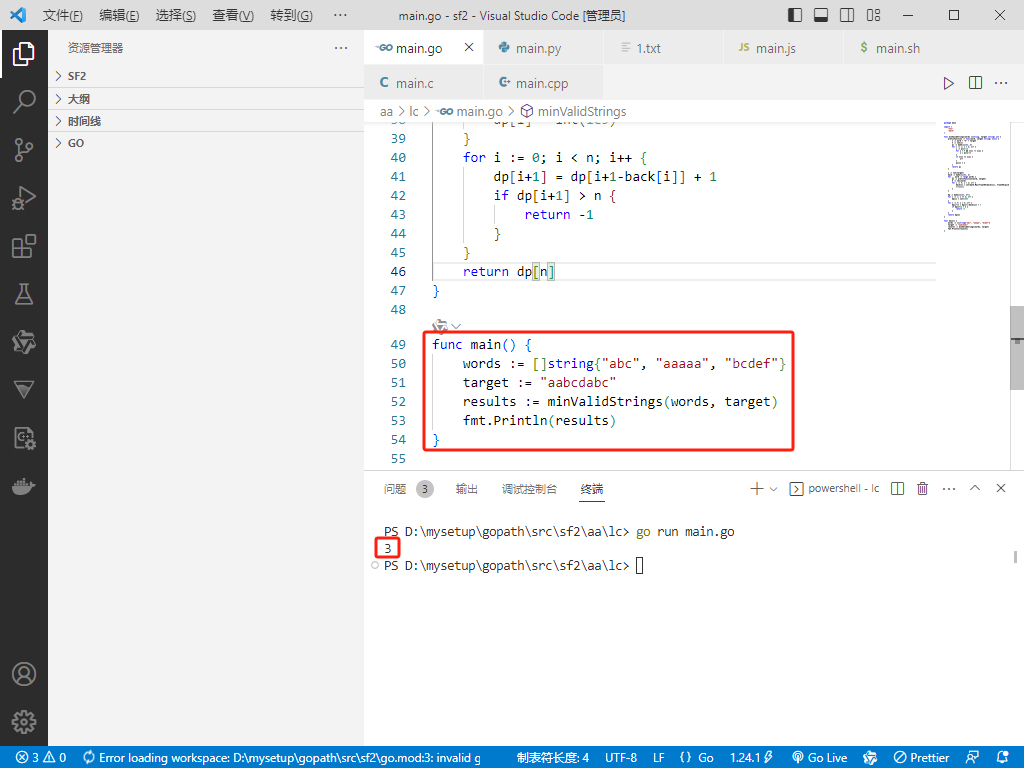

Go完整代码如下:
package main
import (
"fmt"
"math"
func minValidStrings(words []string, target string) int {
prefixFunction := func(word, target string) []int {
s := word + "#" + target
n := len(s)
pi := make([]int, n)
for i := 1; i < n; i++ {
j := pi[i-1]
for j > 0 && s[i] != s[j] {
j = pi[j-1]
if s[i] == s[j] {
j++
pi[i] = j
return pi
n := len(target)
back := make([]int, n)
for _, word := range words {
pi := prefixFunction(word, target)
m := len(word)
for i := 0; i < n; i++ {
back[i] = int(math.Max(float64(back[i]), float64(pi[m+1+i])))
dp := make([]int, n+1)
for i := 1; i <= n; i++ {
dp[i] = int(1e9)
dp[i+1] = dp[i+1-back[i]] + 1
if dp[i+1] > n {
return -1
return dp[n]
func main() {
words := []string{"abc", "aaaaa", "bcdef"}
target := "aabcdabc"
results := minValidStrings(words, target)
fmt.Println(results)

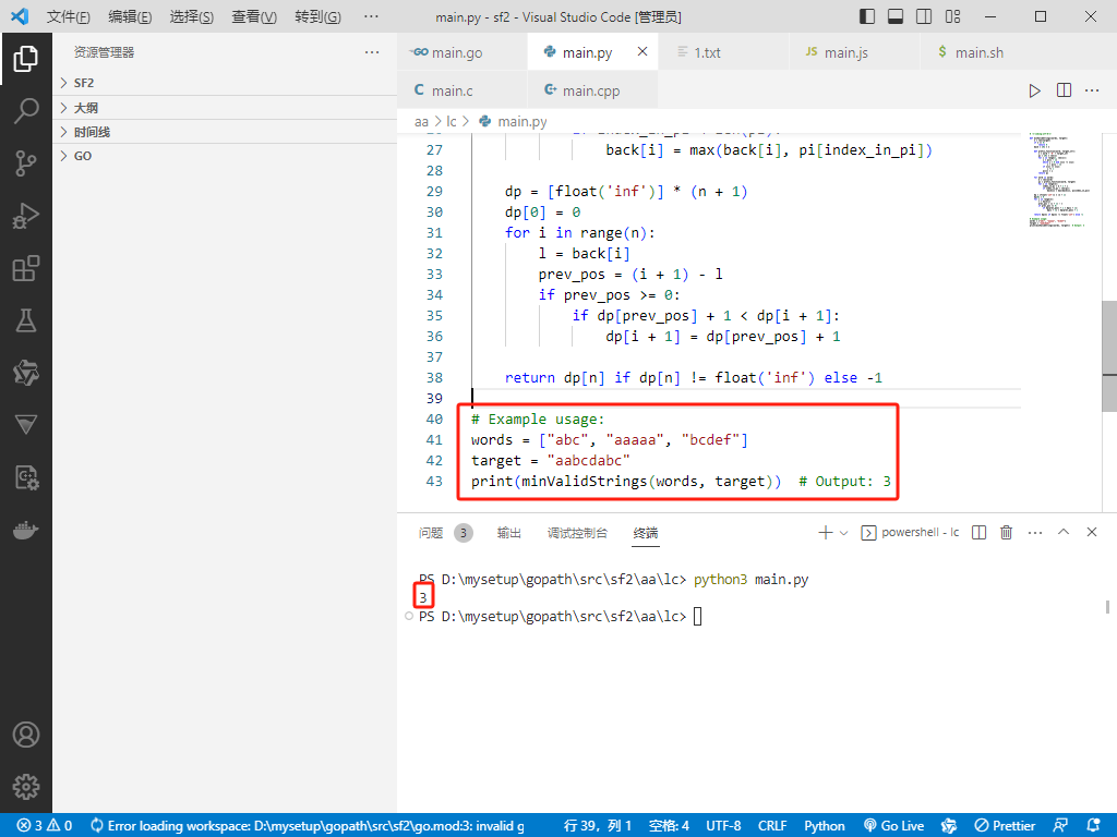

Python完整代码如下:
# -*-coding:utf-8-*-
def minValidStrings(words, target):
n = len(target)
if n == 0:
return 0
back = [0] * n
def prefix_function(word, target_str):
s = word + '#' + target_str
pi = [0] * len(s)
for i in range(1, len(s)):
j = pi[i - 1]
while j > 0 and s[i] != s[j]:
j = pi[j - 1]
if s[i] == s[j]:
j += 1
pi[i] = j
return pi
for word in words:
m = len(word)
pi = prefix_function(word, target)
for i in range(n):
index_in_pi = m + 1 + i
if index_in_pi < len(pi):
back[i] = max(back[i], pi[index_in_pi])
dp = [float('inf')] * (n + 1)
dp[0] = 0
for i in range(n):
l = back[i]
prev_pos = (i + 1) - l
if prev_pos >= 0:
if dp[prev_pos] + 1 < dp[i + 1]:
dp[i + 1] = dp[prev_pos] + 1
return dp[n] if dp[n] != float('inf') else -1
# Example usage:
words = ["abc", "aaaaa", "bcdef"]
target = "aabcdabc"
print(minValidStrings(words, target)) # Output: 3
