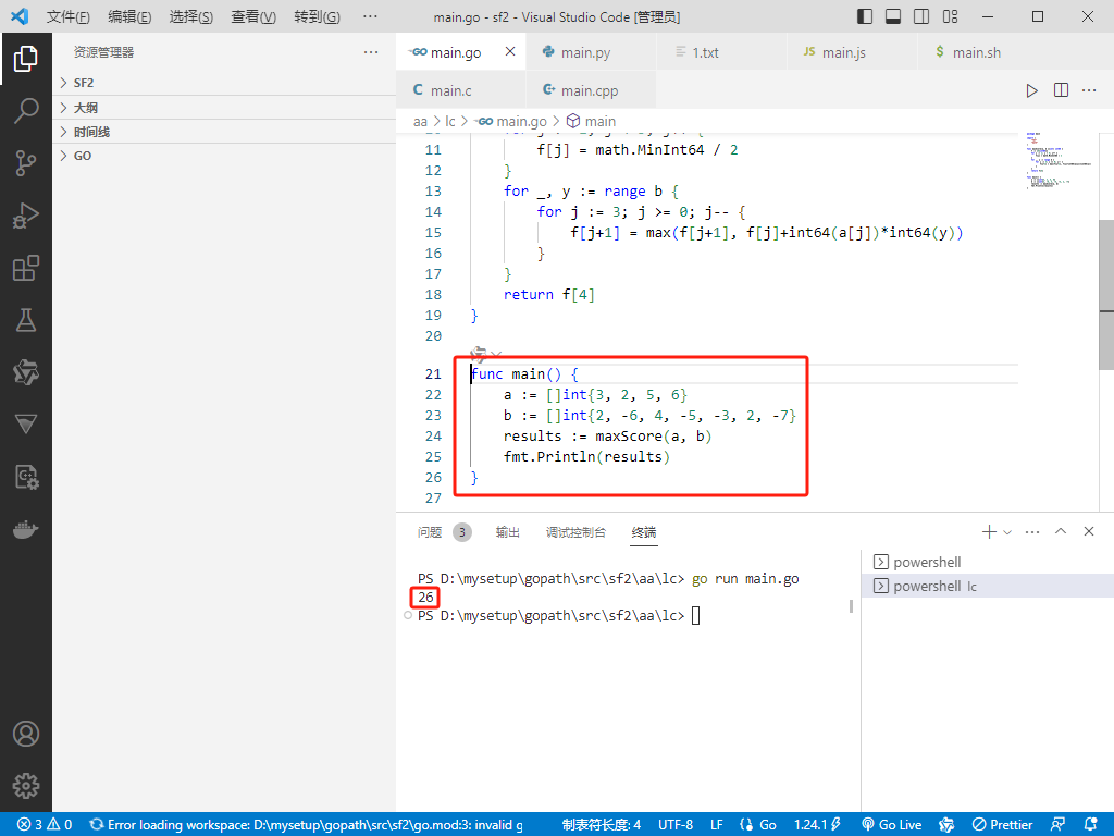

Go完整代码如下:
package main
import (
"fmt"
"math"
func maxScore(a, b []int) int64 {
f := [5]int64{}
for j := 1; j < 5; j++ {
f[j] = math.MinInt64 / 2
for _, y := range b {
for j := 3; j >= 0; j-- {
f[j+1] = max(f[j+1], f[j]+int64(a[j])*int64(y))
return f[4]
func main() {
a := []int{3, 2, 5, 6}
b := []int{2, -6, 4, -5, -3, 2, -7}
results := maxScore(a, b)
fmt.Println(results)

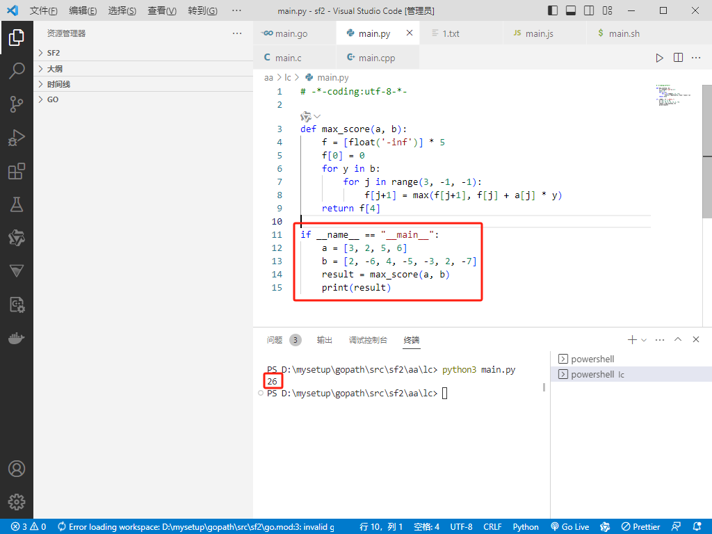

Python完整代码如下:
# -*-coding:utf-8-*-
def max_score(a, b):
f = [float('-inf')] * 5
f[0] = 0
for y in b:
for j in range(3, -1, -1):
f[j+1] = max(f[j+1], f[j] + a[j] * y)
return f[4]
if __name__ == "__main__":
a = [3, 2, 5, 6]
b = [2, -6, 4, -5, -3, 2, -7]
result = max_score(a, b)
print(result)
