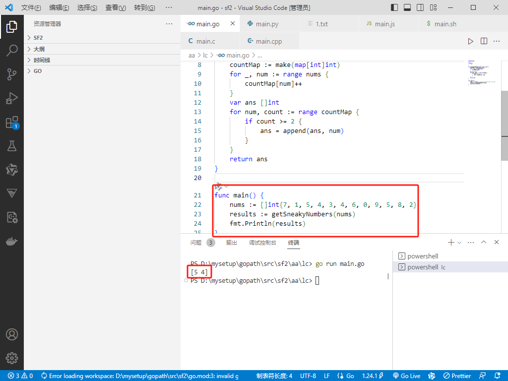

Go完整代码如下:
package main
import (
	"fmt"
func getSneakyNumbers(nums []int) []int {
	countMap := make(map[int]int)
	for _, num := range nums {
		countMap[num]++
	var ans []int
	for num, count := range countMap {
		if count >= 2 {
			ans = append(ans, num)
	return ans
func main() {
	nums := []int{7, 1, 5, 4, 3, 4, 6, 0, 9, 5, 8, 2}
	results := getSneakyNumbers(nums)
	fmt.Println(results)

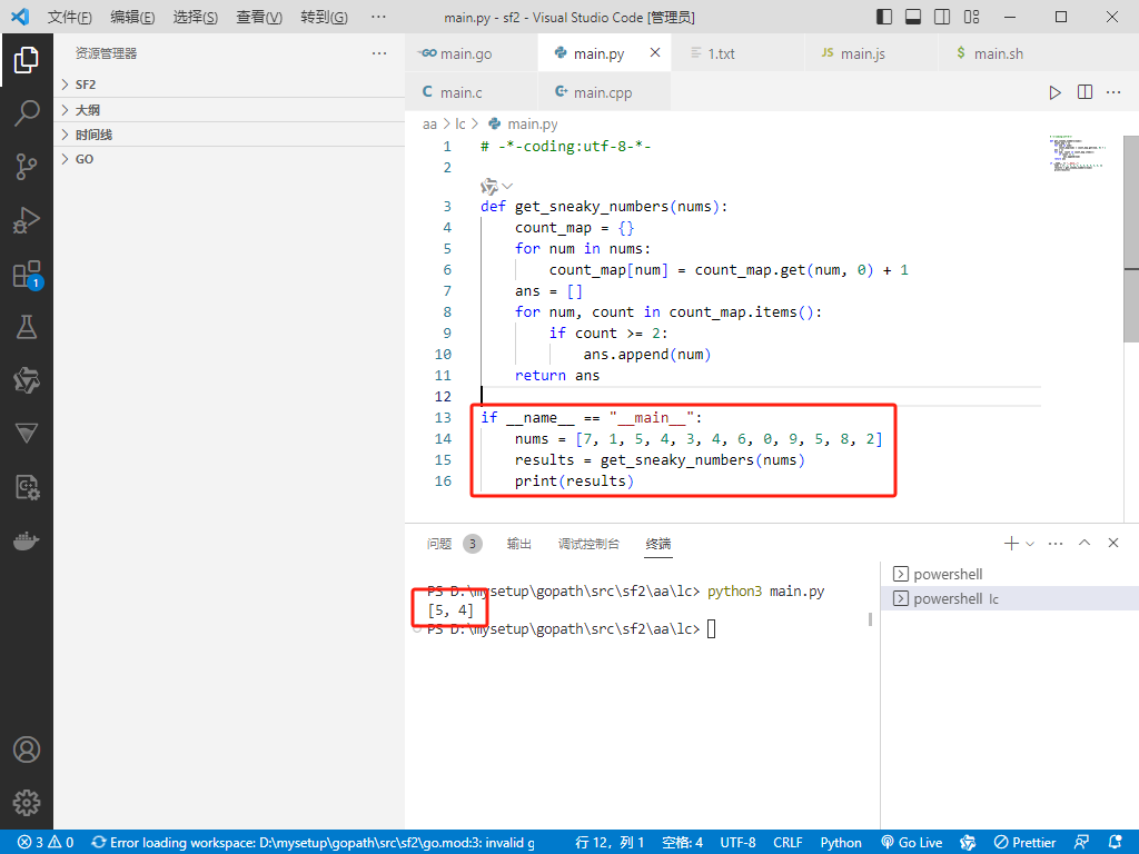

Python完整代码如下:
# -*-coding:utf-8-*-
def get_sneaky_numbers(nums):
    count_map = {}
    for num in nums:
        count_map[num] = count_map.get(num, 0) + 1
    ans = []
    for num, count in count_map.items():
        if count >= 2:
            ans.append(num)
    return ans
if __name__ == "__main__":
    nums = [7, 1, 5, 4, 3, 4, 6, 0, 9, 5, 8, 2]
    results = get_sneaky_numbers(nums)
    print(results)
