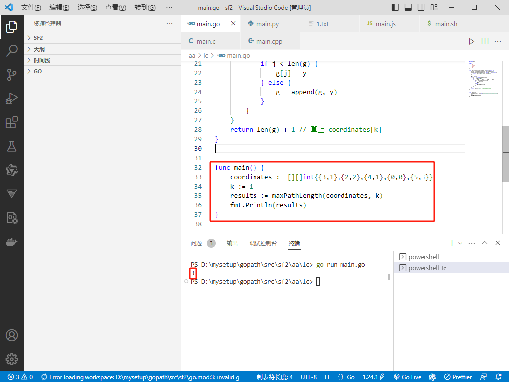

package main
import (
	"fmt"
	"slices"
	"sort"
	"cmp"
func maxPathLength(coordinates [][]int, k int) int {
	kx, ky := coordinates[k][0], coordinates[k][1]
	slices.SortFunc(coordinates, func(a, b []int) int {
		return cmp.Or(a[0]-b[0], b[1]-a[1])
	g := []int{}
	for _, p := range coordinates {
		x, y := p[0], p[1]
		if x < kx && y < ky || x > kx && y > ky {
			j := sort.SearchInts(g, y)
			if j < len(g) {
				g[j] = y
			} else {
				g = append(g, y)
	return len(g) + 1 // 算上 coordinates[k]
func main() {
	coordinates := [][]int{{3,1},{2,2},{4,1},{0,0},{5,3}}
	k := 1
	results := maxPathLength(coordinates, k)
	fmt.Println(results)

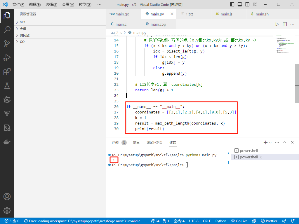

# -*-coding:utf-8-*-
from bisect import bisect_left
def max_path_length(coordinates, k):
    kx, ky = coordinates[k]
    # 按x升序,x相同按y降序排序
    coordinates.sort(key=lambda p: (p[0], -p[1]))
    g = []
    for x, y in coordinates:
        # 保留与k点同方向的点(x,y都比kx,ky大 或 都比kx,ky小)
        if (x < kx and y < ky) or (x > kx and y > ky):
            idx = bisect_left(g, y)
            if idx < len(g):
                g[idx] = y
            else:
                g.append(y)
    # LIS长度+1,算上coordinates[k]
    return len(g) + 1
if __name__ == "__main__":
    coordinates = [[3,1],[2,2],[4,1],[0,0],[5,3]]
    k = 1
    result = max_path_length(coordinates, k)
    print(result)
