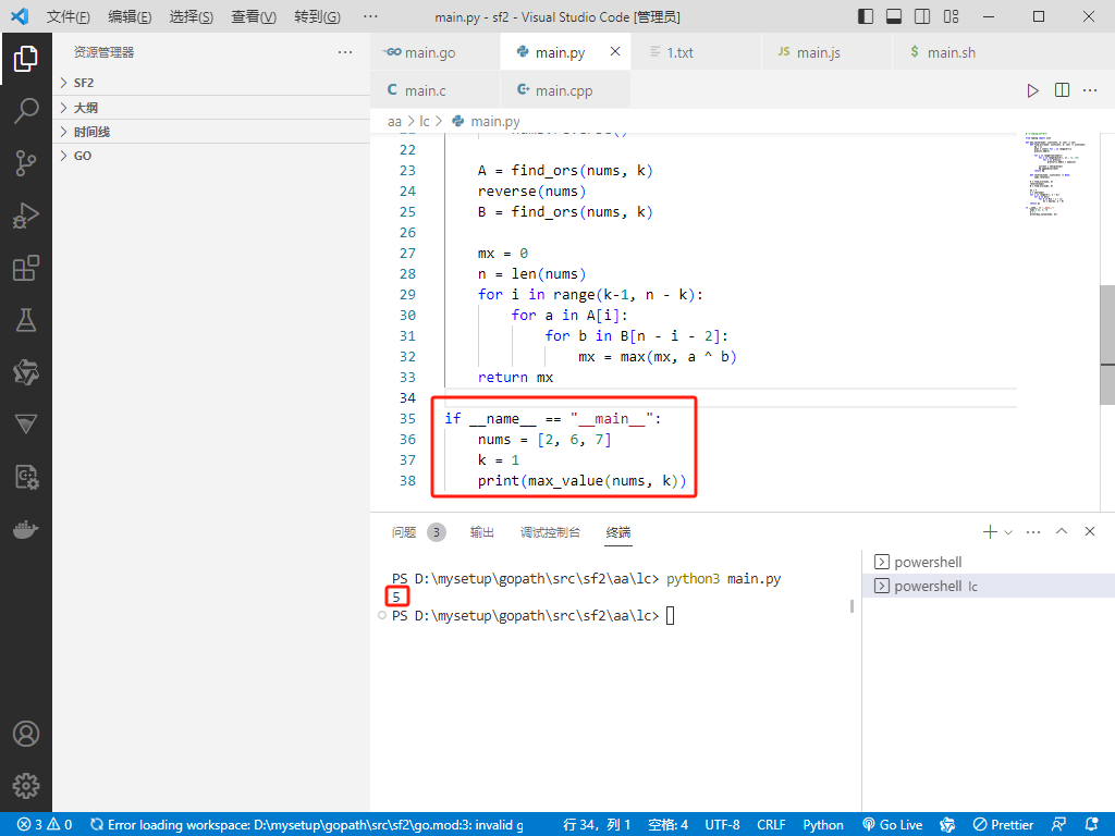

Python完整代码如下:
# -*-coding:utf-8-*-
from typing import List
def max_value(nums: List[int], k: int) -> int:
    def find_ors(nums: List[int], k: int) -> List[set]:
        dp = []
        prev = [set() for _ in range(k+1)]
        prev[0].add(0)
        for i in range(len(nums)):
            for j in range(min(k-1, i) , -1, -1):
                for x in prev[j]:
                    prev[j+1].add(x | nums[i])
            current = set(prev[k])
            dp.append(current)
        return dp
    def reverse(nums: List[int]) -> None:
        nums.reverse()
    A = find_ors(nums, k)
    reverse(nums)
    B = find_ors(nums, k)
    mx = 0
    n = len(nums)
    for i in range(k-1, n - k):
        for a in A[i]:
            for b in B[n - i - 2]:
                mx = max(mx, a ^ b)
    return mx
if __name__ == "__main__":
    nums = [2, 6, 7]
    k = 1
    print(max_value(nums, k))
