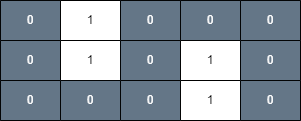

输入:grid = [[0,1,0,0,0],[0,1,0,1,0],[0,0,0,1,0]], health = 1 。
输出:true 。
解释:
沿着下图中灰色格子走,可以安全到达最终的格子。

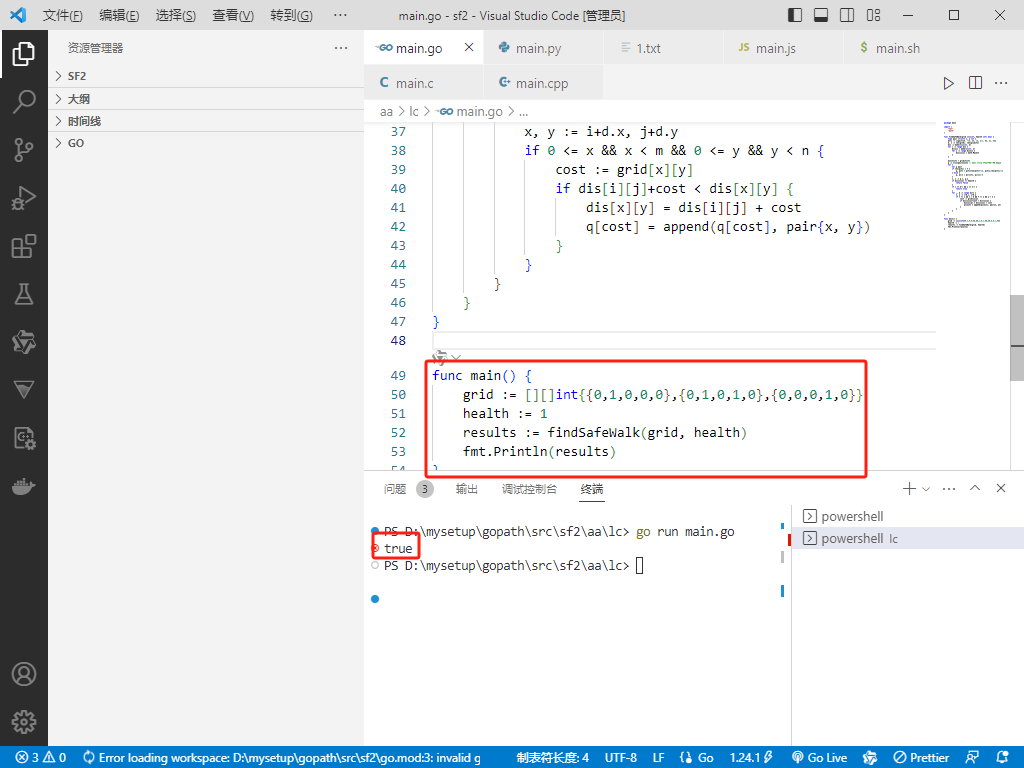

Go完整代码如下:
package main
import (
	"fmt"
	"math"
func findSafeWalk(grid [][]int, health int) bool {
	type pair struct{ x, y int }
	dirs := []pair{{0, -1}, {0, 1}, {-1, 0}, {1, 0}}
	m, n := len(grid), len(grid[0])
	dis := make([][]int, m)
	for i := range dis {
		dis[i] = make([]int, n)
		for j := range dis[i] {
			dis[i][j] = math.MaxInt
	dis[0][0] = grid[0][0]
	q := [2][]pair{{{}}} // 两个 slice 头对头来实现 deque
	for {
		var p pair
		if len(q[0]) > 0 {
			p, q[0] = q[0][len(q[0])-1], q[0][:len(q[0])-1]
		} else {
			p, q[1] = q[1][0], q[1][1:]
		i, j := p.x, p.y
		if dis[i][j] >= health {
			return false
		if i == m-1 && j == n-1 {
			return true
		for _, d := range dirs {
			x, y := i+d.x, j+d.y
			if 0 <= x && x < m && 0 <= y && y < n {
				cost := grid[x][y]
				if dis[i][j]+cost < dis[x][y] {
					dis[x][y] = dis[i][j] + cost
					q[cost] = append(q[cost], pair{x, y})
func main() {
	grid := [][]int{{0,1,0,0,0},{0,1,0,1,0},{0,0,0,1,0}}
	health := 1
	results := findSafeWalk(grid, health)
	fmt.Println(results)

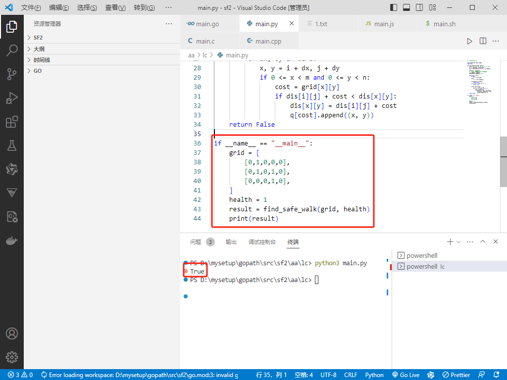

Python完整代码如下:
# -*-coding:utf-8-*-
from collections import deque
import sys
def find_safe_walk(grid, health):
    dirs = [(0, -1), (0, 1), (-1, 0), (1, 0)]
    m, n = len(grid), len(grid[0])
    dis = [[sys.maxsize] * n for _ in range(m)]
    # 使用两个双端队列模拟0-1 BFS的deque
    q = [deque(), deque()]
    q[dis[0][0]].append((0, 0))
    while q[0] or q[1]:
        if q[0]:
            i, j = q[0].pop()
        else:
            i, j = q[1].popleft()
        if dis[i][j] >= health:
            return False
        if i == m - 1 and j == n - 1:
            return True
        for dx, dy in dirs:
            x, y = i + dx, j + dy
            if 0 <= x < m and 0 <= y < n:
                cost = grid[x][y]
                if dis[i][j] + cost < dis[x][y]:
                    q[cost].append((x, y))
    return False
if __name__ == "__main__":
    grid = [
        [0,1,0,0,0],
        [0,1,0,1,0],
        [0,0,0,1,0],
    health = 1
    result = find_safe_walk(grid, health)
    print(result)
