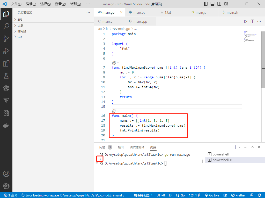

Go完整代码如下:
package main
import (
	"fmt"
func findMaximumScore(nums []int) (ans int64) {
	mx := 0
	for _, x := range nums[:len(nums)-1] {
		mx = max(mx, x)
		ans += int64(mx)
	return
func main() {
	nums := []int{1, 3, 1, 5}
	results := findMaximumScore(nums)
	fmt.Println(results)

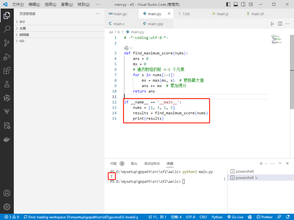

Python完整代码如下:
# -*-coding:utf-8-*-
def find_maximum_score(nums):
    ans = 0
    mx = 0
    # 遍历数组的前 n-1 个元素
    for x in nums[:-1]:
        mx = max(mx, x)  # 更新最大值
        ans += mx  # 累加得分
    return ans
if __name__ == '__main__':
    nums = [1, 3, 1, 5]
    results = find_maximum_score(nums)
    print(results)
