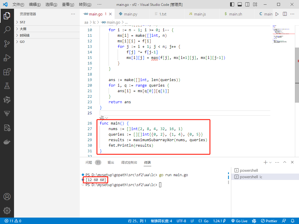

Go完整代码如下:
package main
import (
	"fmt"
func maximumSubarrayXor(f []int, queries [][]int) []int {
	n := len(f)
	mx := make([][]int, n)
	for i := n - 1; i >= 0; i-- {
		mx[i] = make([]int, n)
		mx[i][i] = f[i]
		for j := i + 1; j < n; j++ {
			f[j] ^= f[j-1]
			mx[i][j] = max(f[j], mx[i+1][j], mx[i][j-1])
	ans := make([]int, len(queries))
	for i, q := range queries {
		ans[i] = mx[q[0]][q[1]]
	return ans
func main() {
	nums := []int{2, 8, 4, 32, 16, 1}
	queries := [][]int{{0, 2}, {1, 4}, {0, 5}}
	results := maximumSubarrayXor(nums, queries)
	fmt.Println(results)

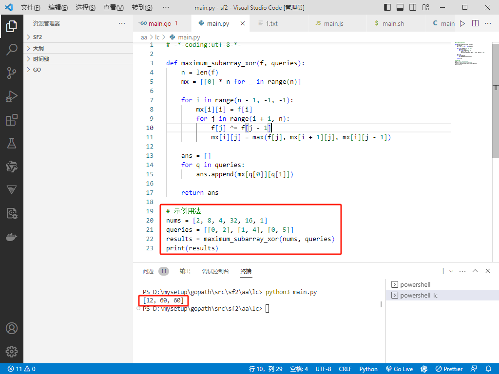

Python完整代码如下:
# -*-coding:utf-8-*-
def maximum_subarray_xor(f, queries):
    n = len(f)
    mx = [[0] * n for _ in range(n)]
    for i in range(n - 1, -1, -1):
        mx[i][i] = f[i]
        for j in range(i + 1, n):
            f[j] ^= f[j - 1]
            mx[i][j] = max(f[j], mx[i + 1][j], mx[i][j - 1])
    ans = []
    for q in queries:
        ans.append(mx[q[0]][q[1]])
    return ans
# 示例用法
nums = [2, 8, 4, 32, 16, 1]
queries = [[0, 2], [1, 4], [0, 5]]
results = maximum_subarray_xor(nums, queries)
print(results)
