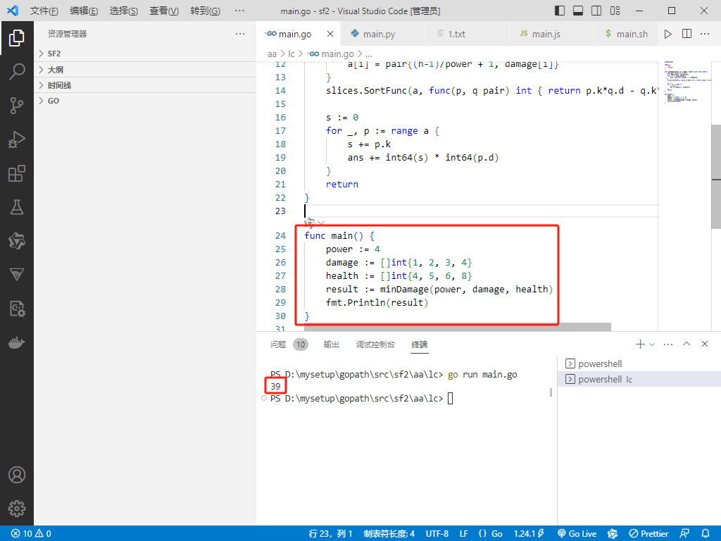

Go完整代码如下:
package main
import (
	"fmt"
	"slices"
func minDamage(power int, damage, health []int) (ans int64) {
	type pair struct{ k, d int }
	a := make([]pair, len(health))
	for i, h := range health {
		a[i] = pair{(h-1)/power + 1, damage[i]}
	slices.SortFunc(a, func(p, q pair) int { return p.k*q.d - q.k*p.d })
	s := 0
	for _, p := range a {
		s += p.k
		ans += int64(s) * int64(p.d)
	return
func main() {
	power := 4
	damage := []int{1, 2, 3, 4}
	health := []int{4, 5, 6, 8}
	result := minDamage(power, damage, health)
	fmt.Println(result)

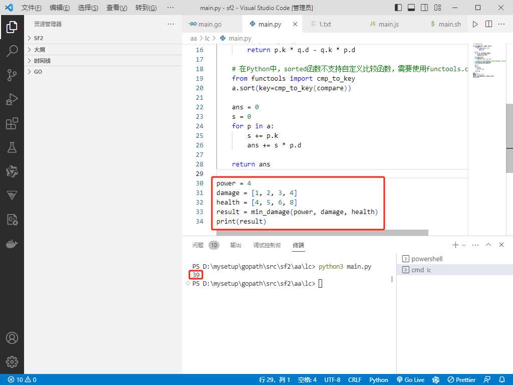

Python完整代码如下:
# -*-coding:utf-8-*-
def min_damage(power, damage, health):
    class Pair:
        def __init__(self, k, d):
            self.k = k
            self.d = d
    a = []
    for h, d in zip(health, damage):
        k = (h - 1) // power + 1
        a.append(Pair(k, d))
    # 自定义排序函数
    def compare(p, q):
        return p.k * q.d - q.k * p.d
    # 在Python中,sorted函数不支持自定义比较函数,需要使用functools.cmp_to_key
    from functools import cmp_to_key
    a.sort(key=cmp_to_key(compare))
    ans = 0
    s = 0
    for p in a:
        s += p.k
        ans += s * p.d
    return ans
power = 4
damage = [1, 2, 3, 4]
health = [4, 5, 6, 8]
result = min_damage(power, damage, health)
print(result)
