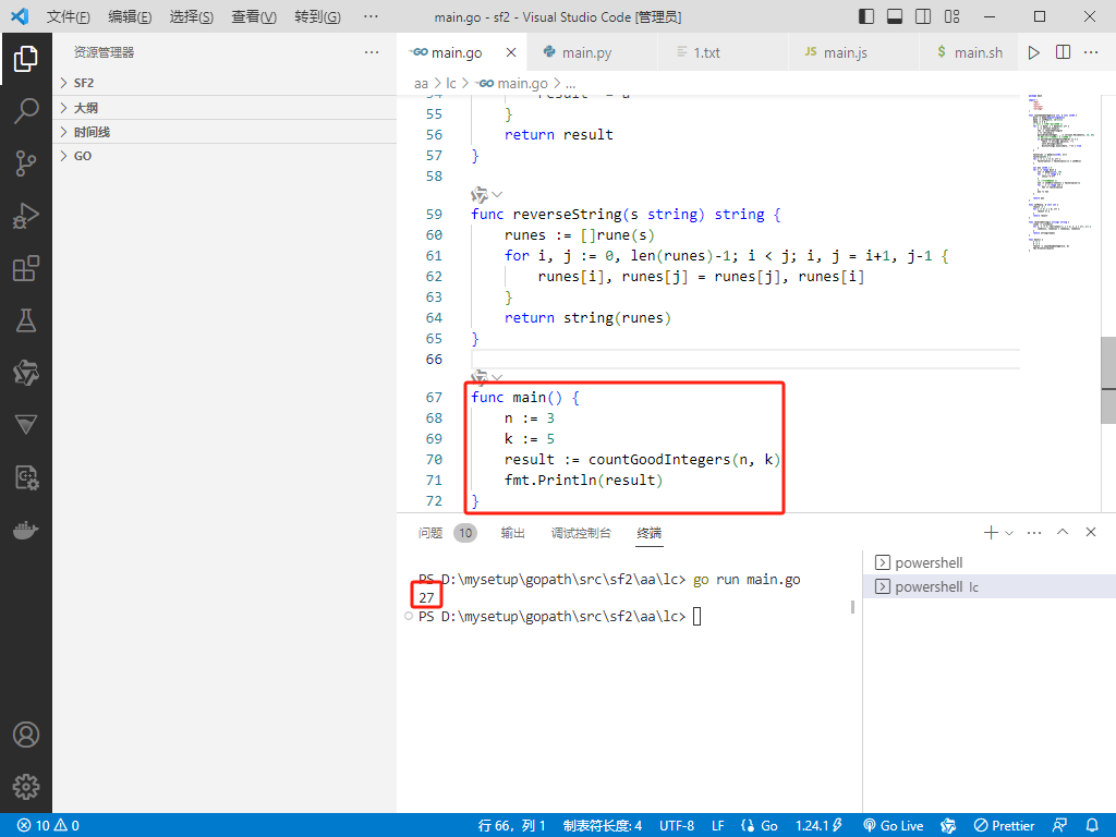

Go完整代码如下:
package main
import (
"fmt"
"sort"
"strconv"
"strings"
func countGoodIntegers(n int, k int) int64 {
dict := make(map[string]bool)
base := intPow(10, (n-1)/2)
skip := n & 1
/* 枚举 n 个数位的回文数 */
for i := base; i < base*10; i++ {
s := strconv.Itoa(i)
rev := reverseString(s)
s += rev[skip:]
palindromicInteger, _ := strconv.ParseInt(s, 10, 64)
/* 如果当前回文数是 k 回文数 */
if palindromicInteger%int64(k) == 0 {
chars := strings.Split(s, "")
sort.Strings(chars)
dict[strings.Join(chars, "")] = true
factorial := make([]int64, n+1)
factorial[0] = 1
for i := 1; i <= n; i++ {
factorial[i] = factorial[i-1] * int64(i)
var ans int64 = 0
for s := range dict {
cnt := make([]int, 10)
for _, c := range s {
cnt[c-'0']++
/* 计算排列组合 */
tot := int64(n-cnt[0]) * factorial[n-1]
for _, x := range cnt {
tot /= factorial[x]
ans += tot
return ans
func intPow(a, b int) int {
result := 1
for i := 0; i < b; i++ {
result *= a
return result
func reverseString(s string) string {
runes := []rune(s)
for i, j := 0, len(runes)-1; i < j; i, j = i+1, j-1 {
runes[i], runes[j] = runes[j], runes[i]
return string(runes)
func main() {
n := 3
k := 5
result := countGoodIntegers(n, k)
fmt.Println(result)

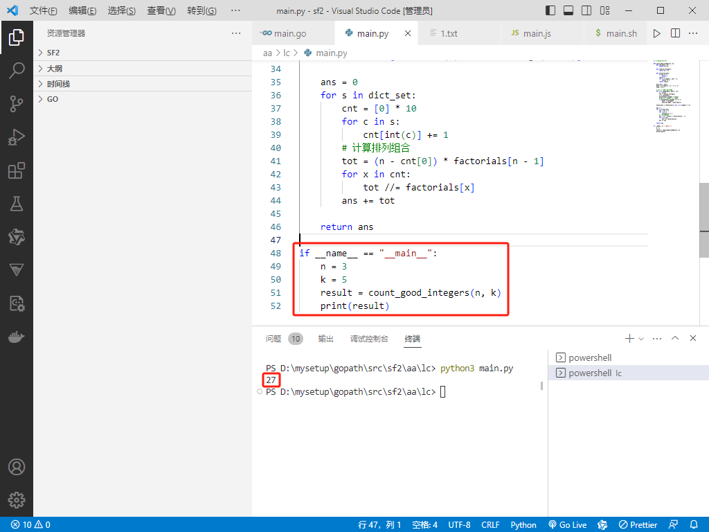

Python完整代码如下:
# -*-coding:utf-8-*-
def count_good_integers(n, k):
def int_pow(a, b):
return a ** b
def reverse_string(s):
return s[::-1]
def factorial(num):
if num == 0:
return 1
result = 1
for i in range(1, num + 1):
result *= i
return result
dict_set = set()
base = int_pow(10, (n - 1) // 2)
skip = n & 1
# 枚举 n 个数位的回文数
for i in range(base, base * 10):
s = str(i)
rev = reverse_string(s)
s += rev[skip:]
palindromic_integer = int(s)
# 如果当前回文数是 k 回文数
if palindromic_integer % k == 0:
chars = sorted(s)
dict_set.add(''.join(chars))
factorials = [factorial(i) for i in range(n + 1)]
ans = 0
for s in dict_set:
cnt = [0] * 10
for c in s:
cnt[int(c)] += 1
# 计算排列组合
tot = (n - cnt[0]) * factorials[n - 1]
for x in cnt:
tot //= factorials[x]
ans += tot
return ans
if __name__ == "__main__":
n = 3
k = 5
result = count_good_integers(n, k)
print(result)
