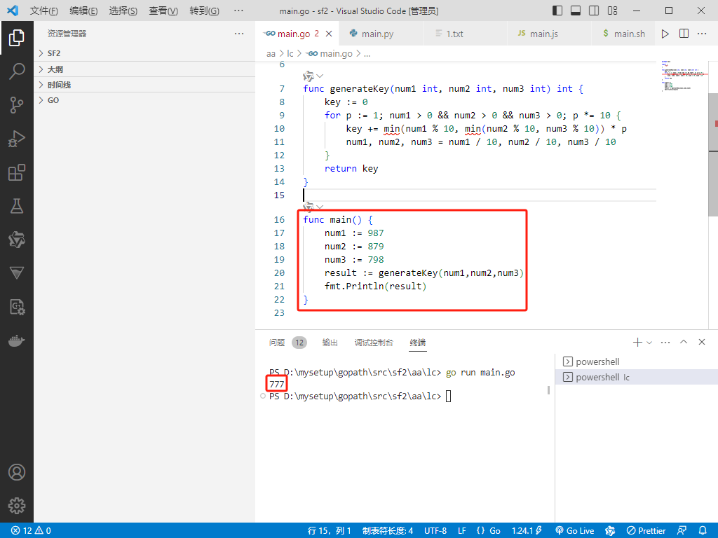

Go完整代码如下:
package main
import (
	"fmt"
func generateKey(num1 int, num2 int, num3 int) int {
    key := 0
    for p := 1; num1 > 0 && num2 > 0 && num3 > 0; p *= 10 {
        key += min(num1 % 10, min(num2 % 10, num3 % 10)) * p
        num1, num2, num3 = num1 / 10, num2 / 10, num3 / 10
    return key
func main() {
	num1 := 987
	num2 := 879
	num3 := 798
	result := generateKey(num1,num2,num3)
	fmt.Println(result)

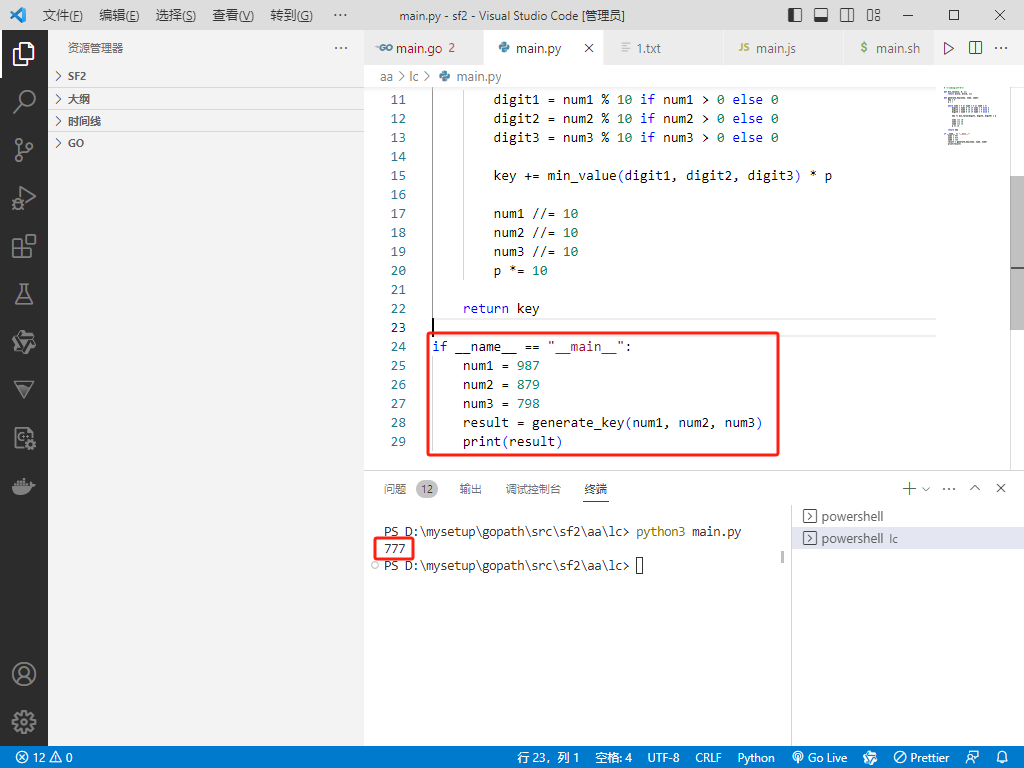

Python完整代码如下:
# -*-coding:utf-8-*-
def min_value(a, b, c):
    return min(a, min(b, c))
def generate_key(num1, num2, num3):
    key = 0
    p = 1
    while num1 > 0 or num2 > 0 or num3 > 0:
        digit1 = num1 % 10 if num1 > 0 else 0
        digit2 = num2 % 10 if num2 > 0 else 0
        digit3 = num3 % 10 if num3 > 0 else 0
        key += min_value(digit1, digit2, digit3) * p
        num1 //= 10
        num2 //= 10
        num3 //= 10
        p *= 10
    return key
if __name__ == "__main__":
    num1 = 987
    num2 = 879
    num3 = 798
    result = generate_key(num1, num2, num3)
    print(result)
