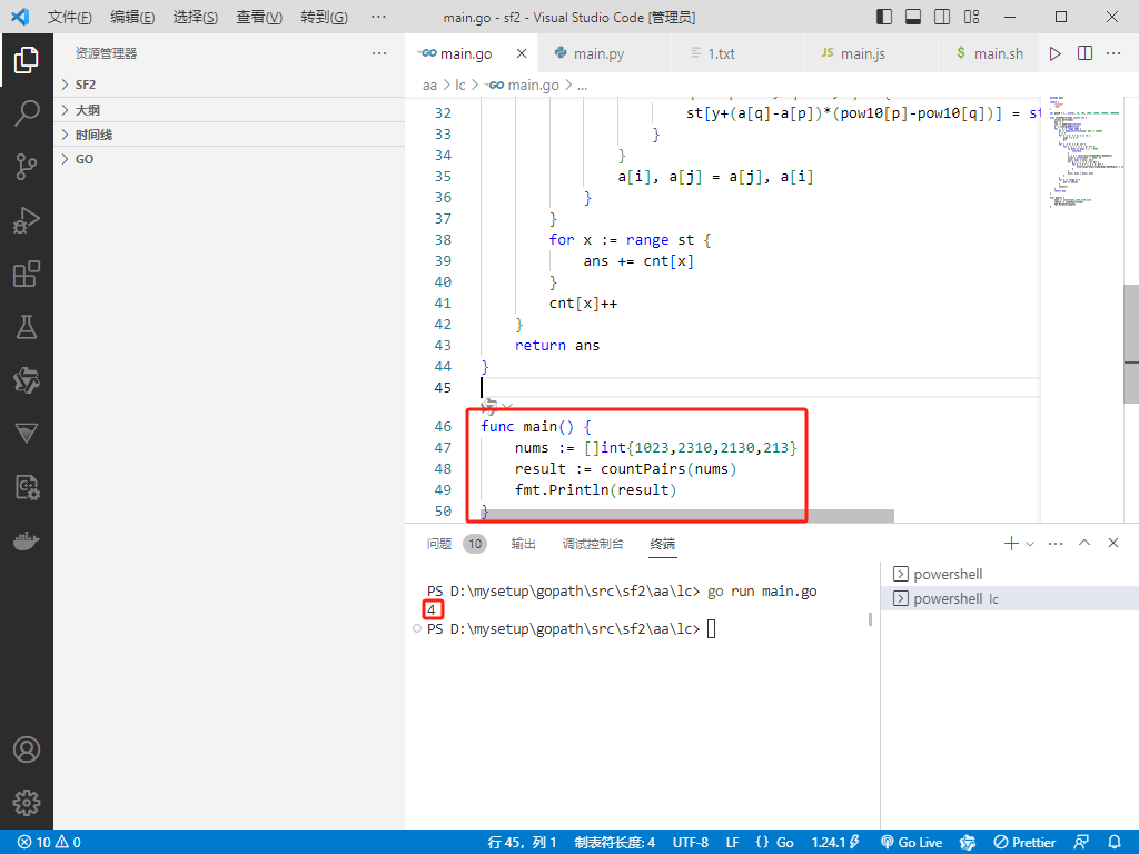

Go完整代码如下:
package main
import (
	"slices"
	"fmt"
var pow10 = [...]int{1, 10, 100, 1000, 10000, 100000, 1000000}
func countPairs(nums []int) int {
	slices.Sort(nums)
	ans := 0
	cnt := make(map[int]int)
	a := [len(pow10)]int{}
	for _, x := range nums {
		st := map[int]struct{}{x: {}} // 不交换
		m := 0
		for v := x; v > 0; v /= 10 {
			a[m] = v % 10
			m++
		for i := 0; i < m; i++ {
			for j := i + 1; j < m; j++ {
				if a[i] == a[j] { // 小优化
					continue
				y := x + (a[j]-a[i])*(pow10[i]-pow10[j])
				st[y] = struct{}{} // 交换一次
				a[i], a[j] = a[j], a[i]
				for p := i + 1; p < m; p++ {
					for q := p + 1; q < m; q++ {
						st[y+(a[q]-a[p])*(pow10[p]-pow10[q])] = struct{}{} // 交换两次
		for x := range st {
			ans += cnt[x]
		cnt[x]++
	return ans
func main() {
	nums := []int{1023,2310,2130,213}
	result := countPairs(nums)
	fmt.Println(result)

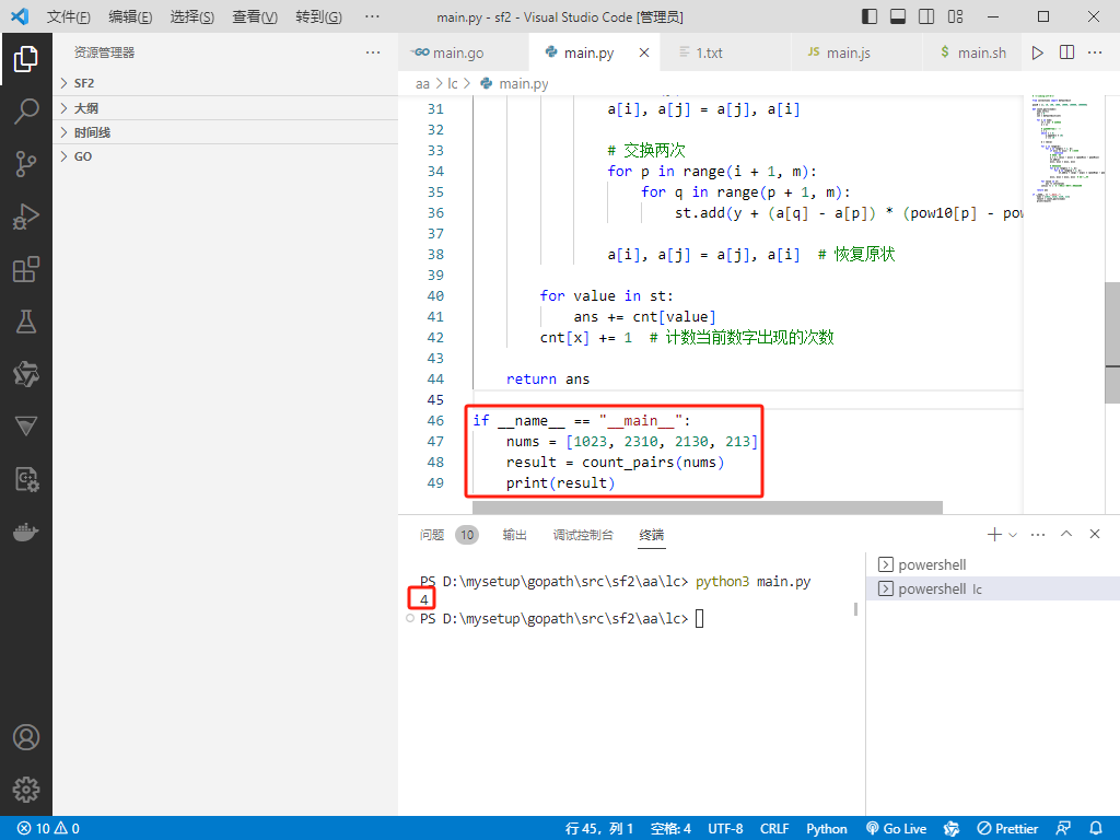

Python完整代码如下:
# -*-coding:utf-8-*-
from collections import defaultdict
pow10 = [1, 10, 100, 1000, 10000, 100000, 1000000]
def count_pairs(nums):
    nums.sort()
    ans = 0
    cnt = defaultdict(int)
    for x in nums:
        st = {x}  # 不交换
        a = []
        # 提取数字的每一位
        v = x
        while v > 0:
            a.append(v % 10)
            v //= 10
        m = len(a)
        for i in range(m):
            for j in range(i + 1, m):
                if a[i] == a[j]:  # 小优化
                    continue
                # 交换一次
                y = x + (a[j] - a[i]) * (pow10[i] - pow10[j])
                st.add(y)
                # 交换两次
                for p in range(i + 1, m):
                    for q in range(p + 1, m):
                        st.add(y + (a[q] - a[p]) * (pow10[p] - pow10[q]))
                a[i], a[j] = a[j], a[i]  # 恢复原状
        for value in st:
            ans += cnt[value]
        cnt[x] += 1  # 计数当前数字出现的次数
    return ans
if __name__ == "__main__":
    nums = [1023, 2310, 2130, 213]
    result = count_pairs(nums)
    print(result)
