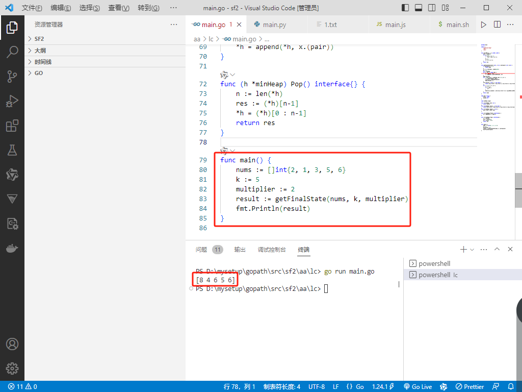

Go完整代码如下:
package main
import (
"container/heap"
"fmt"
"sort"
func quickMul(x, y, m int64) int64 {
res := int64(1)
for y > 0 {
if (y & 1) == 1 {
res = (res * x) % m
y >>= 1
x = (x * x) % m
return res
func getFinalState(nums []int, k int, multiplier int) []int {
if multiplier == 1 {
return nums
n, m := len(nums), int64(1e9+7)
mx := 0
var v minHeap
for i, num := range nums {
mx = max(mx, num)
v = append(v, pair{int64(num), i})
heap.Init(&v)
for ; v[0].first < int64(mx) && k > 0; k-- {
x := heap.Pop(&v).(pair)
x.first *= int64(multiplier)
heap.Push(&v, x)
sort.Slice(v, func(i, j int) bool {
return v[i].first < v[j].first || v[i].first == v[j].first && v[i].second < v[j].second
for i := 0; i < n; i++ {
t := k / n
if i < k%n {
t++
nums[v[i].second] = int((v[i].first % m) * quickMul(int64(multiplier), int64(t), m) % m)
return nums
type pair struct {
first int64
second int
type minHeap []pair
func (h minHeap) Len() int {
return len(h)
func (h minHeap) Less(i, j int) bool {
return h[i].first < h[j].first || h[i].first == h[j].first && h[i].second < h[j].second
func (h minHeap) Swap(i, j int) {
h[i], h[j] = h[j], h[i]
func (h *minHeap) Push(x interface{}) {
*h = append(*h, x.(pair))
func (h *minHeap) Pop() interface{} {
n := len(*h)
res := (*h)[n-1]
*h = (*h)[0 : n-1]
return res
func main() {
nums := []int{2, 1, 3, 5, 6}
k := 5
multiplier := 2
result := getFinalState(nums, k, multiplier)
fmt.Println(result)

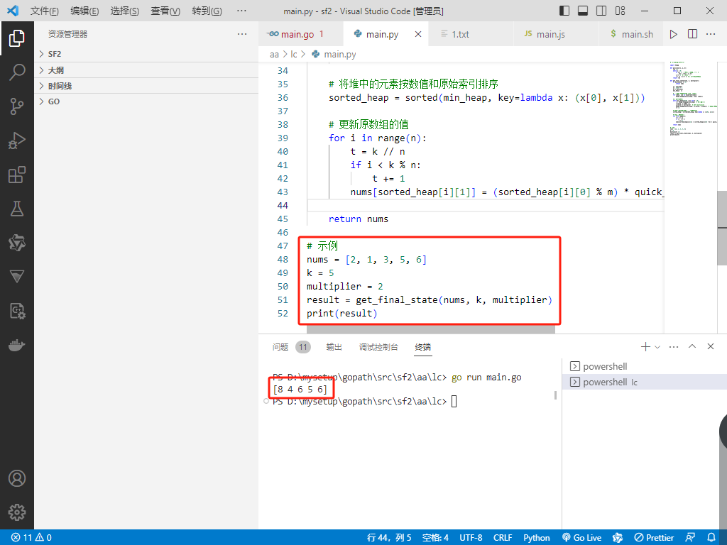

Python完整代码如下:
# -*-coding:utf-8-*-
import heapq
def quick_mul(x, y, m):
res = 1
while y > 0:
if y & 1: # 如果 y 的最低位为 1
res = (res * x) % m
y >>= 1 # y 右移一位
x = (x * x) % m # x 自身平方并取模
return res
def get_final_state(nums, k, multiplier):
if multiplier == 1:
return nums
n = len(nums)
m = 10**9 + 7
mx = max(nums)
min_heap = []
# 使用最小堆存储元组 (num, index)
for index, num in enumerate(nums):
heapq.heappush(min_heap, (num, index))
# k 次替换操作
while min_heap[0][0] < mx and k > 0:
x = heapq.heappop(min_heap) # 取出最小值
x_value, x_index = x
x_value *= multiplier # 乘以 multiplier
heapq.heappush(min_heap, (x_value, x_index)) # 将新值重新入堆
k -= 1
# 将堆中的元素按数值和原始索引排序
sorted_heap = sorted(min_heap, key=lambda x: (x[0], x[1]))
# 更新原数组的值
for i in range(n):
t = k // n
if i < k % n:
t += 1
nums[sorted_heap[i][1]] = (sorted_heap[i][0] % m) * quick_mul(multiplier, t, m) % m
return nums
# 示例
nums = [2, 1, 3, 5, 6]
k = 5
multiplier = 2
result = get_final_state(nums, k, multiplier)
print(result)
