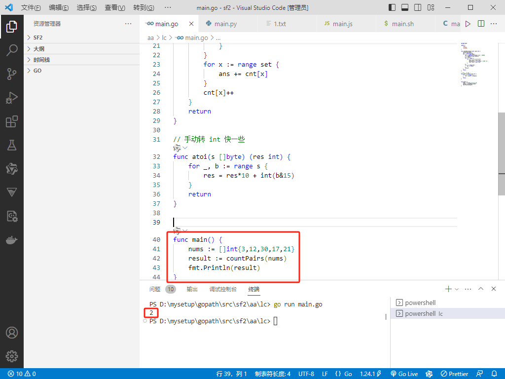

Go完整代码如下:
package main
import (
"fmt"
"slices"
"strconv"
func countPairs(nums []int) (ans int) {
slices.Sort(nums)
cnt := map[int]int{}
for _, x := range nums {
set := map[int]struct{}{x: {}} // 不交换
s := []byte(strconv.Itoa(x))
m := len(s)
for i := range s {
for j := i + 1; j < m; j++ {
s[i], s[j] = s[j], s[i]
set[atoi(s)] = struct{}{} // 交换一次
for x := range set {
ans += cnt[x]
cnt[x]++
return
// 手动转 int 快一些
func atoi(s []byte) (res int) {
for _, b := range s {
res = res*10 + int(b&15)
return
func main() {
nums := []int{3,12,30,17,21}
result := countPairs(nums)
fmt.Println(result)

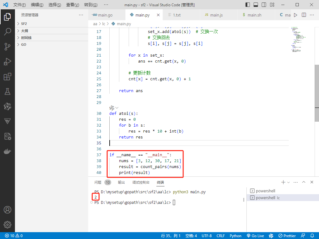

Python完整代码如下:
# -*-coding:utf-8-*-
def count_pairs(nums):
nums.sort()
cnt = {}
ans = 0
for x in nums:
set_x = {x} # 不交换
s = list(str(x))
m = len(s)
for i in range(m):
for j in range(i + 1, m):
# 交换两个数字位
set_x.add(atoi(s)) # 交换一次
# 交换回去
for x in set_x:
ans += cnt.get(x, 0)
# 更新计数
cnt[x] = cnt.get(x, 0) + 1
return ans
def atoi(s):
res = 0
for b in s:
res = res * 10 + int(b)
return res
if __name__ == "__main__":
nums = [3, 12, 30, 17, 21]
result = count_pairs(nums)
print(result)
