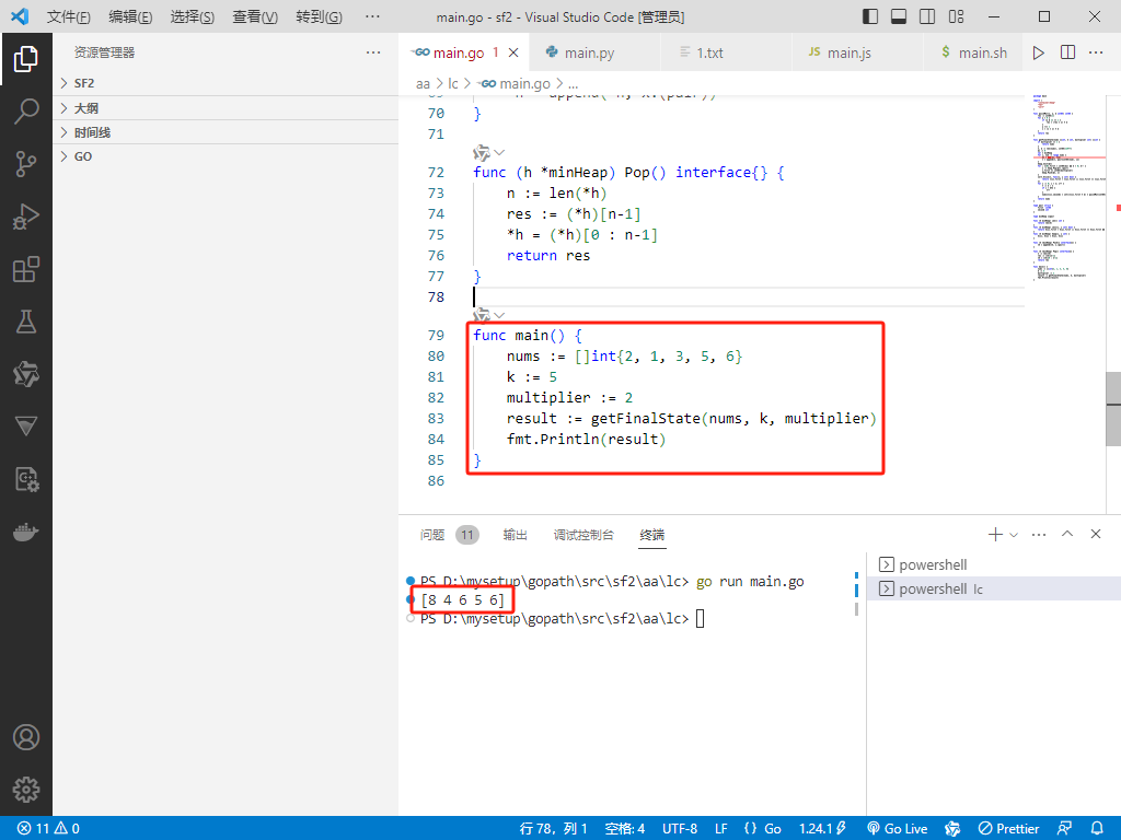

Go完整代码如下:
package main
import (
	"container/heap"
	"fmt"
	"sort"
func quickMul(x, y, m int64) int64 {
	res := int64(1)
	for y > 0 {
		if (y & 1) == 1 {
			res = (res * x) % m
		y >>= 1
		x = (x * x) % m
	return res
func getFinalState(nums []int, k int, multiplier int) []int {
	if multiplier == 1 {
		return nums
	n, m := len(nums), int64(1e9+7)
	mx := 0
	var v minHeap
	for i, num := range nums {
		mx = max(mx, num)
		v = append(v, pair{int64(num), i})
	heap.Init(&v)
	for ; v[0].first < int64(mx) && k > 0; k-- {
		x := heap.Pop(&v).(pair)
		x.first *= int64(multiplier)
		heap.Push(&v, x)
	sort.Slice(v, func(i, j int) bool {
		return v[i].first < v[j].first || v[i].first == v[j].first && v[i].second < v[j].second
	for i := 0; i < n; i++ {
		t := k / n
		if i < k%n {
			t++
		nums[v[i].second] = int((v[i].first % m) * quickMul(int64(multiplier), int64(t), m) % m)
	return nums
type pair struct {
	first  int64
	second int
type minHeap []pair
func (h minHeap) Len() int {
	return len(h)
func (h minHeap) Less(i, j int) bool {
	return h[i].first < h[j].first || h[i].first == h[j].first && h[i].second < h[j].second
func (h minHeap) Swap(i, j int) {
	h[i], h[j] = h[j], h[i]
func (h *minHeap) Push(x interface{}) {
	*h = append(*h, x.(pair))
func (h *minHeap) Pop() interface{} {
	n := len(*h)
	res := (*h)[n-1]
	*h = (*h)[0 : n-1]
	return res
func main() {
	nums := []int{2, 1, 3, 5, 6}
	k := 5
	multiplier := 2
	result := getFinalState(nums, k, multiplier)
	fmt.Println(result)

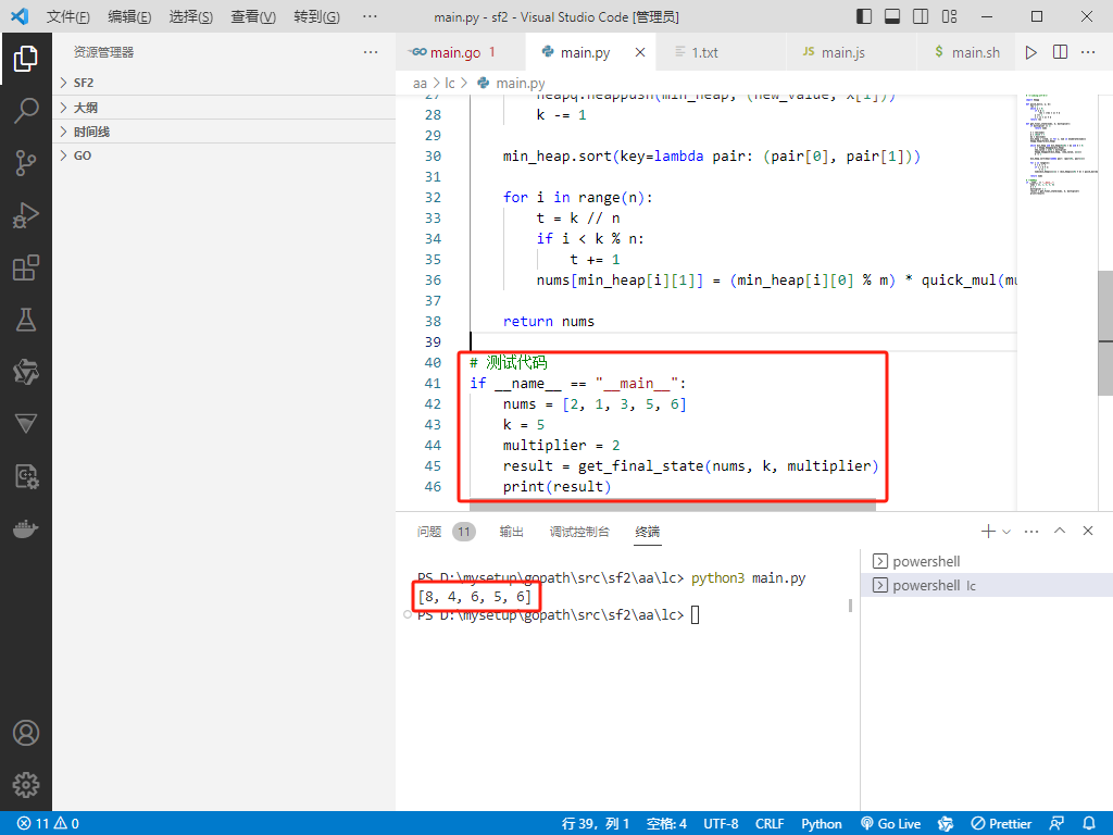

Python完整代码如下:
# -*-coding:utf-8-*-
import heapq
def quick_mul(x, y, m):
    res = 1
    while y > 0:
        if y & 1:
            res = (res * x) % m
        y >>= 1
        x = (x * x) % m
    return res
def get_final_state(nums, k, multiplier):
    if multiplier == 1:
        return nums
    n = len(nums)
    m = 10**9 + 7
    mx = max(nums)
    min_heap = [(num, i) for i, num in enumerate(nums)]
    heapq.heapify(min_heap)
    while min_heap and min_heap[0][0] < mx and k > 0:
        x = heapq.heappop(min_heap)
        new_value = x[0] * multiplier
        heapq.heappush(min_heap, (new_value, x[1]))
        k -= 1
    min_heap.sort(key=lambda pair: (pair[0], pair[1]))
    for i in range(n):
        t = k // n
        if i < k % n:
            t += 1
        nums[min_heap[i][1]] = (min_heap[i][0] % m) * quick_mul(multiplier, t, m) % m
    return nums
# 测试代码
if __name__ == "__main__":
    nums = [2, 1, 3, 5, 6]
    k = 5
    multiplier = 2
    result = get_final_state(nums, k, multiplier)
    print(result)
