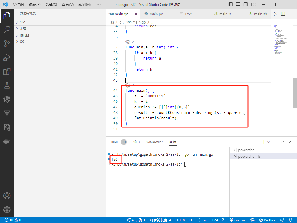

func main() {
s := "0001111"
k := 2
queries := [][]int{{0,6}}
result := countKConstraintSubstrings(s, k,queries)
fmt.Println(result)

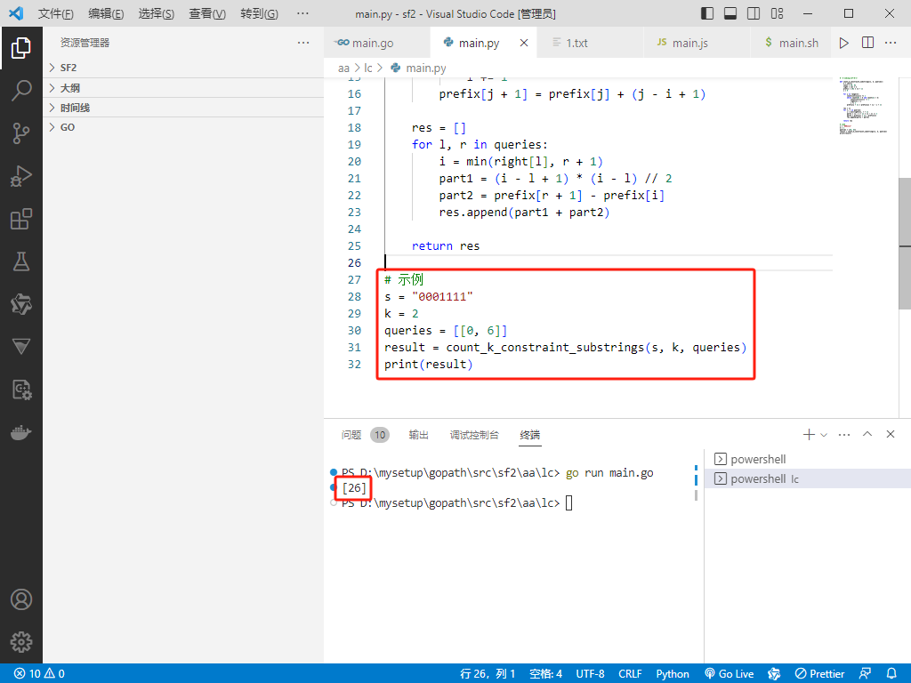

Python完整代码如下:
# -*-coding:utf-8-*-
def count_k_constraint_substrings(s, k, queries):
n = len(s)
count = [0, 0]
right = [n] * n
prefix = [0] * (n + 1)
i = 0
for j in range(n):
count[int(s[j])] += 1
while count[0] > k and count[1] > k:
count[int(s[i])] -= 1
right[i] = j
i += 1
prefix[j + 1] = prefix[j] + (j - i + 1)
res = []
for l, r in queries:
i = min(right[l], r + 1)
part1 = (i - l + 1) * (i - l) // 2
part2 = prefix[r + 1] - prefix[i]
res.append(part1 + part2)
return res
# 示例
s = "0001111"
k = 2
queries = [[0, 6]]
result = count_k_constraint_substrings(s, k, queries)
print(result)
