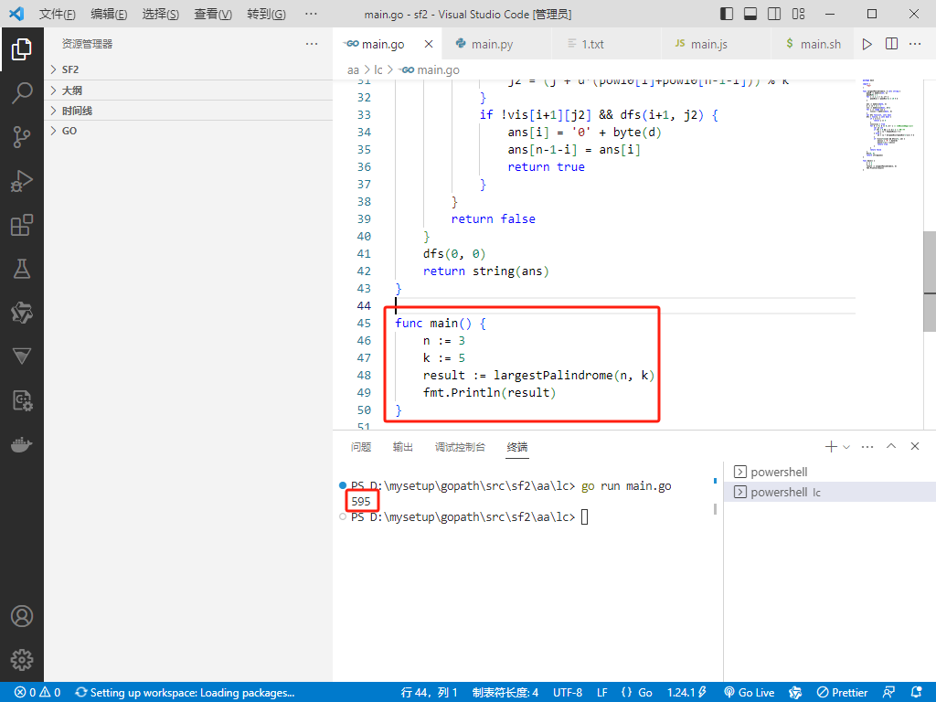

Go完整代码如下:
package main
import (
	"fmt"
func largestPalindrome(n, k int) string {
	pow10 := make([]int, n)
	pow10[0] = 1
	for i := 1; i < n; i++ {
		pow10[i] = pow10[i-1] * 10 % k
	ans := make([]byte, n)
	m := (n + 1) / 2
	vis := make([][]bool, m+1)
	for i := range vis {
		vis[i] = make([]bool, k)
	var dfs func(int, int) bool
	dfs = func(i, j int) bool {
		if i == m {
			return j == 0
		vis[i][j] = true
		for d := 9; d >= 0; d-- { // 贪心:从大到小枚举
			var j2 int
			if n%2 > 0 && i == m-1 { // 正中间
				j2 = (j + d*pow10[i]) % k
			} else {
				j2 = (j + d*(pow10[i]+pow10[n-1-i])) % k
			if !vis[i+1][j2] && dfs(i+1, j2) {
				ans[i] = '0' + byte(d)
				ans[n-1-i] = ans[i]
				return true
		return false
	dfs(0, 0)
	return string(ans)
func main() {
	n := 3
	k := 5
	result := largestPalindrome(n, k)
	fmt.Println(result)

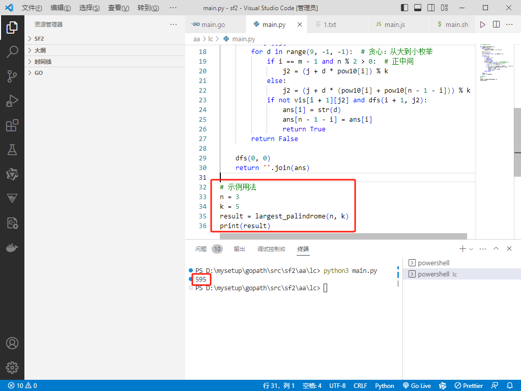

Python3完整代码如下:
# -*-coding:utf-8-*-
def largest_palindrome(n, k):
    pow10 = [1] * n
    for i in range(1, n):
        pow10[i] = (pow10[i - 1] * 10) % k
    ans = ['0'] * n
    m = (n + 1) // 2
    vis = [[False] * k for _ in range(m + 1)]
    def dfs(i, j):
        if i == m:
            return j == 0
        if vis[i][j]:
            return False
        vis[i][j] = True
        for d in range(9, -1, -1):  # 贪心:从大到小枚举
            if i == m - 1 and n % 2 > 0:  # 正中间
                j2 = (j + d * pow10[i]) % k
            else:
                j2 = (j + d * (pow10[i] + pow10[n - 1 - i])) % k
            if not vis[i + 1][j2] and dfs(i + 1, j2):
                ans[i] = str(d)
                ans[n - 1 - i] = ans[i]
                return True
        return False
    dfs(0, 0)
    return ''.join(ans)
# 示例用法
n = 3
k = 5
result = largest_palindrome(n, k)
print(result)
