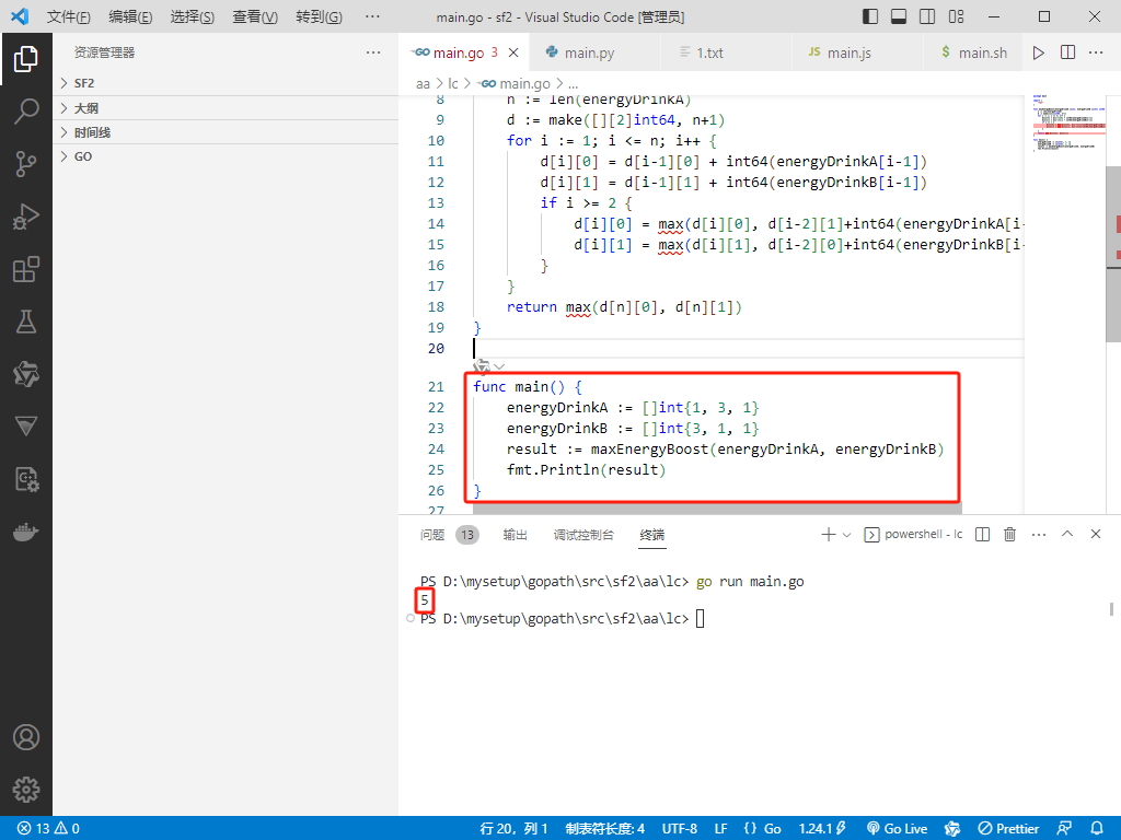

Go完整代码如下:
package main
import (
"fmt"
func maxEnergyBoost(energyDrinkA []int, energyDrinkB []int) int64 {
n := len(energyDrinkA)
d := make([][2]int64, n+1)
for i := 1; i <= n; i++ {
d[i][0] = d[i-1][0] + int64(energyDrinkA[i-1])
d[i][1] = d[i-1][1] + int64(energyDrinkB[i-1])
if i >= 2 {
d[i][0] = max(d[i][0], d[i-2][1]+int64(energyDrinkA[i-1]))
d[i][1] = max(d[i][1], d[i-2][0]+int64(energyDrinkB[i-1]))
return max(d[n][0], d[n][1])
func main() {
energyDrinkA := []int{1, 3, 1}
energyDrinkB := []int{3, 1, 1}
result := maxEnergyBoost(energyDrinkA, energyDrinkB)
fmt.Println(result)

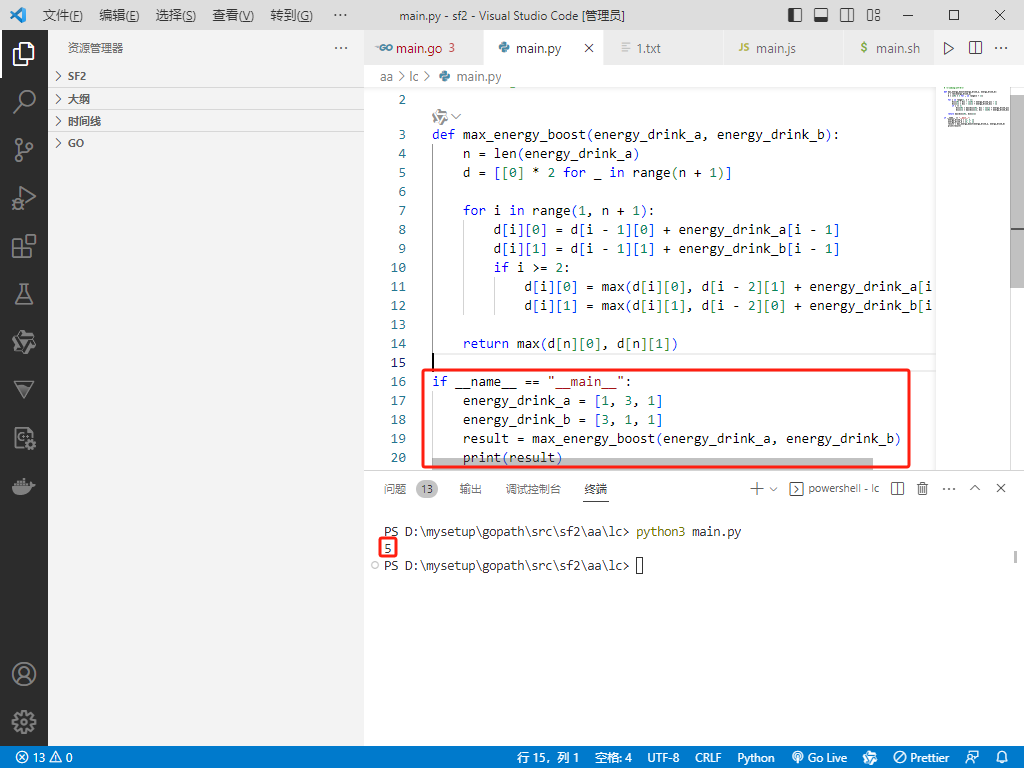

Python完整代码如下:
# -*-coding:utf-8-*-
def max_energy_boost(energy_drink_a, energy_drink_b):
n = len(energy_drink_a)
d = [[0] * 2 for _ in range(n + 1)]
for i in range(1, n + 1):
d[i][0] = d[i - 1][0] + energy_drink_a[i - 1]
d[i][1] = d[i - 1][1] + energy_drink_b[i - 1]
if i >= 2:
d[i][0] = max(d[i][0], d[i - 2][1] + energy_drink_a[i - 1])
d[i][1] = max(d[i][1], d[i - 2][0] + energy_drink_b[i - 1])
if __name__ == "__main__":
energy_drink_a = [1, 3, 1]
energy_drink_b = [3, 1, 1]
result = max_energy_boost(energy_drink_a, energy_drink_b)
print(result)
