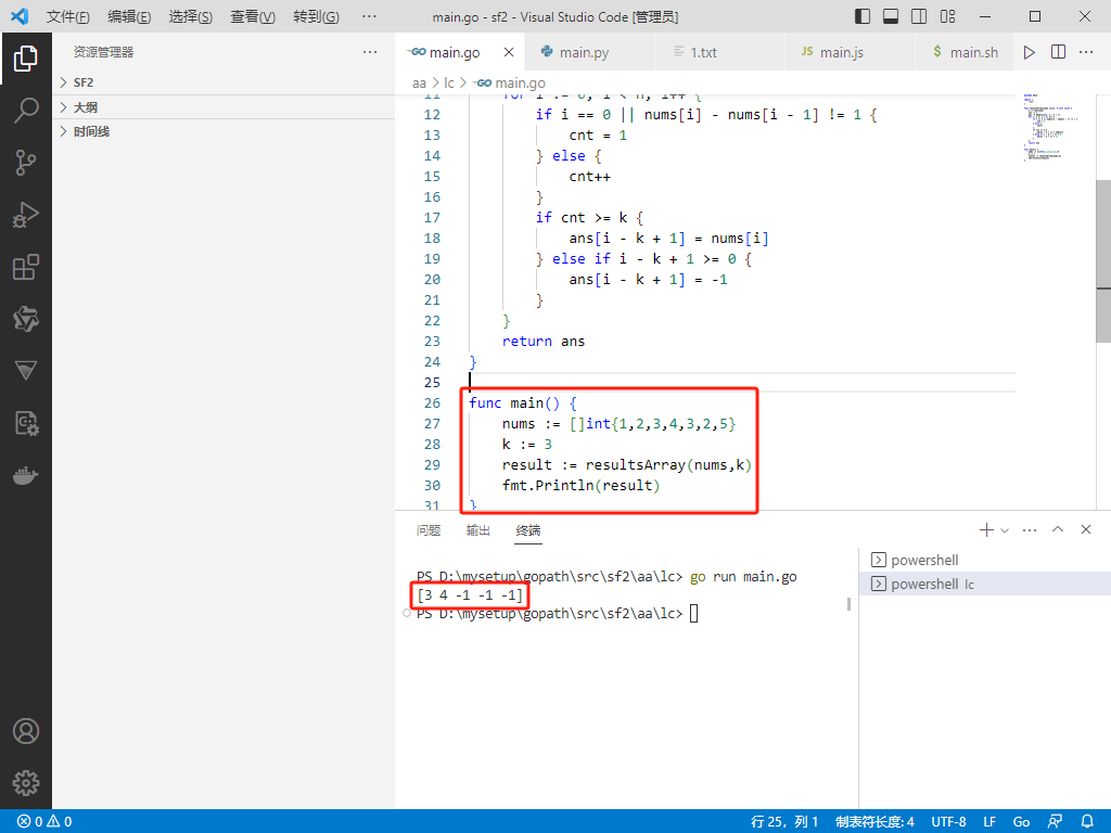

Go完整代码如下:
package main
import (
	"fmt"
func resultsArray(nums []int, k int) []int {
    n := len(nums)
    cnt := 0
    ans := make([]int, n - k + 1)
    for i := 0; i < n; i++ {
        if i == 0 || nums[i] - nums[i - 1] != 1 {
            cnt = 1
        } else {
            cnt++
        if cnt >= k {
            ans[i - k + 1] = nums[i]
        } else if i - k + 1 >= 0 {
            ans[i - k + 1] = -1
    return ans
func main() {
	nums := []int{1,2,3,4,3,2,5}
	k := 3
	result := resultsArray(nums,k)
	fmt.Println(result)

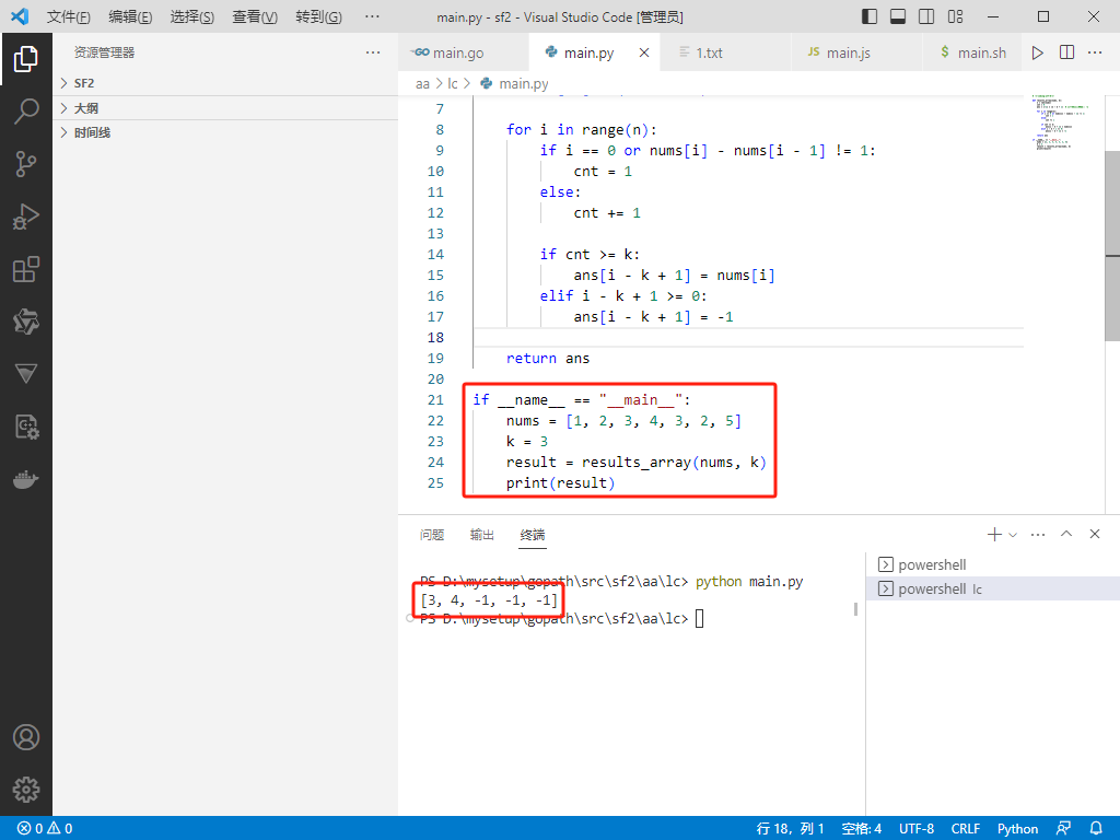

Python完整代码如下:
# -*-coding:utf-8-*-
def results_array(nums, k):
    n = len(nums)
    cnt = 0
    ans = [-1] * (n - k + 1)  # 初始化结果数组为 -1
    for i in range(n):
        if i == 0 or nums[i] - nums[i - 1] != 1:
            cnt = 1
        else:
            cnt += 1
        if cnt >= k:
        elif i - k + 1 >= 0:
            ans[i - k + 1] = -1
    return ans
if __name__ == "__main__":
    nums = [1, 2, 3, 4, 3, 2, 5]
    k = 3
    result = results_array(nums, k)
    print(result)
