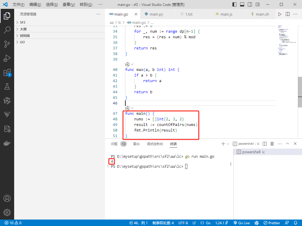

Go完整代码如下:
package main
import (
	"fmt"
func countOfPairs(nums []int) int {
	n := len(nums)
	m := 0
	for _, num := range nums {
		if num > m {
			m = num
	mod := int(1e9 + 7)
	dp := make([][]int, n)
	for i := range dp {
		dp[i] = make([]int, m+1)
	for a := 0; a <= nums[0]; a++ {
		dp[0][a] = 1
	for i := 1; i < n; i++ {
		d := max(0, nums[i]-nums[i-1])
		for j := d; j <= nums[i]; j++ {
			if j == 0 {
				dp[i][j] = dp[i-1][j-d]
			} else {
				dp[i][j] = (dp[i][j-1] + dp[i-1][j-d]) % mod
	res := 0
	for _, num := range dp[n-1] {
		res = (res + num) % mod
	return res
func max(a, b int) int {
	if a > b {
		return a
	return b
func main() {
	nums := []int{2, 3, 2}
	result := countOfPairs(nums)
	fmt.Println(result)

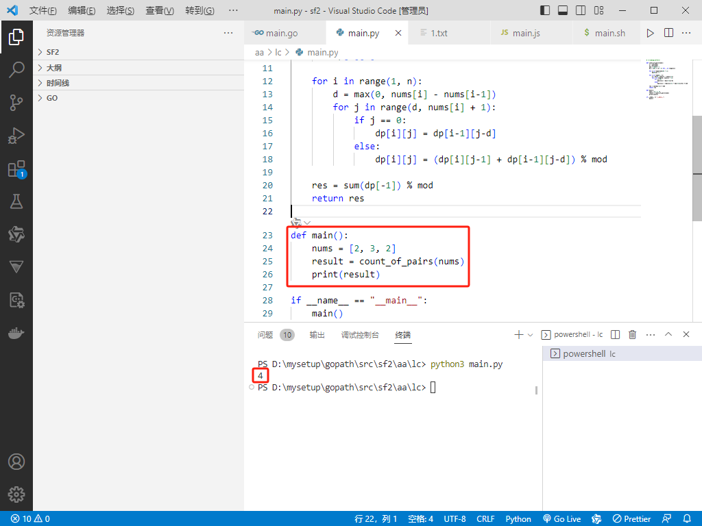

Python完整代码如下:
# -*-coding:utf-8-*-
def count_of_pairs(nums):
    n = len(nums)
    m = max(nums)
    mod = 10**9 + 7
    dp = [[0] * (m + 1) for _ in range(n)]
    for a in range(nums[0] + 1):
        dp[0][a] = 1
    for i in range(1, n):
        d = max(0, nums[i] - nums[i-1])
        for j in range(d, nums[i] + 1):
            if j == 0:
            else:
    res = sum(dp[-1]) % mod
    return res
def main():
    nums = [2, 3, 2]
    result = count_of_pairs(nums)
    print(result)
if __name__ == "__main__":
    main()
