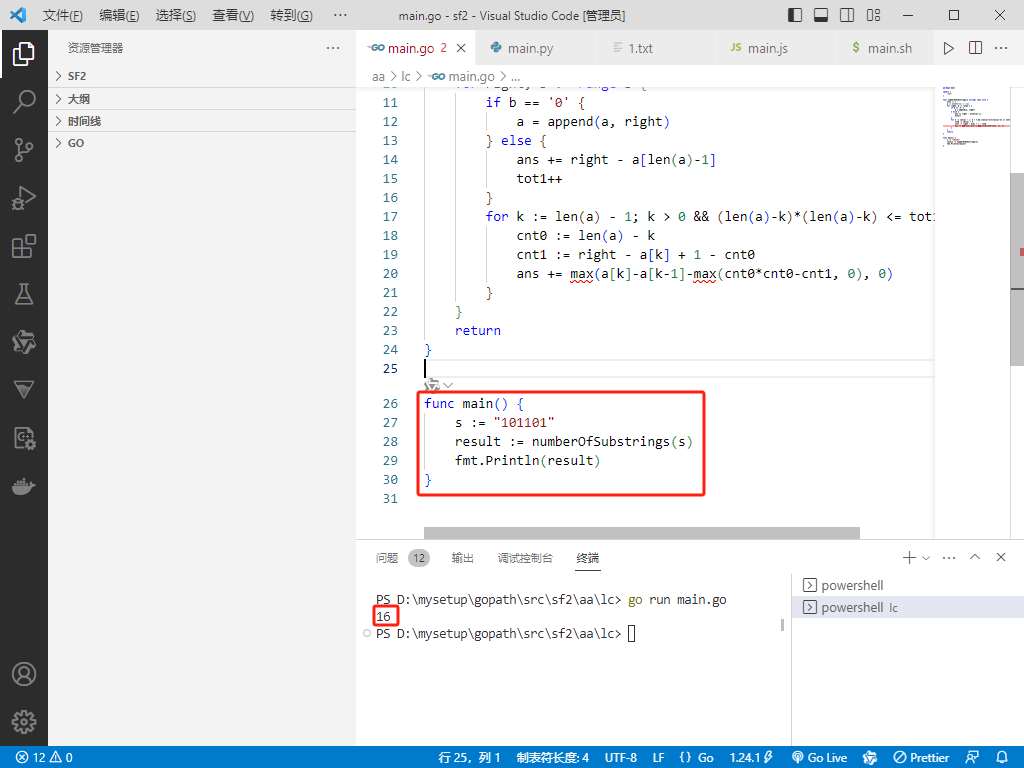

Go完整代码如下:
package main
import (
"fmt"
func numberOfSubstrings(s string) (ans int) {
tot1 := 0
a := []int{-1} // 哨兵
for right, b := range s {
if b == '0' {
a = append(a, right)
} else {
ans += right - a[len(a)-1]
tot1++
for k := len(a) - 1; k > 0 && (len(a)-k)*(len(a)-k) <= tot1; k-- {
cnt0 := len(a) - k
cnt1 := right - a[k] + 1 - cnt0
ans += max(a[k]-a[k-1]-max(cnt0*cnt0-cnt1, 0), 0)
return
func main() {

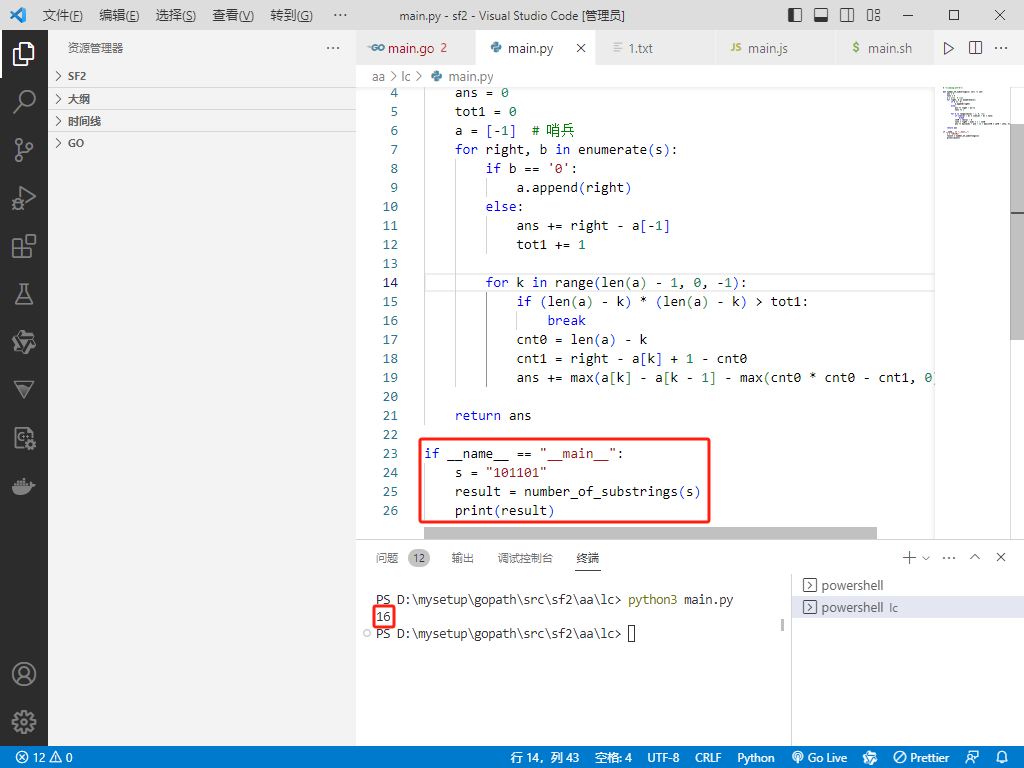

s := "101101"
result := numberOfSubstrings(s)
fmt.Println(result)
Python完整代码如下:
# -*-coding:utf-8-*-
def number_of_substrings(s: str) -> int:
ans = 0
tot1 = 0
a = [-1] # 哨兵
for right, b in enumerate(s):
if b == '0':
a.append(right)
else:
ans += right - a[-1]
tot1 += 1
for k in range(len(a) - 1, 0, -1):
if (len(a) - k) * (len(a) - k) > tot1:
break
cnt0 = len(a) - k
cnt1 = right - a[k] + 1 - cnt0
ans += max(a[k] - a[k - 1] - max(cnt0 * cnt0 - cnt1, 0), 0)
return ans
if __name__ == "__main__":
s = "101101"
result = number_of_substrings(s)
print(result)
