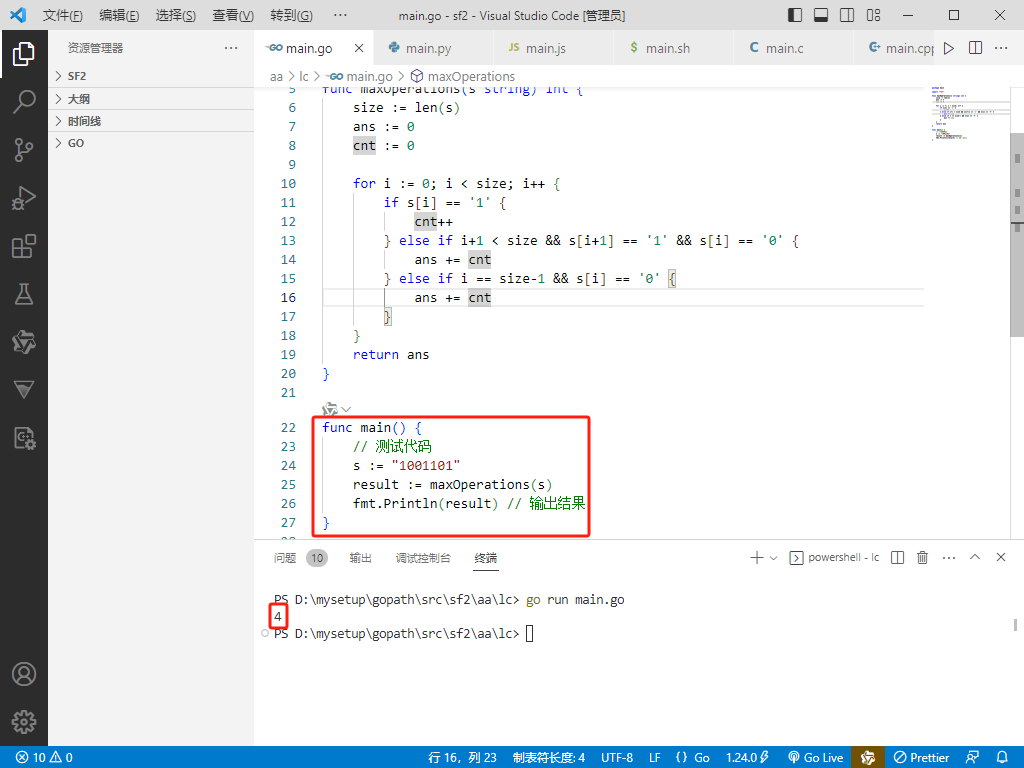

Go完整代码如下:
package main
import "fmt"
func maxOperations(s string) int {
	ans := 0
	cnt := 0
	for i := 0; i < size; i++ {
		if s[i] == '1' {
			cnt++
		} else if i+1 < size && s[i+1] == '1' && s[i] == '0' {
			ans += cnt
		} else if i == size-1 && s[i] == '0' {
			ans += cnt
	return ans
func main() {
	// 测试代码
	s := "1001101"
	result := maxOperations(s)
	fmt.Println(result) // 输出结果

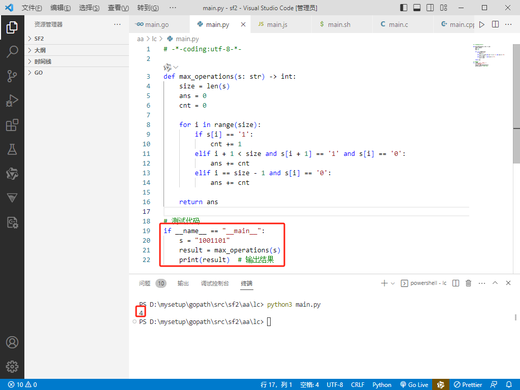

Python完整代码如下:
# -*-coding:utf-8-*-
def max_operations(s: str) -> int:
    size = len(s)
    ans = 0
    cnt = 0
    for i in range(size):
        if s[i] == '1':
            cnt += 1
        elif i + 1 < size and s[i + 1] == '1' and s[i] == '0':
            ans += cnt
        elif i == size - 1 and s[i] == '0':
            ans += cnt
    return ans
# 测试代码
if __name__ == "__main__":
    s = "1001101"
    result = max_operations(s)
    print(result)  # 输出结果
