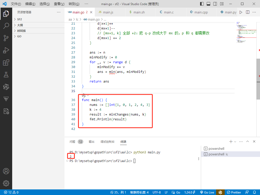

func main() {
	nums := []int{1, 0, 1, 2, 4, 3}
	k := 4
	result := minChanges(nums, k)
	fmt.Println(result)
