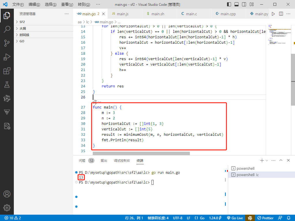

Go完整代码如下:
package main
import (
	"fmt"
	"sort"
func minimumCost(m int, n int, horizontalCut []int, verticalCut []int) int64 {
	sort.Ints(horizontalCut)
	sort.Ints(verticalCut)
	h, v := 1, 1
	var res int64
	for len(horizontalCut) > 0 || len(verticalCut) > 0 {
		if len(verticalCut) == 0 || len(horizontalCut) > 0 && horizontalCut[len(horizontalCut)-1] > verticalCut[len(verticalCut)-1] {
			res += int64(horizontalCut[len(horizontalCut)-1] * h)
			horizontalCut = horizontalCut[:len(horizontalCut)-1]
			v++
		} else {
			res += int64(verticalCut[len(verticalCut)-1] * v)
			verticalCut = verticalCut[:len(verticalCut)-1]
			h++
	return res
func main() {
	m := 3
	n := 2
	horizontalCut := []int{1, 3}
	verticalCut := []int{5}
	result := minimumCost(m, n, horizontalCut, verticalCut)
	fmt.Println(result)

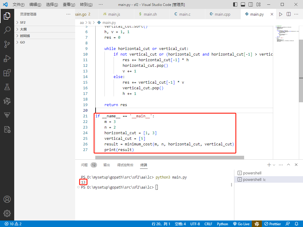

Python完整代码如下:
# -*-coding:utf-8-*-
def minimum_cost(m, n, horizontal_cut, vertical_cut):
    horizontal_cut.sort()
    vertical_cut.sort()
    h, v = 1, 1
    res = 0
    while horizontal_cut or vertical_cut:
        if not vertical_cut or (horizontal_cut and horizontal_cut[-1] > vertical_cut[-1]):
            res += horizontal_cut[-1] * h
            horizontal_cut.pop()
            v += 1
        else:
            res += vertical_cut[-1] * v
            vertical_cut.pop()
            h += 1
    return res
if __name__ == '__main__':
    m = 3
    n = 2
    horizontal_cut = [1, 3]
    vertical_cut = [5]
    result = minimum_cost(m, n, horizontal_cut, vertical_cut)
    print(result)
