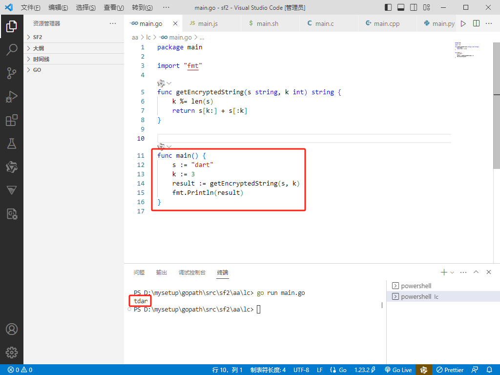

Go完整代码如下:
package main
import "fmt"
func getEncryptedString(s string, k int) string {
k %= len(s)
return s[k:] + s[:k]
func main() {
s := "dart"
k := 3
result := getEncryptedString(s, k)
fmt.Println(result)

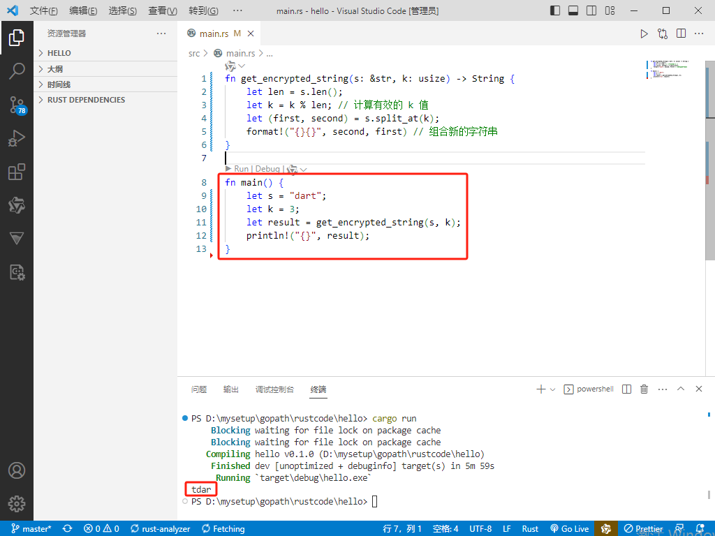

Rust完整代码如下:
fn get_encrypted_string(s: &str, k: usize) -> String {
let len = s.len();
let k = k % len; // 计算有效的 k 值
let (first, second) = s.split_at(k);
format!("{}{}", second, first) // 组合新的字符串
fn main() {
let s = "dart";
let k = 3;
let result = get_encrypted_string(s, k);
println!("{}", result);

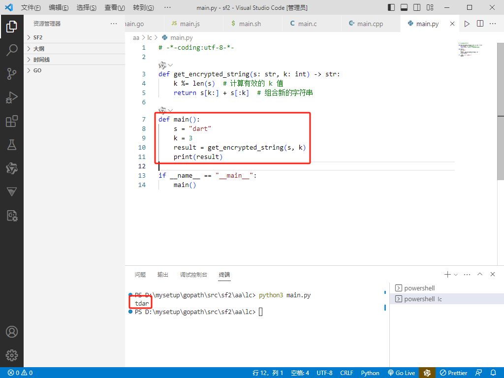

Python完整代码如下:
# -*-coding:utf-8-*-
def get_encrypted_string(s: str, k: int) -> str:
k %= len(s) # 计算有效的 k 值
return s[k:] + s[:k] # 组合新的字符串
def main():
s = "dart"
k = 3
print(result)
if __name__ == "__main__":
main()
