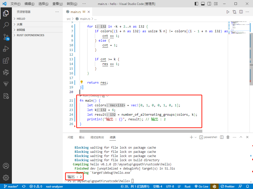

Rust完整代码如下:
fn number_of_alternating_groups(colors: Vec<i32>, k: i32) -> i32 {
let n = colors.len();
let mut res = 0;
let mut cnt = 1;
for i in -k + 2..n as i32 {
if colors[(i + n as i32) as usize % n] != colors[(i - 1 + n as i32) as usize % n] {
cnt += 1;
} else {
cnt = 1;
if cnt >= k {
res += 1;
return res;
fn main() {
let colors = vec![0, 1, 0, 0, 1, 0, 1];
let k = 6;
let result = number_of_alternating_groups(colors, k);
println!("输出 : {}", result); // 输出 : 2

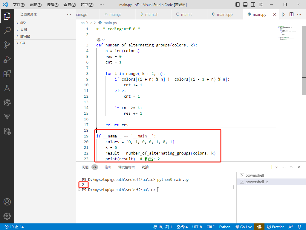

# -*-coding:utf-8-*-
def number_of_alternating_groups(colors, k):
n = len(colors)
res = 0
cnt = 1
for i in range(-k + 2, n):
if colors[(i + n) % n] != colors[(i - 1 + n) % n]:
cnt += 1
else:
cnt = 1
if cnt >= k:
res += 1
return res
if __name__ == '__main__':
colors = [0, 1, 0, 0, 1, 0, 1]
k = 6
print(result) # 输出: 2
