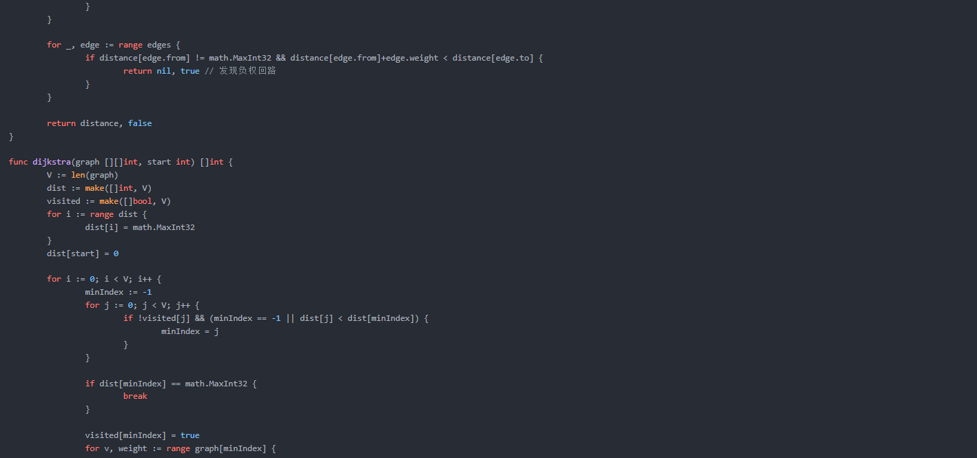

for _, edge := range edges {
if distance[edge.from] != math.MaxInt32 && distance[edge.from]+edge.weight < distance[edge.to] {
return nil, true // 发现负权回路
return distance, false
func dijkstra(graph [][]int, start int) []int {
V := len(graph)
dist := make([]int, V)
visited := make([]bool, V)
for i := range dist {
dist[i] = math.MaxInt32
dist[start] = 0
for i := 0; i < V; i++ {
minIndex := -1
for j := 0; j < V; j++ {
if !visited[j] && (minIndex == -1 || dist[j] < dist[minIndex]) {
minIndex = j
if dist[minIndex] == math.MaxInt32 {
break
visited[minIndex] = true
for v, weight := range graph[minIndex] {
if weight != math.MaxInt32 && dist[minIndex]+weight < dist[v] {
dist[v] = dist[minIndex] + weight
return dist

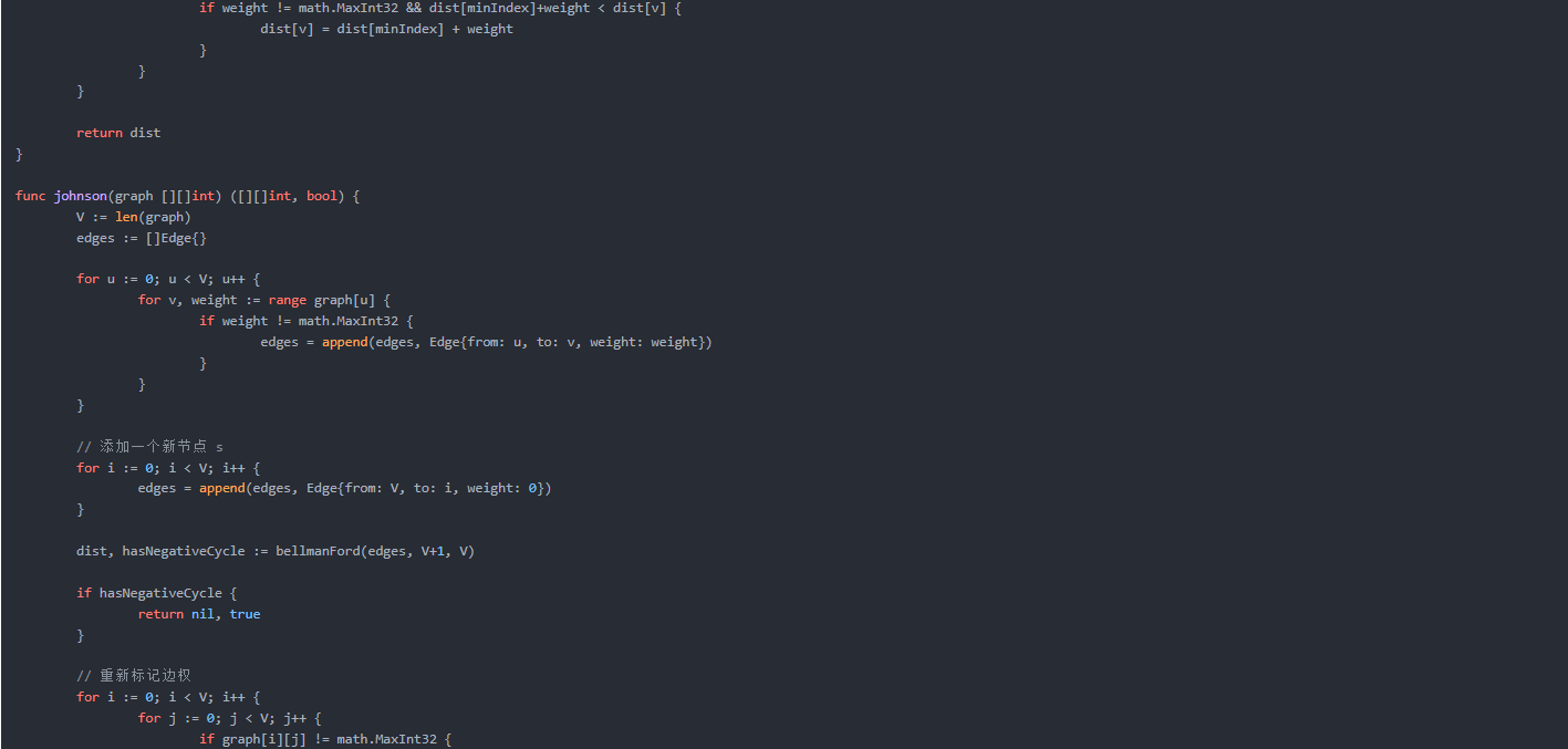

func johnson(graph [][]int) ([][]int, bool) {
V := len(graph)
edges := []Edge{}
for u := 0; u < V; u++ {
for v, weight := range graph[u] {
if weight != math.MaxInt32 {
edges = append(edges, Edge{from: u, to: v, weight: weight})
// 添加一个新节点 s
edges = append(edges, Edge{from: V, to: i, weight: 0})
dist, hasNegativeCycle := bellmanFord(edges, V+1, V)
if hasNegativeCycle {
return nil, true
// 重新标记边权
if graph[i][j] != math.MaxInt32 {
graph[i][j] += dist[i] - dist[j]
// 最终结果
result := make([][]int, V)
for i := range result {
result[i] = dijkstra(graph, i)
return result, false

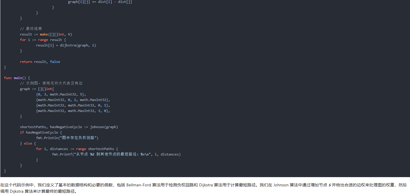

func main() {
// 示例图,使用无穷大代表没有边
graph := [][]int{
{0, 3, math.MaxInt32, 5},
{math.MaxInt32, 0, 2, math.MaxInt32},
{math.MaxInt32, math.MaxInt32, 0, 1},
{math.MaxInt32, math.MaxInt32, 3, 0},
shortestPaths, hasNegativeCycle := johnson(graph)
fmt.Println("图中存在负权回路")
} else {
for i, distances := range shortestPaths {
fmt.Printf("从节点 %d 到其他节点的最短路径: %v\n", i, distances)
在这个代码示例中,我们定义了基本的数据结构和必要的函数,包括 Bellman-Ford 算法用于检测负权回路和 Dijkstra 算法用于计算最短路径。我们在 Johnson 算法中通过增加节点 ( s ) 并给出合适的边权来处理图的权重,然后调用 Dijkstra 算法来计算最终的最短路径。

g.addEdge(source, i, 0)
// 使用 Bellman - Ford 算法计算 h 值
h, ok := g.bellmanFord(source)
if!ok {
return nil, false // 存在负权环
// 重新赋权
for u := 0; u < g.vertices; u++ {
for j, edge := range g.edges[u] {
g.edges[u][j].weight += h[u] - h[edge.to]
// 使用 Dijkstra 算法计算所有节点对之间的最短路径
dist := make([][]int, g.vertices)
dist[u] = g.dijkstra(u, h)
return dist, true
// Item 用于优先队列
type Item struct {
value int
priority int
index int
// PriorityQueue 实现优先队列
type PriorityQueue []*Item
func (pq PriorityQueue) Len() int { return len(pq) }
func (pq PriorityQueue) Less(i, j int) bool {
return pq[i].priority < pq[j].priority
func (pq PriorityQueue) Swap(i, j int) {
pq[i], pq[j] = pq[j], pq[i]
pq[i].index = i
pq[j].index = j
func (pq *PriorityQueue) Push(x interface{}) {
n := len(*pq)
item := x.(*Item)
item.index = n
*pq = append(*pq, item)
func (pq *PriorityQueue) Pop() interface{} {
old := *pq
n := len(old)
item := old[n-1]
old[n-1] = nil // 避免内存泄漏
item.index = -1 // 表示已移除
*pq = old[0 : n-1]
return item
func main() {
// 创建一个图
g := newGraph(4)
g.addEdge(0, 1, -5)
g.addEdge(0, 2, 2)
g.addEdge(1, 2, 3)
g.addEdge(2, 3, 1)
// 运行 Johnson 算法
dist, ok := g.johnson()
if!ok {
fmt.Println("图中存在负权环")
} else {
for i := 0; i < g.vertices; i++ {
fmt.Printf("从节点 %d 到其他节点的最短路径: %v\n", i, dist[i])
代码解释
- Graph 结构体:表示图,包含顶点数和边的信息。
- bellmanFord 函数:实现 Bellman - Ford 算法,用于检测负权环并计算势函数 。
- dijkstra 函数:实现 Dijkstra 算法,用于计算从一个源点到其他所有节点的最短路径。
- johnson 函数:实现 Johnson 算法,包括添加新节点 、使用 Bellman - Ford 算法计算势函数、重新赋权和使用 Dijkstra 算法计算所有节点对之间的最短路径。
- PriorityQueue 结构体:实现优先队列,用于 Dijkstra 算法中的节点排序。
通过上述代码,我们可以计算出带有负权边但无负权环的图中所有节点对之间的最短路径。
