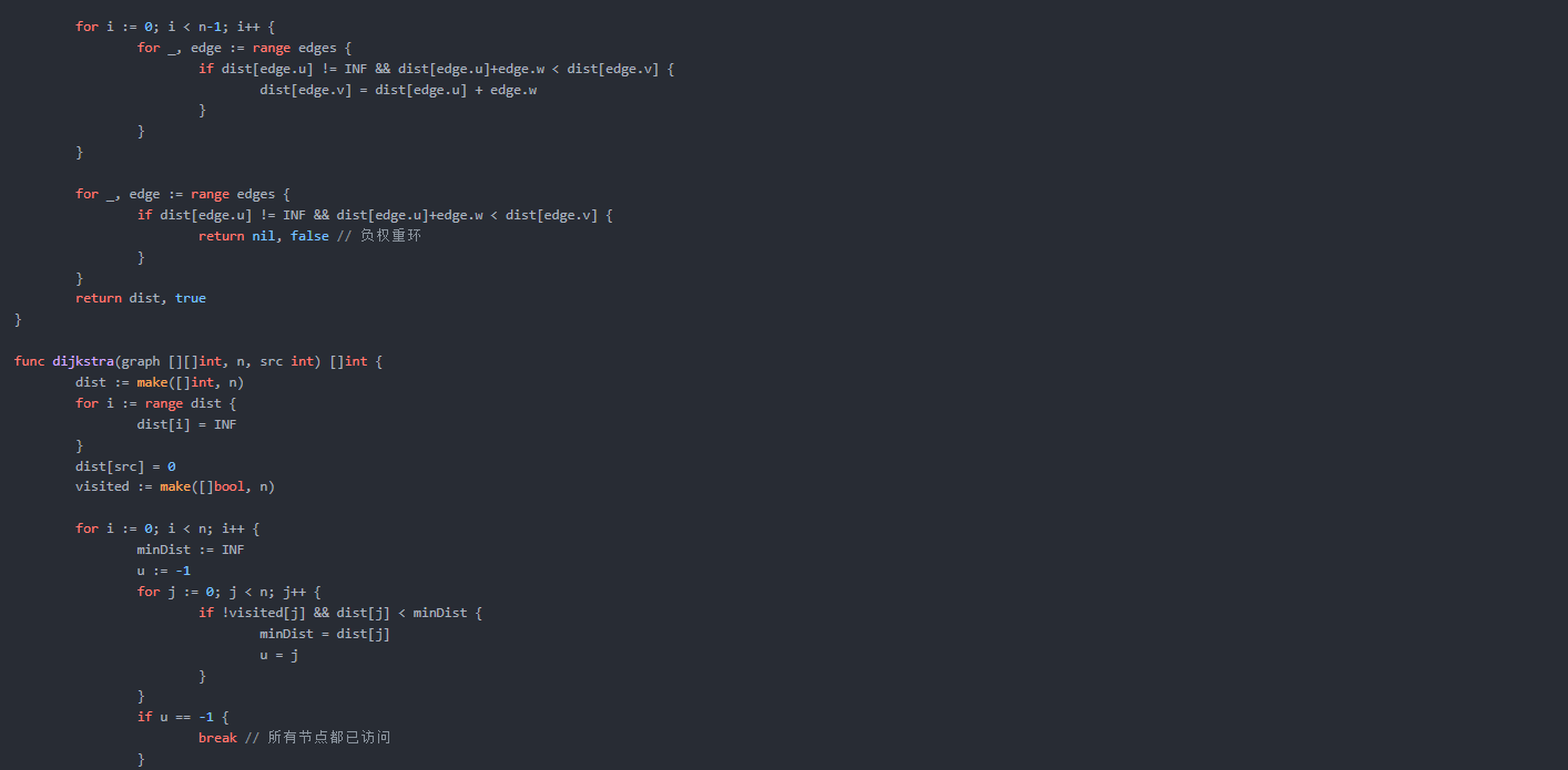

func bellmanFord(edges []Edge, n, src int) ([]int, bool) {
	dist := make([]int, n)
	for i := range dist {
		dist[i] = INF
	dist[src] = 0
	for i := 0; i < n-1; i++ {
		for _, edge := range edges {
			if dist[edge.u] != INF && dist[edge.u]+edge.w < dist[edge.v] {
				dist[edge.v] = dist[edge.u] + edge.w
			return nil, false // 负权重环
	return dist, true
func dijkstra(graph [][]int, n, src int) []int {
		dist[i] = INF
	dist[src] = 0
	visited := make([]bool, n)
	for i := 0; i < n; i++ {
		minDist := INF
		u := -1
		for j := 0; j < n; j++ {
			if !visited[j] && dist[j] < minDist {
				minDist = dist[j]
				u = j
		if u == -1 {
			break // 所有节点都已访问
		visited[u] = true

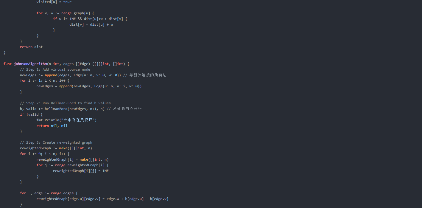

		for v, w := range graph[u] {
			if w != INF && dist[u]+w < dist[v] {
				dist[v] = dist[u] + w
	return dist
func johnsonAlgorithm(n int, edges []Edge) ([][]int, []int) {
	// Step 1: Add virtual source node
	newEdges := append(edges, Edge{u: n, v: 0, w: 0}) // 与新源连接的所有边
	for i := 1; i < n; i++ {
		newEdges = append(newEdges, Edge{u: n, v: i, w: 0})
	// Step 2: Run Bellman-Ford to find h values
	h, valid := bellmanFord(newEdges, n+1, n) // 从新源节点开始
	if !valid {
		fmt.Println("图中存在负权环")
		return nil, nil
	// Step 3: Create re-weighted graph
	reweightedGraph := make([][]int, n)
		reweightedGraph[i] = make([]int, n)
		for j := range reweightedGraph[i] {
			reweightedGraph[i][j] = INF
		reweightedGraph[edge.u][edge.v] = edge.w + h[edge.u] - h[edge.v]
	// Step 4: Run Dijkstra for each vertex

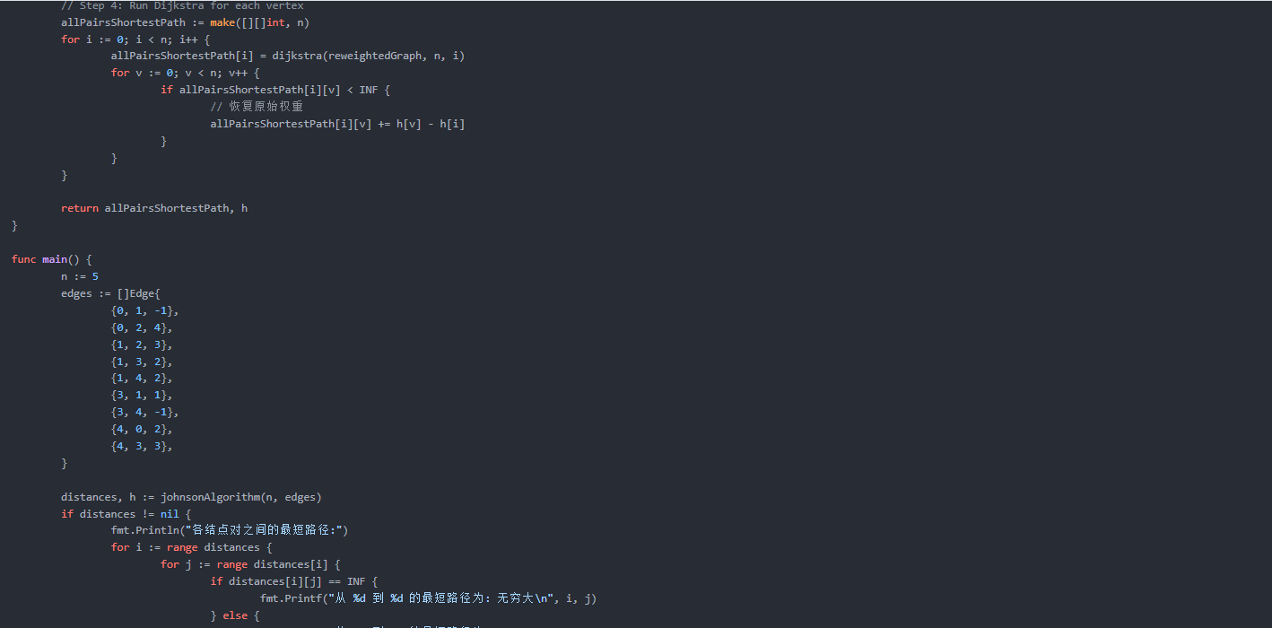

	allPairsShortestPath := make([][]int, n)
		allPairsShortestPath[i] = dijkstra(reweightedGraph, n, i)
		for v := 0; v < n; v++ {
			if allPairsShortestPath[i][v] < INF {
				// 恢复原始权重
				allPairsShortestPath[i][v] += h[v] - h[i]
	return allPairsShortestPath, h
func main() {
	n := 5
	edges := []Edge{
		{0, 1, -1},
		{0, 2, 4},
		{1, 2, 3},
		{1, 3, 2},
		{1, 4, 2},
		{3, 1, 1},
		{3, 4, -1},
		{4, 0, 2},
		{4, 3, 3},
	distances, h := johnsonAlgorithm(n, edges)
	if distances != nil {
		fmt.Println("各结点对之间的最短路径:")
		for i := range distances {
			for j := range distances[i] {
				if distances[i][j] == INF {
					fmt.Printf("从 %d 到 %d 的最短路径为: 无穷大\n", i, j)
				} else {
					fmt.Printf("从 %d 到 %d 的最短路径为: %d\n", i, j, distances[i][j])

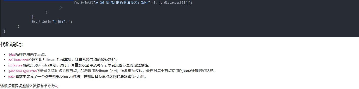

		fmt.Println("h 值:", h)
代码说明:
  • Edge结构体用来表示边。
  • bellmanFord函数实现Bellman-Ford算法,计算从源节点的最短路径。
  • dijkstra函数实现Dijkstra算法,用于计算重加权图中从每个节点到其他节点的最短路径。
  • johnsonAlgorithm函数首先添加虚拟源节点,然后调用Bellman-Ford,接着重加权边,最后对每个节点使用Dijkstra计算最短路径。
  • main函数中定义了一个图并调用Johnson算法,并输出各节点对之间的最短路径和h值。
请根据需要调整输入数据和节点数n。

Johnson算法是一种求解所有结点对之间最短路径的方法,它结合了Bellman-Ford算法和Dijkstra算法。以下是Johnson算法的Go语言实现:
package main
import (
	"container/heap"
	"fmt"
	"math"
type Edge struct {
	from, to, weight int
type Graph struct {
	nodes [][]Edge
func NewGraph(n int) *Graph {
	graph := make([][]Edge, n)
	return &Graph{nodes: graph}
func (g *Graph) AddEdge(from, to, weight int) {
	g.nodes[from] = append(g.nodes[from], Edge{from, to, weight})
func bellmanFord(g *Graph, source int) ([]int, []int) {
	dist := make([]int, len(g.nodes))
	pred := make([]int, len(g.nodes))
		dist[i] = math.MaxInt32
		pred[i] = -1
	dist[source] = 0
	for i := 0; i < len(g.nodes)-1; i++ {
		for _, edge := range g.nodes[source] {
			if dist[edge.from]+edge.weight < dist[edge.to] {
				dist[edge.to] = dist[edge.from] + edge.weight
				pred[edge.to] = edge.from
		source++
	return dist, pred
func dijkstra(g *Graph, source int) ([]int, []int) {
	visited := make([]bool, len(g.nodes))
		pred[i] = -1
	dist[source] = 0
	pq := &PriorityQueue{}
	heap.Init(pq)
	heap.Push(pq, &Item{node: source, priority: 0})
	for pq.Len() > 0 {
		u := heap.Pop(pq).(*Item).node
		if visited[u] {
			continue
		visited[u] = true
		for _, edge := range g.nodes[u] {
			v := edge.to
			alt := dist[u] + edge.weight
			if alt < dist[v] {
				dist[v] = alt
				pred[v] = u
				heap.Push(pq, &Item{node: v, priority: alt})
	return dist, pred
func johnson(g *Graph) ([][]int, []int) {
	// Add a new vertex with zero-weight edges to all other vertices
	newNode := len(g.nodes)
	g.nodes = append(g.nodes, make([]Edge, len(g.nodes)))
	for i := range g.nodes[:newNode] {
		g.nodes[newNode] = append(g.nodes[newNode], Edge{newNode, i, 0})
	// Run Bellman-Ford algorithm from the new vertex
	h, _ := bellmanFord(g, newNode)
	// Reweight the edges
	for u := range g.nodes {
			edge.weight = edge.weight + h[u] - h[edge.to]
	// Remove the added vertex and run Dijkstra's algorithm for each vertex
	g.nodes = g.nodes[:newNode]
	allPairsShortestPaths := make([][]int, len(g.nodes))
	for i := range allPairsShortestPaths {
		dist, _ := dijkstra(g, i)
		for j := range dist {
			dist[j] = dist[j] - h[i] + h[j]
		allPairsShortestPaths[i] = dist
	return allPairsShortestPaths, h
func main() {
	g := NewGraph(3)
	g.AddEdge(0, 1, -1)
	g.AddEdge(0, 2, 4)
	g.AddEdge(1, 2, 3)
	g.AddEdge(1, 0, 2)
	g.AddEdge(2, 1, -2)
	allPairsShortestPaths, h := johnson(g)
	fmt.Println("h values:", h)
	fmt.Println("All pairs shortest paths:", allPairsShortestPaths)
在这个实现中,bellmanFord函数计算了从新添加的顶点到所有其他顶点的最短路径,这些路径值存储在h数组中。然后,我们重新加权图中所有边的权重,使用公式w′(u,v)=w(u,v)+h(u)−h(v)w'(u, v) = w(u, v) + h(u) - h(v)。最后,我们移除新添加的顶点,并对每个顶点运行Dijkstra算法来找到所有结点对之间的最短路径。这些路径在allPairsShortestPaths数组中返回,而hh值在h数组中返回。
请注意,这个实现假设图中没有负权重环。如果在运行Bellman-Ford算法后检测到负权重环,算法将无法正确工作。
