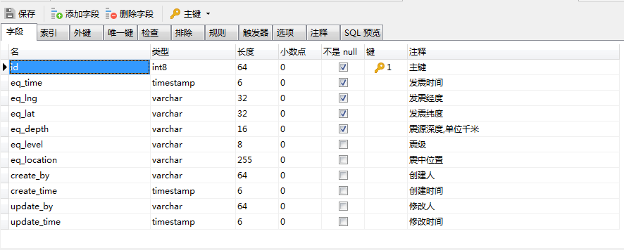

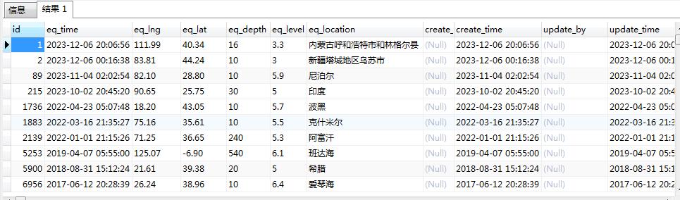

1、地震基础信息
        地震基础信息的表逻辑结构如下:
        表的物理sql语句如下:
-- Table structure for biz_earthquake_info
DROP TABLE IF EXISTS "public"."biz_earthquake_info";
CREATE TABLE "public"."biz_earthquake_info" (
  "id" int8 NOT NULL,
  "eq_time" timestamp(6) NOT NULL,
  "eq_lng" varchar(32) COLLATE "pg_catalog"."default" NOT NULL,
  "eq_lat" varchar(32) COLLATE "pg_catalog"."default" NOT NULL,
  "eq_depth" varchar(16) COLLATE "pg_catalog"."default" NOT NULL,
  "eq_level" varchar(8) COLLATE "pg_catalog"."default",
  "eq_location" varchar(255) COLLATE "pg_catalog"."default",
  "create_by" varchar(64) COLLATE "pg_catalog"."default",
  "create_time" timestamp(6),
  "update_by" varchar(64) COLLATE "pg_catalog"."default",
  "update_time" timestamp(6)
COMMENT ON COLUMN "public"."biz_earthquake_info"."id" IS '主键';
COMMENT ON COLUMN "public"."biz_earthquake_info"."eq_time" IS '发震时间';
COMMENT ON COLUMN "public"."biz_earthquake_info"."eq_lng" IS '发震经度';
COMMENT ON COLUMN "public"."biz_earthquake_info"."eq_lat" IS '发震纬度';
COMMENT ON COLUMN "public"."biz_earthquake_info"."eq_depth" IS '震源深度,单位千米';
COMMENT ON COLUMN "public"."biz_earthquake_info"."eq_level" IS '震级';
COMMENT ON COLUMN "public"."biz_earthquake_info"."eq_location" IS '震中位置';
COMMENT ON COLUMN "public"."biz_earthquake_info"."create_by" IS '创建人';
COMMENT ON COLUMN "public"."biz_earthquake_info"."create_time" IS '创建时间';
COMMENT ON COLUMN "public"."biz_earthquake_info"."update_by" IS '修改人';
COMMENT ON COLUMN "public"."biz_earthquake_info"."update_time" IS '修改时间';
-- Indexes structure for table biz_earthquake_info
CREATE INDEX "idx_biz_earthquake_info_depth" ON "public"."biz_earthquake_info" USING btree (
  "eq_depth" COLLATE "pg_catalog"."default" "pg_catalog"."text_ops" ASC NULLS LAST
CREATE INDEX "idx_biz_earthquake_info_etime" ON "public"."biz_earthquake_info" USING btree (
  "eq_time" "pg_catalog"."timestamp_ops" ASC NULLS LAST
CREATE INDEX "idx_biz_earthquake_info_qlevel" ON "public"."biz_earthquake_info" USING btree (
  "eq_level" COLLATE "pg_catalog"."default" "pg_catalog"."text_ops" ASC NULLS LAST
-- Primary Key structure for table biz_earthquake_info
ALTER TABLE "public"."biz_earthquake_info" ADD CONSTRAINT "pk_biz_earthquake_info" PRIMARY KEY ("id");

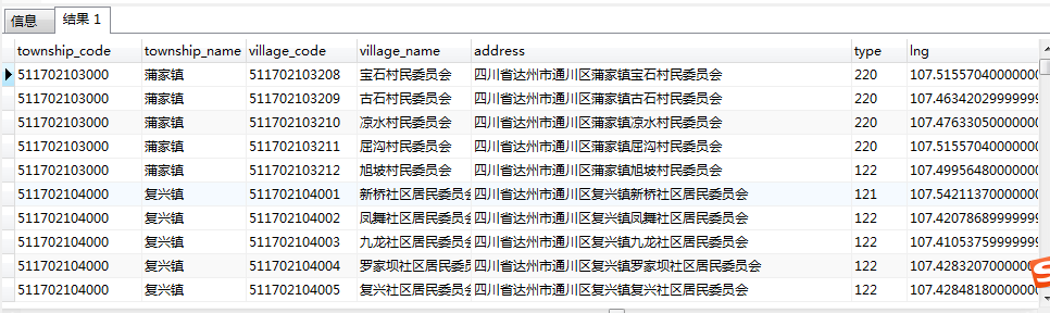

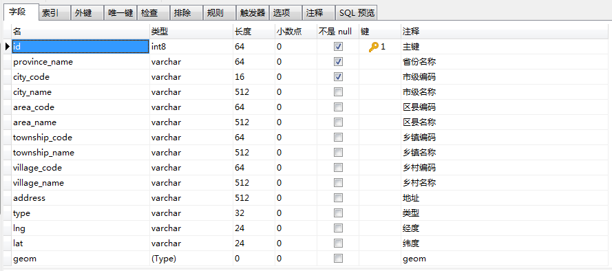

2、全国行政村
        全国行政村点位表逻辑结构如下所示:
        行政村点位的物理sql语句如下:
-- Table structure for biz_village
DROP TABLE IF EXISTS "public"."biz_village";
CREATE TABLE "public"."biz_village" (
  "id" int8 NOT NULL,
  "province_name" varchar(64) COLLATE "pg_catalog"."default" NOT NULL,
  "city_code" varchar(16) COLLATE "pg_catalog"."default" NOT NULL,
  "city_name" varchar(512) COLLATE "pg_catalog"."default",
  "area_code" varchar(64) COLLATE "pg_catalog"."default",
  "area_name" varchar(512) COLLATE "pg_catalog"."default",
  "township_code" varchar(64) COLLATE "pg_catalog"."default",
  "township_name" varchar(512) COLLATE "pg_catalog"."default",
  "village_code" varchar(64) COLLATE "pg_catalog"."default",
  "village_name" varchar(512) COLLATE "pg_catalog"."default",
  "address" varchar(512) COLLATE "pg_catalog"."default",
  "type" varchar(32) COLLATE "pg_catalog"."default",
  "lng" varchar(24) COLLATE "pg_catalog"."default",
  "lat" varchar(24) COLLATE "pg_catalog"."default",
  "geom" "public"."geometry"
COMMENT ON COLUMN "public"."biz_village"."id" IS '主键';
COMMENT ON COLUMN "public"."biz_village"."province_name" IS '省份名称';
COMMENT ON COLUMN "public"."biz_village"."city_code" IS '市级编码';
COMMENT ON COLUMN "public"."biz_village"."city_name" IS '市级名称';
COMMENT ON COLUMN "public"."biz_village"."area_code" IS '区县编码';
COMMENT ON COLUMN "public"."biz_village"."area_name" IS '区县名称';
COMMENT ON COLUMN "public"."biz_village"."township_code" IS '乡镇编码';
COMMENT ON COLUMN "public"."biz_village"."township_name" IS '乡镇名称';
COMMENT ON COLUMN "public"."biz_village"."village_code" IS '乡村编码';
COMMENT ON COLUMN "public"."biz_village"."village_name" IS '乡村名称';
COMMENT ON COLUMN "public"."biz_village"."address" IS '地址';
COMMENT ON COLUMN "public"."biz_village"."type" IS '类型';
COMMENT ON COLUMN "public"."biz_village"."lng" IS '经度';
COMMENT ON COLUMN "public"."biz_village"."lat" IS '纬度';
COMMENT ON COLUMN "public"."biz_village"."geom" IS 'geom';
-- Indexes structure for table biz_village
CREATE INDEX "idx_biz_village_areacode" ON "public"."biz_village" USING btree (
  "area_code" COLLATE "pg_catalog"."default" "pg_catalog"."text_ops" ASC NULLS LAST
CREATE INDEX "idx_biz_village_city_code" ON "public"."biz_village" USING btree (
  "city_code" COLLATE "pg_catalog"."default" "pg_catalog"."text_ops" ASC NULLS LAST
CREATE INDEX "idx_biz_village_geom" ON "public"."biz_village" USING gist (
  "geom" "public"."gist_geometry_ops_2d"
-- Primary Key structure for table biz_village
ALTER TABLE "public"."biz_village" ADD CONSTRAINT "pk_biz_village" PRIMARY KEY ("id");

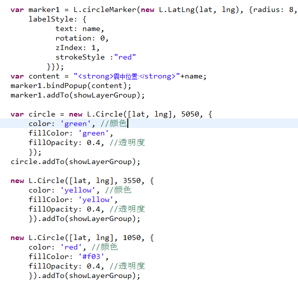

2、震中位置及影响范围标记
        震中位置采用marker的方式进行标记,而影响范围则使用园来标识。

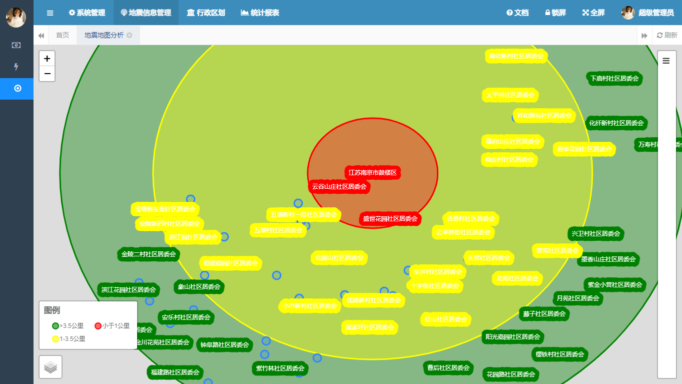

3、行政村点查询及标记
        这里使用ajax的方式,由前端将地震发生的经纬度作为接口参数传递到后台,后台经过计算,将不同范围的数据返回到前端,包括经纬度位置,还有距离震中的距离、行政区名称等等。再由前端动态绘制相应的界面。关键代码如下:
$.ajax({
	            type: "post",
	            url: prefix + "/villageinfo",
	            data: {"lng":lng,"lat":lat},
	            success: function(rsData) {
	    			var villageData = rsData.data;
	    			for (var i = 0; i < villageData.length; i++) {
	    				var info = villageData[i];
	    				var dist = info.dist;
	    				var strokeStyleSet = "green";
	    				if(parseFloat(dist) > 1000 && parseFloat(dist) <= 3500){
	    					strokeStyleSet = "yellow";
	    				if(parseFloat(dist) <= 1000){
	    					strokeStyleSet = "red";
	    				var marker = L.circleMarker(new L.LatLng(info.lat, info.lng), {radius: 8,
	    			        labelStyle: {
		    			          text: info.villageName,
		    			          rotation: 0,
		    			          zIndex: i,
		    			          strokeStyle :strokeStyleSet
	    				var content = "<strong>地址:</strong>"+info.address + "<br/><strong>震中位置:</strong>"+name;
	    				    content += "<br/><strong>距离震中(千米):</strong>"+info.dist;
	    				marker.bindPopup(content);
	    				marker.addTo(showLayerGroup);
	    			mymap.fitBounds(showLayerGroup.getBounds());

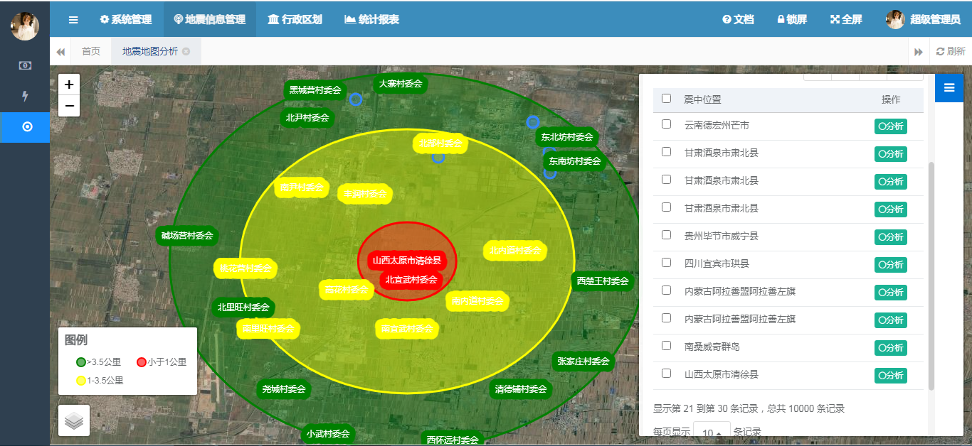

        最终实际效果如下:
