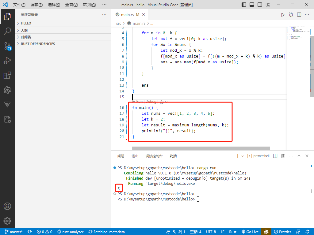

Rust完整代码如下:
fn maximum_length(nums: Vec<i32>, k: i32) -> i32 {
    let mut ans = 0;
    for m in 0..k {
        let mut f = vec![0; k as usize];
        for &x in &nums {
            let mod_x = x % k;
            f[mod_x as usize] = f[((m - mod_x + k) % k) as usize] + 1;
            ans = ans.max(f[mod_x as usize]);
    ans
fn main() {
    let nums = vec![1, 2, 3, 4, 5];
    let k = 2;
    let result = maximum_length(nums, k);
    println!("{}", result);

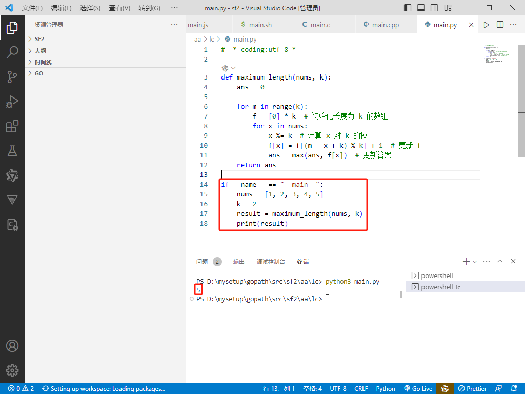

Python完整代码如下:
# -*-coding:utf-8-*-
def maximum_length(nums, k):
    ans = 0
    for m in range(k):
        f = [0] * k  # 初始化长度为 k 的数组
        for x in nums:
            x %= k  # 计算 x 对 k 的模
            f[x] = f[(m - x + k) % k] + 1  # 更新 f
            ans = max(ans, f[x])  # 更新答案
    return ans
if __name__ == "__main__":
    nums = [1, 2, 3, 4, 5]
    k = 2
    print(result)
