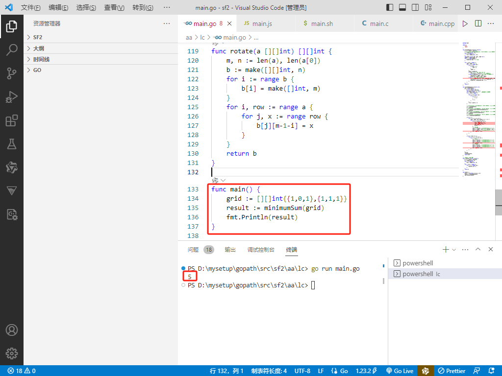

	grid := [][]int{{1,0,1},{1,1,1}}
	result := minimumSum(grid)
	fmt.Println(result)

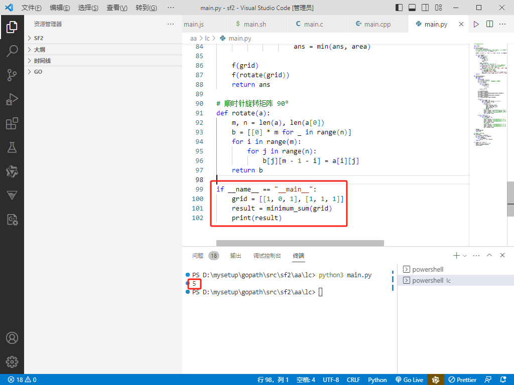

if __name__ == "__main__":
    grid = [[1, 0, 1], [1, 1, 1]]
    result = minimum_sum(grid)
    print(result)

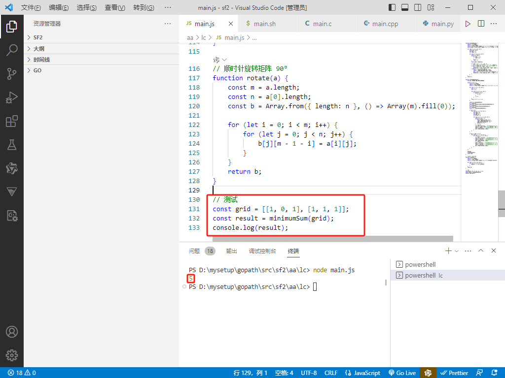

// 测试
const grid = [[1, 0, 1], [1, 1, 1]];
const result = minimumSum(grid);
console.log(result);
