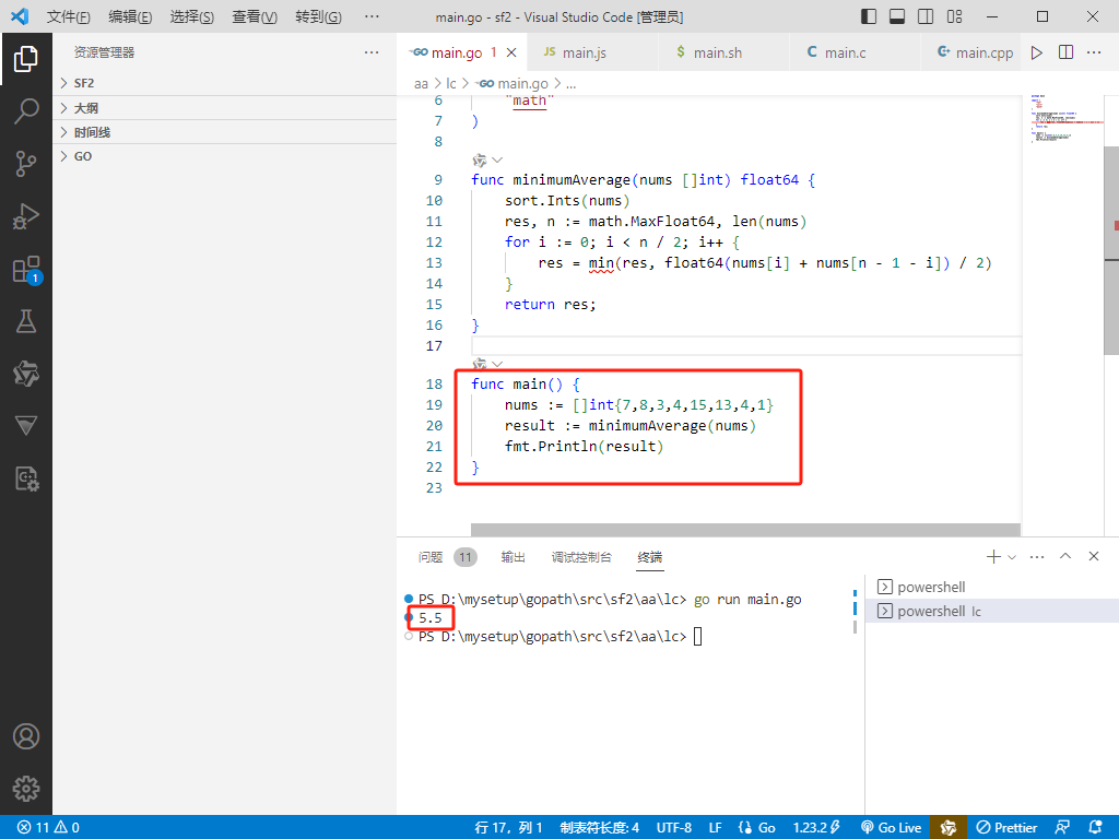

Go完整代码如下:
package main
import (
"fmt"
"sort"
"math"
func minimumAverage(nums []int) float64 {
sort.Ints(nums)
res, n := math.MaxFloat64, len(nums)
for i := 0; i < n / 2; i++ {
res = min(res, float64(nums[i] + nums[n - 1 - i]) / 2)
return res;
func main() {
nums := []int{7,8,3,4,15,13,4,1}
result := minimumAverage(nums)
fmt.Println(result)

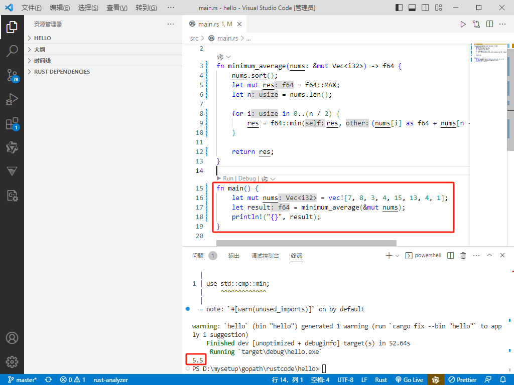

Rust完整代码如下:
use std::cmp::min;
fn minimum_average(nums: &mut Vec<i32>) -> f64 {
nums.sort();
let mut res = f64::MAX;
let n = nums.len();
for i in 0..(n / 2) {
res = f64::min(res, (nums[i] as f64 + nums[n - 1 - i] as f64) / 2.0);
return res;
fn main() {
let mut nums = vec![7, 8, 3, 4, 15, 13, 4, 1];
let result = minimum_average(&mut nums);
println!("{}", result);

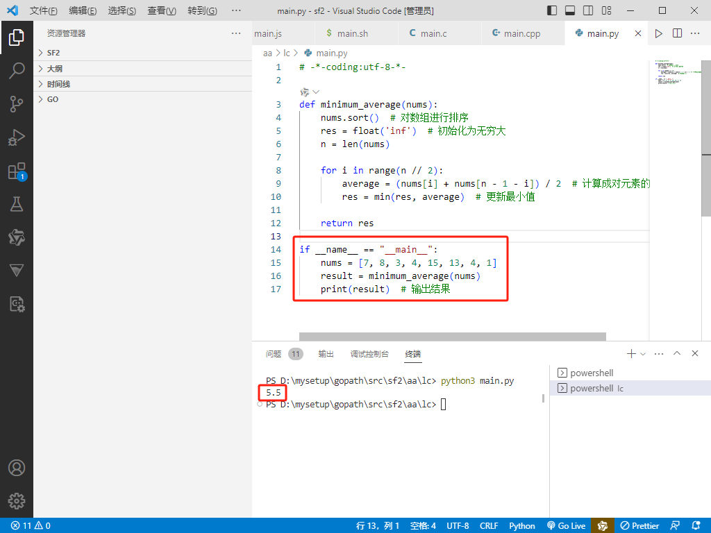

Python完整代码如下:
# -*-coding:utf-8-*-
def minimum_average(nums):
nums.sort() # 对数组进行排序
res = float('inf') # 初始化为无穷大
n = len(nums)
for i in range(n // 2):
average = (nums[i] + nums[n - 1 - i]) / 2 # 计算成对元素的平均值
res = min(res, average) # 更新最小值
return res
if __name__ == "__main__":
nums = [7, 8, 3, 4, 15, 13, 4, 1]
result = minimum_average(nums)
print(result) # 输出结果
