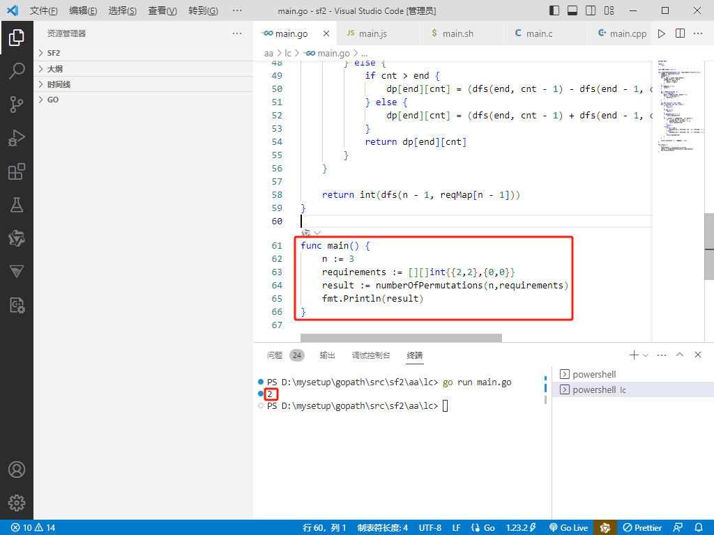

package main
import (
	"fmt"
const MOD int64 = 1e9 + 7
func numberOfPermutations(n int, requirements [][]int) int {
    reqMap := make(map[int]int)
	reqMap[0] = 0
	maxCnt := 0
	for _, req := range requirements {
		reqMap[req[0]] = req[1]
		if req[1] > maxCnt {
			maxCnt = req[1]
	if reqMap[0] != 0 {
		return 0
	dp := make([][]int64, n)
	for i := range dp {
		dp[i] = make([]int64, maxCnt + 1)
		for j := range dp[i] {
			dp[i][j] = -1
	var dfs func(int, int) int64
	dfs = func(end, cnt int) int64 {
		if cnt < 0 {
			return 0
		if end == 0 {
			return 1
		if dp[end][cnt] != -1 {
			return dp[end][cnt]
		if r, exists := reqMap[end - 1]; exists {
			if r <= cnt && cnt <= end + r {
				dp[end][cnt] = dfs(end - 1, r)
				return dp[end][cnt]
			return 0
		} else {
			if cnt > end {
				dp[end][cnt] = (dfs(end, cnt - 1) - dfs(end - 1, cnt - 1 - end) + dfs(end - 1, cnt) + MOD) % MOD
			} else {
				dp[end][cnt] = (dfs(end, cnt - 1) + dfs(end - 1, cnt)) % MOD
			return dp[end][cnt]
	return int(dfs(n - 1, reqMap[n - 1]))
func main() {
	n := 3
	requirements := [][]int{{2,2},{0,0}}
	result := numberOfPermutations(n,requirements)
	fmt.Println(result)

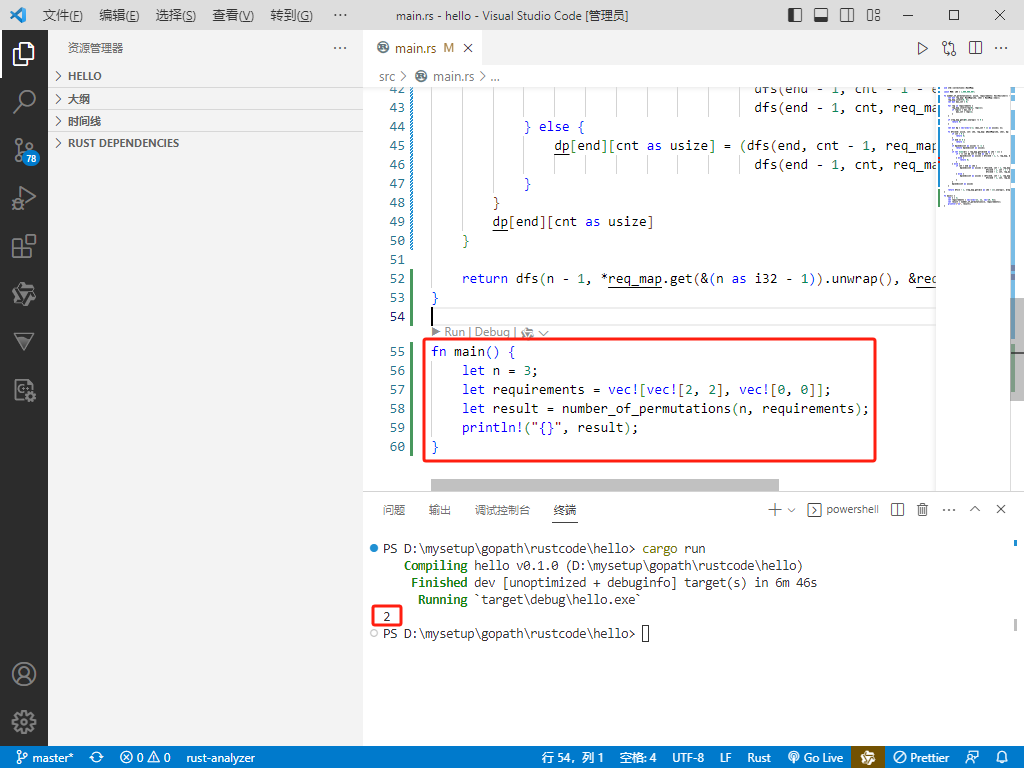

Rust完整代码如下:
use std::collections::HashMap;
const MOD: i64 = 1_000_000_007;
fn number_of_permutations(n: usize, requirements: Vec<Vec<i32>>) -> i64 {
    let mut req_map: HashMap<i32, i32> = HashMap::new();
    req_map.insert(0, 0);
    let mut max_cnt = 0;
    for req in requirements {
        req_map.insert(req[0], req[1]);
        if req[1] > max_cnt {
            max_cnt = req[1];
    if *req_map.get(&0).unwrap() != 0 {
        return 0;
    let mut dp = vec![vec![-1; (max_cnt + 1) as usize]; n];
    fn dfs(end: usize, cnt: i32, req_map: &HashMap<i32, i32>, dp: &mut Vec<Vec<i64>>) -> i64 {
        if cnt < 0 {
            return 0;
        if end == 0 {
            return 1;
        if dp[end][cnt as usize] != -1 {
            return dp[end][cnt as usize];
        if let Some(&r) = req_map.get(&(end as i32 - 1)) {
            if r <= cnt && cnt <= end as i32 + r {
                dp[end][cnt as usize] = dfs(end - 1, r, req_map, dp);
            } else {
                return 0;
        } else {
            if cnt > end as i32 {
                dp[end][cnt as usize] = (dfs(end, cnt - 1, req_map, dp) -
                                          dfs(end - 1, cnt - 1 - end as i32, req_map, dp) +
                                          dfs(end - 1, cnt, req_map, dp) + MOD) % MOD;
            } else {
                dp[end][cnt as usize] = (dfs(end, cnt - 1, req_map, dp) +
                                          dfs(end - 1, cnt, req_map, dp)) % MOD;
    return dfs(n - 1, *req_map.get(&(n as i32 - 1)).unwrap(), &req_map, &mut dp);
fn main() {
    let n = 3;
    let requirements = vec![vec![2, 2], vec![0, 0]];
    let result = number_of_permutations(n, requirements);
    println!("{}", result);

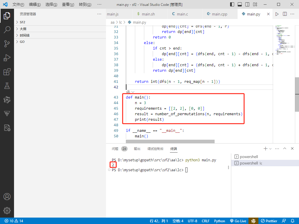

Python完整代码如下:
# -*-coding:utf-8-*-
MOD = 10**9 + 7
def number_of_permutations(n, requirements):
    req_map = {0: 0}
    max_cnt = 0
    for req in requirements:
        req_map[req[0]] = req[1]
        if req[1] > max_cnt:
            max_cnt = req[1]
    if req_map[0] != 0:
        return 0
    # 初始化动态规划表
    dp = [[-1] * (max_cnt + 1) for _ in range(n)]
    def dfs(end, cnt):
        if cnt < 0:
            return 0
        if end == 0:
            return 1
        if dp[end][cnt] != -1:
            return dp[end][cnt]
        if end - 1 in req_map:
            r = req_map[end - 1]
            if r <= cnt <= end + r:
                return dp[end][cnt]
            return 0
        else:
            if cnt > end:
                dp[end][cnt] = (dfs(end, cnt - 1) - dfs(end - 1, cnt - 1 - end) + dfs(end - 1, cnt)) % MOD
            else:
            return dp[end][cnt]
    return int(dfs(n - 1, req_map[n - 1]))
def main():
    n = 3
    requirements = [[2, 2], [0, 0]]
    print(result)
if __name__ == "__main__":
    main()
