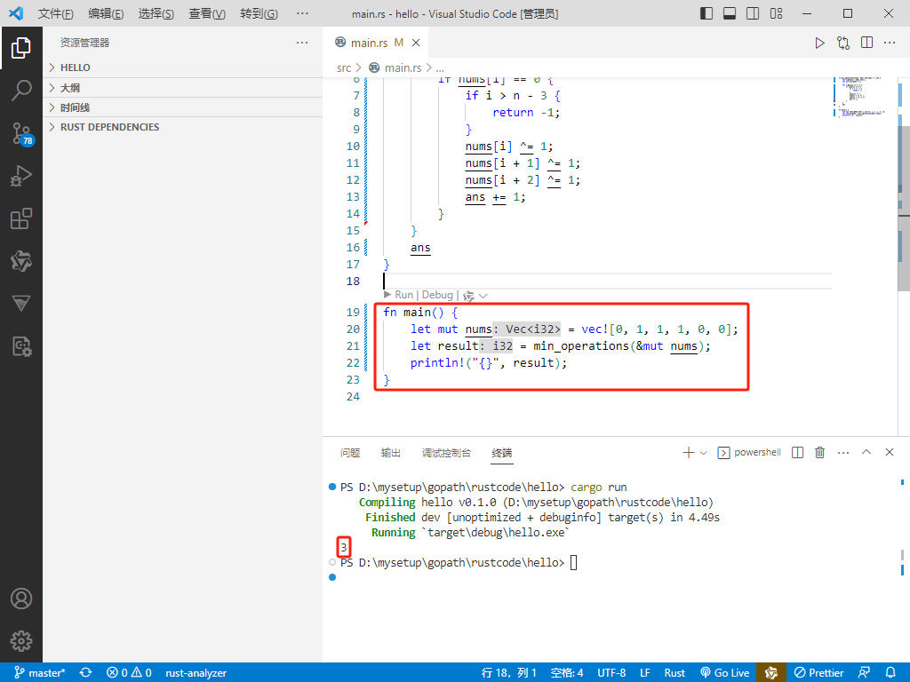

Rust完整代码如下:
fn min_operations(nums: &mut Vec<i32>) -> i32 {
    let n = nums.len();
    let mut ans = 0;
    for i in 0..n {
        if nums[i] == 0 {
            if i > n - 3 {
                return -1;
            nums[i] ^= 1;
            nums[i + 1] ^= 1;
            nums[i + 2] ^= 1;
            ans += 1;
    ans
fn main() {
    let mut nums = vec![0, 1, 1, 1, 0, 0];
    let result = min_operations(&mut nums);
    println!("{}", result);

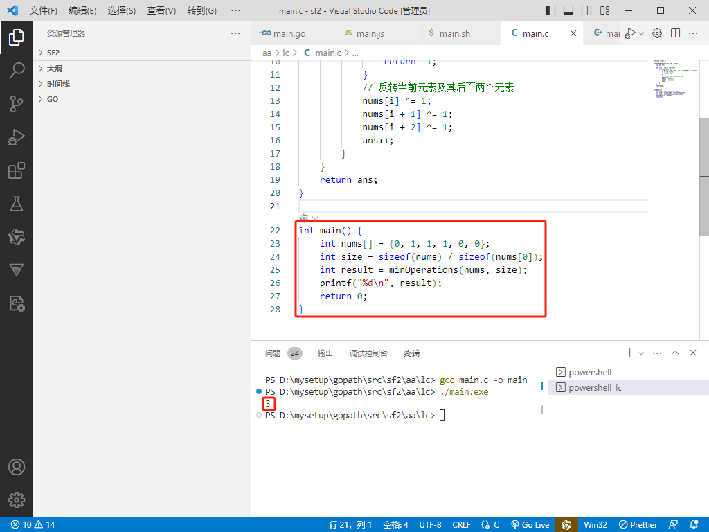

C完整代码如下:
#include <stdio.h>
int minOperations(int* nums, int n) {
    int ans = 0;
    for (int i = 0; i < n; i++) {
        if (nums[i] == 0) {
            // 如果当前位置 i 超过 n - 3,即剩余数小于 3,无法进行操作
            if (i > n - 3) {
                return -1;
            // 反转当前元素及其后面两个元素
            nums[i] ^= 1;
            nums[i + 1] ^= 1;
            nums[i + 2] ^= 1;
            ans++;
    return ans;
int main() {
    int nums[] = {0, 1, 1, 1, 0, 0};
    int size = sizeof(nums) / sizeof(nums[0]);
    int result = minOperations(nums, size);
    printf("%d\n", result);
    return 0;

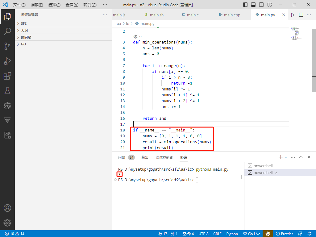

Python完整代码如下:
# -*-coding:utf-8-*-
def min_operations(nums):
    n = len(nums)
    ans = 0
    for i in range(n):
        if nums[i] == 0:
            if i > n - 3:
                return -1
            nums[i] ^= 1
            nums[i + 1] ^= 1
            nums[i + 2] ^= 1
            ans += 1
    return ans
if __name__ == "__main__":
    nums = [0, 1, 1, 1, 0, 0]
    result = min_operations(nums)
    print(result)

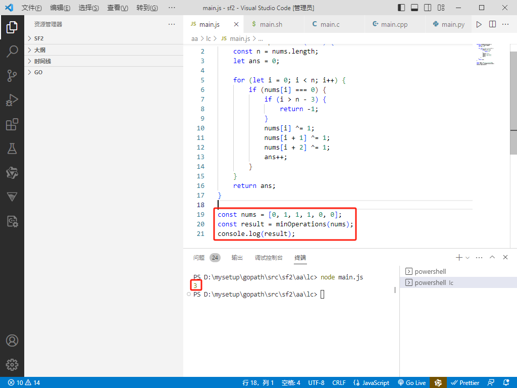

JavaScript完整代码如下:
function minOperations(nums) {
    const n = nums.length;
    let ans = 0;
    for (let i = 0; i < n; i++) {
        if (nums[i] === 0) {
            if (i > n - 3) {
                return -1;
            nums[i] ^= 1;
            nums[i + 1] ^= 1;
            nums[i + 2] ^= 1;
            ans++;
    return ans;
const nums = [0, 1, 1, 1, 0, 0];
const result = minOperations(nums);
console.log(result);

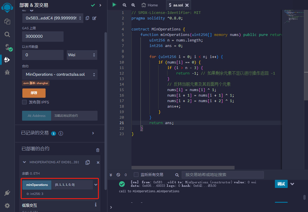

Solidity完整代码如下:
// SPDX-License-Identifier: MIT
pragma solidity ^0.8.0;
contract MinOperations {
    function minOperations(uint256[] memory nums) public pure returns (int256) {
        uint256 n = nums.length;
        int256 ans = 0;
        for (uint256 i = 0; i < n; i++) {
            if (nums[i] == 0) {
                if (i > n - 3) {
                    return -1; // 如果剩余元素不足以进行操作返回 -1
                // 反转当前元素及其后面两个元素
                nums[i] = nums[i] ^ 1;
                nums[i + 1] = nums[i + 1] ^ 1;
                nums[i + 2] = nums[i + 2] ^ 1;
                ans++;
        return ans;
