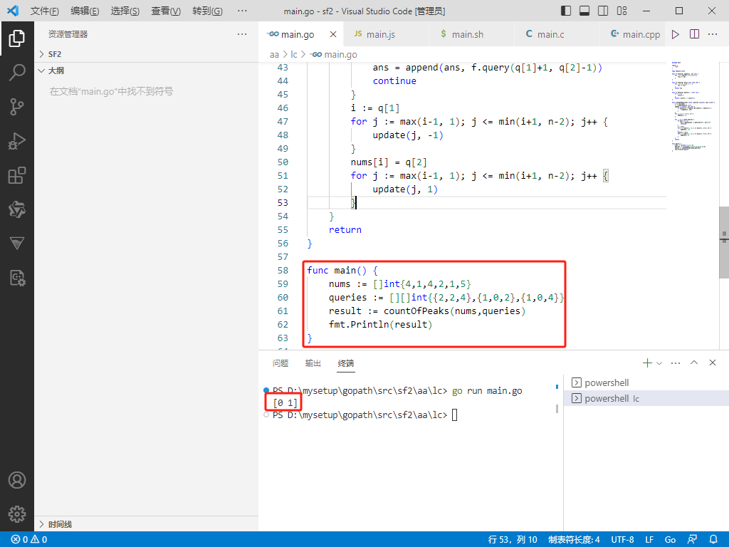

func main() {

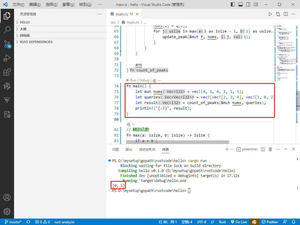

nums := []int{4,1,4,2,1,5}
queries := [][]int{{2,2,4},{1,0,2},{1,0,4}}
result := countOfPeaks(nums,queries)
fmt.Println(result)
Rust完整代码如下:
struct Fenwick {
tree: Vec<i32>,
impl Fenwick {
fn new(size: usize) -> Self {
Fenwick {
tree: vec![0; size + 1],
fn update(&mut self, index: usize, value: i32) {
let mut i = index as isize;
while i < self.tree.len() as isize {
self.tree[i as usize] += value;
i += i & -i;
fn pre(&self, index: usize) -> i32 {
let mut res = 0;
while i > 0 {
res += self.tree[i as usize];
i &= i - 1;
res
fn query(&self, left: usize, right: usize) -> i32 {
if right < left {
return 0;
self.pre(right) - self.pre(left - 1)
fn count_of_peaks(nums: &mut Vec<i32>, queries: Vec<Vec<i32>>) -> Vec<i32> {
let n = nums.len();
let mut f = Fenwick::new(n - 1);
fn update_peak(f: &mut Fenwick, nums: &[i32], i: usize, val: i32) {
if i > 0 && i < nums.len() - 1 {
if nums[i - 1] < nums[i] && nums[i] > nums[i + 1] {
f.update(i, val);
for i in 1..(n - 1) {
update_peak(&mut f, nums, i, 1);
let mut ans = Vec::new();
for q in queries {
if q[0] == 1 {
ans.push(f.query((q[1] + 1) as usize, (q[2] - 1) as usize));
} else {
let i = q[1] as usize;
for j in max(i as isize - 1, 1) as usize..=min(i + 1, n - 2) {
update_peak(&mut f, nums, j, -1);
nums[i] = q[2];
update_peak(&mut f, nums, j, 1);
ans
fn main() {
let mut nums = vec![4, 1, 4, 2, 1, 5];
let queries = vec![vec![2, 2, 4], vec![1, 0, 2], vec![1, 0, 4]];
let result = count_of_peaks(&mut nums, queries);
println!("{:?}", result);

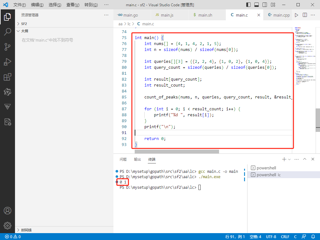

int main() {
int nums[] = {4, 1, 4, 2, 1, 5};
int n = sizeof(nums) / sizeof(nums[0]);
int queries[][3] = {{2, 2, 4}, {1, 0, 2}, {1, 0, 4}};
int query_count = sizeof(queries) / sizeof(queries[0]);
int result[query_count];
int result_count;
count_of_peaks(nums, n, queries, query_count, result, &result_count);
for (int i = 0; i < result_count; i++) {
printf("%d ", result[i]);
printf("\n");
return 0;

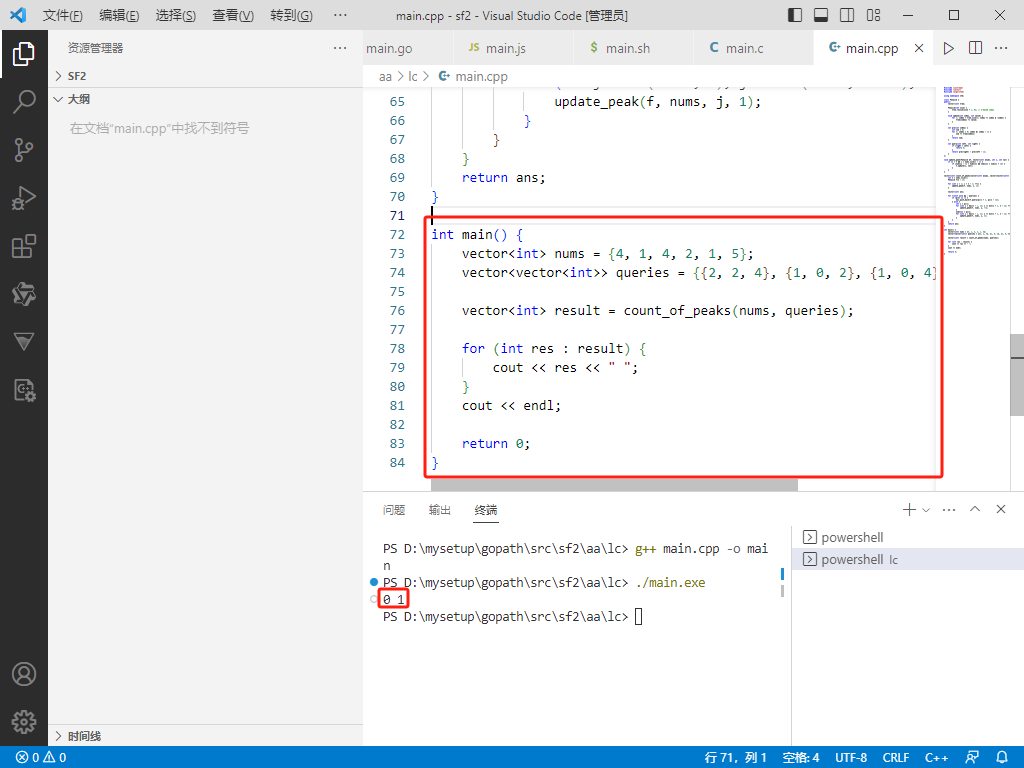

int main() {
vector<int> nums = {4, 1, 4, 2, 1, 5};
vector<vector<int>> queries = {{2, 2, 4}, {1, 0, 2}, {1, 0, 4}};
vector<int> result = count_of_peaks(nums, queries);
for (int res : result) {
cout << res << " ";
cout << endl;
return 0;

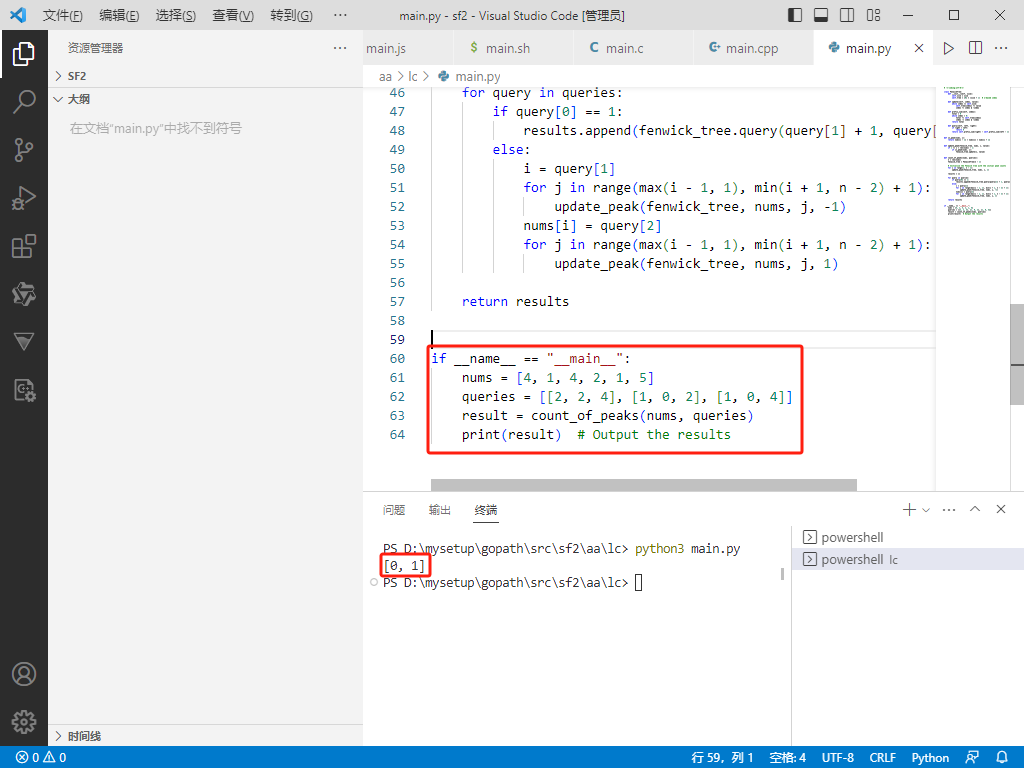

if __name__ == "__main__":
nums = [4, 1, 4, 2, 1, 5]
queries = [[2, 2, 4], [1, 0, 2], [1, 0, 4]]
print(result) # Output the results

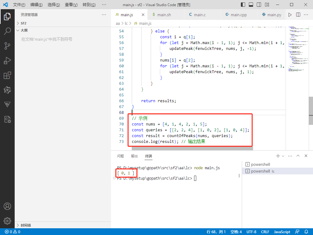

// 示例
const nums = [4, 1, 4, 2, 1, 5];
const queries = [[2, 2, 4], [1, 0, 2], [1, 0, 4]];
const result = countOfPeaks(nums, queries);
console.log(result); // 输出结果
