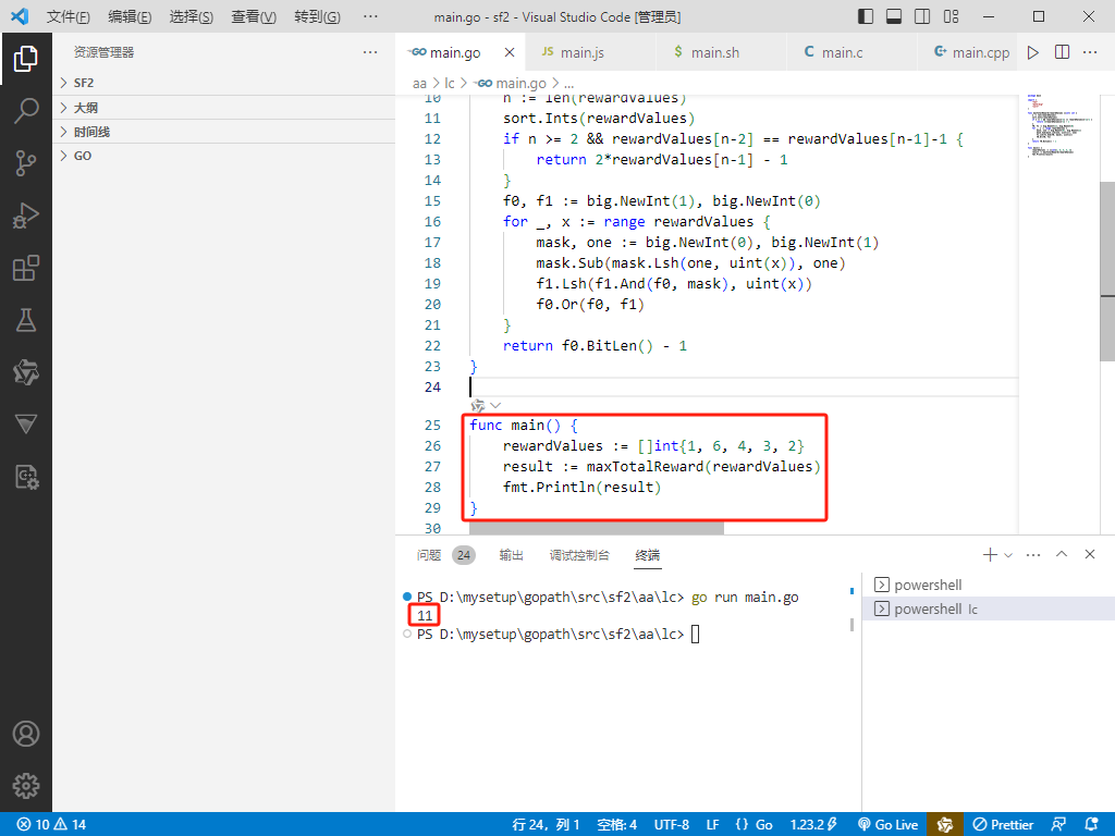

Go完整代码如下:
package main
import (
	"fmt"
	"math/big"
	"sort"
func maxTotalReward(rewardValues []int) int {
	n := len(rewardValues)
	sort.Ints(rewardValues)
	if n >= 2 && rewardValues[n-2] == rewardValues[n-1]-1 {
		return 2*rewardValues[n-1] - 1
	f0, f1 := big.NewInt(1), big.NewInt(0)
	for _, x := range rewardValues {
		mask, one := big.NewInt(0), big.NewInt(1)
		mask.Sub(mask.Lsh(one, uint(x)), one)
		f1.Lsh(f1.And(f0, mask), uint(x))
		f0.Or(f0, f1)
	return f0.BitLen() - 1
func main() {
	rewardValues := []int{1, 6, 4, 3, 2}
	result := maxTotalReward(rewardValues)
	fmt.Println(result)

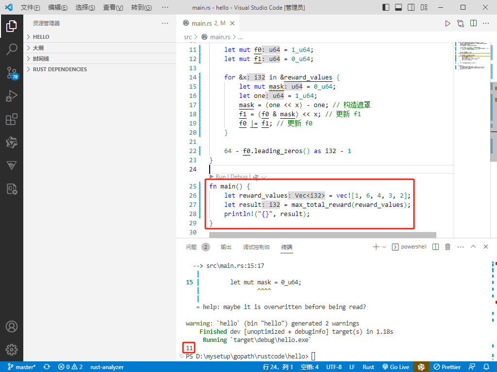

Rust完整代码如下:
fn max_total_reward(reward_values: Vec<i32>) -> i32 {
    let mut reward_values = reward_values.clone();
    reward_values.sort();
    let n = reward_values.len();
    // 如果倒数第二个和倒数第一个元素满足条件
    if n >= 2 && reward_values[n - 2] == reward_values[n - 1] - 1 {
        return 2 * reward_values[n - 1] - 1;
    let mut f0 = 1_u64;
    let mut f1 = 0_u64;
    for &x in &reward_values {
        let mut mask = 0_u64;
        let one = 1_u64;
        mask = (one << x) - one; // 构造遮罩
        f1 = (f0 & mask) << x; // 更新 f1
        f0 |= f1; // 更新 f0
    64 - f0.leading_zeros() as i32 - 1
fn main() {
    let reward_values = vec![1, 6, 4, 3, 2];
    let result = max_total_reward(reward_values);
    println!("{}", result);

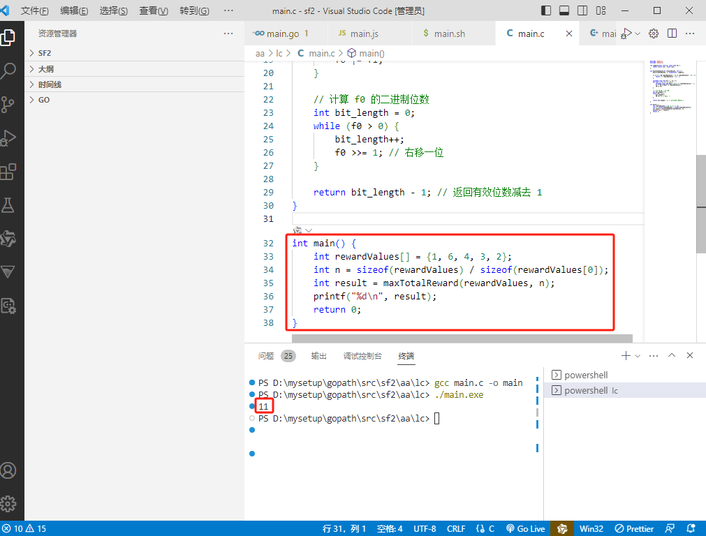

C完整代码如下:
#include <stdio.h>
#include <stdlib.h>
int compare(const void *a, const void *b) {
    return (*(int *)a - *(int *)b);
int maxTotalReward(int *rewardValues, int n) {
    qsort(rewardValues, n, sizeof(int), compare);
    if (n >= 2 && rewardValues[n - 2] == rewardValues[n - 1] - 1) {
        return 2 * rewardValues[n - 1] - 1;
    unsigned long long f0 = 1, f1 = 0;
    for (int i = 0; i < n; i++) {
        unsigned long long mask = (1ULL << rewardValues[i]) - 1;
        f1 = (f0 & mask) << rewardValues[i];
        f0 |= f1;
    // 计算 f0 的二进制位数
    int bit_length = 0;
    while (f0 > 0) {
        bit_length++;
        f0 >>= 1; // 右移一位
    return bit_length - 1; // 返回有效位数减去 1
int main() {
    int rewardValues[] = {1, 6, 4, 3, 2};
    int n = sizeof(rewardValues) / sizeof(rewardValues[0]);
    int result = maxTotalReward(rewardValues, n);
    printf("%d\n", result);
    return 0;

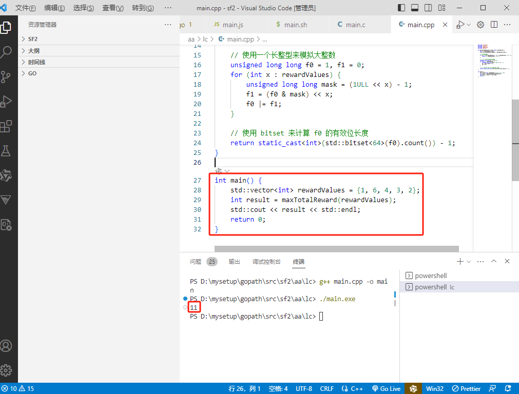

C++完整代码如下:
#include <iostream>
#include <vector>
#include <algorithm>
#include <bitset>
int maxTotalReward(std::vector<int>& rewardValues) {
    int n = rewardValues.size();
    std::sort(rewardValues.begin(), rewardValues.end());
    // 特殊情况判断
    // 使用一个长整型来模拟大整数
    for (int x : rewardValues) {
        unsigned long long mask = (1ULL << x) - 1;
        f0 |= f1;
    // 使用 bitset 来计算 f0 的有效位长度
    return static_cast<int>(std::bitset<64>(f0).count()) - 1;
int main() {
    std::vector<int> rewardValues = {1, 6, 4, 3, 2};
    int result = maxTotalReward(rewardValues);
    std::cout << result << std::endl;
    return 0;

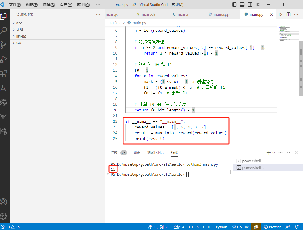

Python完整代码如下:
# -*-coding:utf-8-*-
def max_total_reward(reward_values):
    # 排序
    n = len(reward_values)
    # 特殊情况处理
    if n >= 2 and reward_values[-2] == reward_values[-1] - 1:
        return 2 * reward_values[-1] - 1
    # 初始化 f0 和 f1
    f0 = 1
    for x in reward_values:
        mask = (1 << x) - 1  # 创建掩码
        f1 = (f0 & mask) << x  # 计算新的 f1
        f0 |= f1  # 更新 f0
    # 计算 f0 的二进制位长度
    return f0.bit_length() - 1
if __name__ == "__main__":
    reward_values = [1, 6, 4, 3, 2]
    print(result)

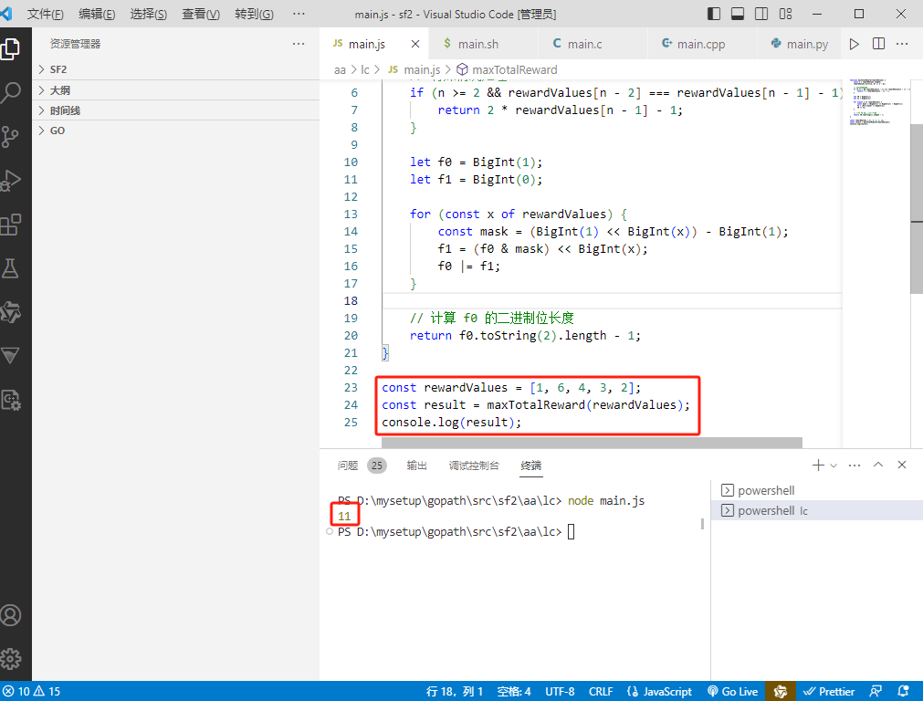

JavaScript完整代码如下:
function maxTotalReward(rewardValues) {
    const n = rewardValues.length;
    rewardValues.sort((a, b) => a - b);
    // 特殊情况处理
    if (n >= 2 && rewardValues[n - 2] === rewardValues[n - 1] - 1) {
    let f0 = BigInt(1);
    let f1 = BigInt(0);
    for (const x of rewardValues) {
        const mask = (BigInt(1) << BigInt(x)) - BigInt(1);
        f1 = (f0 & mask) << BigInt(x);
        f0 |= f1;
    // 计算 f0 的二进制位长度
    return f0.toString(2).length - 1;
const rewardValues = [1, 6, 4, 3, 2];
const result = maxTotalReward(rewardValues);
console.log(result);
