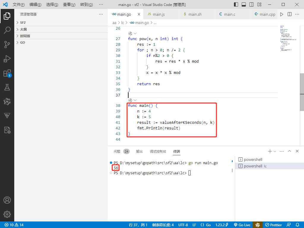

Go完整代码如下:
package main
import (
	"fmt"
const mod = 1_000_000_007
const mx = 2000
var F, invF [mx + 1]int
func init() {
	F[0] = 1
	for i := 1; i <= mx; i++ {
		F[i] = F[i-1] * i % mod
	invF[mx] = pow(F[mx], mod-2)
	for i := mx; i > 0; i-- {
		invF[i-1] = invF[i] * i % mod
func valueAfterKSeconds(n, k int) int {
	return F[n+k-1] * invF[n-1] % mod * invF[k] % mod
func pow(x, n int) int {
	res := 1
	for ; n > 0; n /= 2 {
		if n%2 > 0 {
			res = res * x % mod
		x = x * x % mod
	return res
func main() {
	n := 4
	k := 5
	result := valueAfterKSeconds(n, k)
	fmt.Println(result)

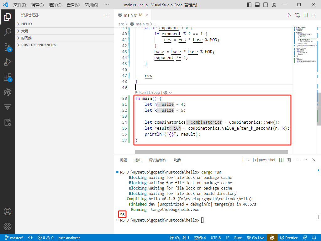

Rust完整代码如下:
const MOD: i64 = 1_000_000_007;
const MX: usize = 2000;
struct Combinatorics {
    f: Vec<i64>,
    inv_f: Vec<i64>,
impl Combinatorics {
    fn new() -> Self {
        let mut f = vec![1; MX + 1];
        let mut inv_f = vec![1; MX + 1];
        // Calculate factorials
        for i in 1..=MX {
            f[i] = f[i - 1] * i as i64 % MOD;
        // Calculate inverse of factorials using Fermat's little theorem
        inv_f[MX] = pow(f[MX], MOD - 2);
        for i in (1..=MX).rev() {
            inv_f[i - 1] = inv_f[i] * i as i64 % MOD;
        Combinatorics { f, inv_f }
    fn value_after_k_seconds(&self, n: usize, k: usize) -> i64 {
        self.f[n + k - 1] * self.inv_f[n - 1] % MOD * self.inv_f[k] % MOD
fn pow(x: i64, n: i64) -> i64 {
    let mut res = 1;
    let mut base = x;
    let mut exponent = n;
    while exponent > 0 {
        if exponent % 2 == 1 {
            res = res * base % MOD;
        base = base * base % MOD;
        exponent /= 2;
    res
fn main() {
    let n = 4;
    let k = 5;
    let combinatorics = Combinatorics::new();
    let result = combinatorics.value_after_k_seconds(n, k);
    println!("{}", result);

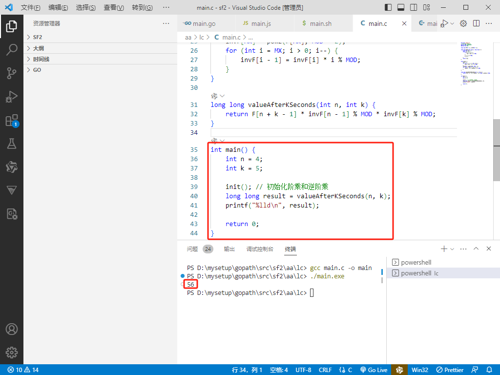

C完整代码如下:
#include <stdio.h>
// #include <math.h>
#define MOD 1000000007
#define MX 2000
long long F[MX + 1], invF[MX + 1];
long long pow2(long long x, long long n) {
    long long res = 1;
    while (n > 0) {
        if (n % 2 == 1) {
            res = res * x % MOD;
        x = x * x % MOD;
        n /= 2;
    return res;
void init() {
    F[0] = 1;
    for (int i = 1; i <= MX; i++) {
        F[i] = F[i - 1] * i % MOD;
    invF[MX] = pow2(F[MX], MOD - 2);
    for (int i = MX; i > 0; i--) {
        invF[i - 1] = invF[i] * i % MOD;
long long valueAfterKSeconds(int n, int k) {
    return F[n + k - 1] * invF[n - 1] % MOD * invF[k] % MOD;
int main() {
    int n = 4;
    int k = 5;
    init(); // 初始化阶乘和逆阶乘
    long long result = valueAfterKSeconds(n, k);
    printf("%lld\n", result);
    return 0;

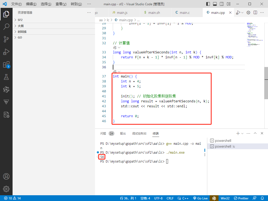

C++完整代码如下:
#include <iostream>
#define MX 2000
// 快速幂计算
long long pow(long long x, long long n) {
    long long res = 1;
    while (n > 0) {
        if (n % 2 == 1) {
        x = x * x % MOD;
        n /= 2;
    return res;
// 初始化阶乘和逆阶乘
void init() {
    F[0] = 1;
    invF[MX] = pow(F[MX], MOD - 2);
// 计算值
int main() {
    int n = 4;
    int k = 5;
    std::cout << result << std::endl;
    return 0;

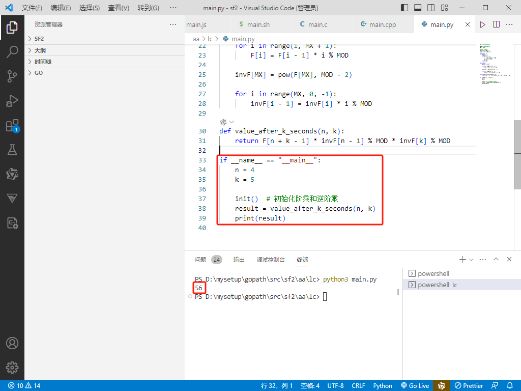

Python完整代码如下:
# -*-coding:utf-8-*-
MOD = 1_000_000_007
MX = 2000
# 阶乘和逆阶乘
F = [1] * (MX + 1)
invF = [1] * (MX + 1)
def pow(x, n):
    res = 1
    while n > 0:
        if n % 2 == 1:
            res = res * x % MOD
        x = x * x % MOD
        n //= 2
    return res
def init():
    global F, invF
    for i in range(1, MX + 1):
    for i in range(MX, 0, -1):
def value_after_k_seconds(n, k):
if __name__ == "__main__":
    n = 4
    k = 5
    init()  # 初始化阶乘和逆阶乘
    result = value_after_k_seconds(n, k)
    print(result)

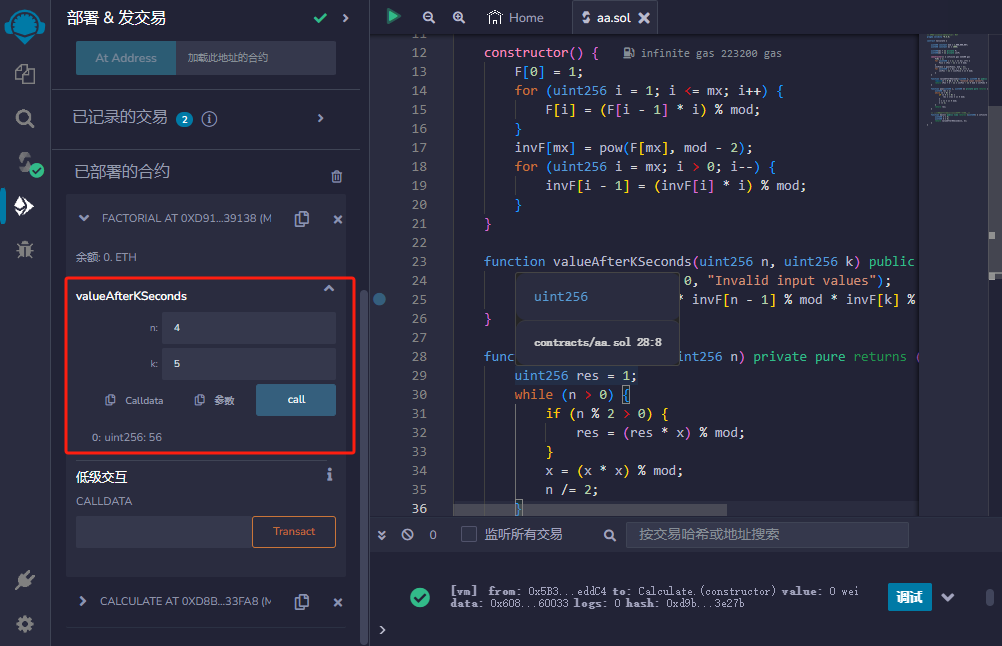

Solidity语言完整代码如下:
// SPDX-License-Identifier: MIT
pragma solidity ^0.8.0;
contract Calculate {
    uint256 constant mod = 1_000_000_007;
    uint256 constant mx = 2000;
    uint256[mx + 1] private F;
    uint256[mx + 1] private invF;
    constructor() {
        F[0] = 1;
        for (uint256 i = 1; i <= mx; i++) {
            F[i] = (F[i - 1] * i) % mod;
        invF[mx] = pow(F[mx], mod - 2);
        for (uint256 i = mx; i > 0; i--) {
            invF[i - 1] = (invF[i] * i) % mod;
    function valueAfterKSeconds(uint256 n, uint256 k) public view returns (uint256) {
        require(n > 0 && k >= 0, "Invalid input values");
        return (F[n + k - 1] * invF[n - 1] % mod * invF[k] % mod);
    function pow(uint256 x, uint256 n) private pure returns (uint256) {
        uint256 res = 1;
        while (n > 0) {
            if (n % 2 > 0) {
                res = (res * x) % mod;
            x = (x * x) % mod;
            n /= 2;
        return res;
    // 主函数模拟,不能在智能合约中直接使用
    function main() public view returns (uint256) {
        uint256 n = 4;
        uint256 k = 5;
        return valueAfterKSeconds(n, k);
