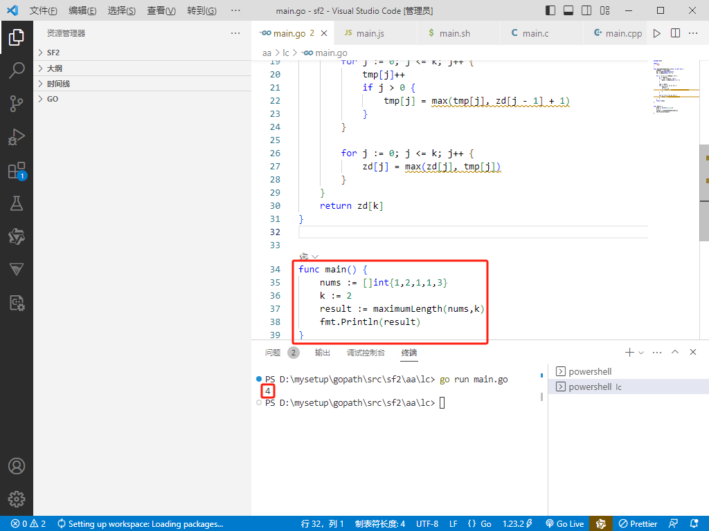

Go完整代码如下:
package main
import (
	"fmt"
func maximumLength(nums []int, k int) int {
    lenNums := len(nums)
	dp := make(map[int][]int)
	zd := make([]int, k + 1)
	for i := 0; i < lenNums; i++ {
		v := nums[i]
		if _, ok := dp[v]; !ok {
			dp[v] = make([]int, k + 1)
		tmp := dp[v]
		for j := 0; j <= k; j++ {
			tmp[j]++
			if j > 0 {
				tmp[j] = max(tmp[j], zd[j - 1] + 1)
			zd[j] = max(zd[j], tmp[j])
	return zd[k]
func main() {
	nums := []int{1,2,1,1,3}
    k := 2
	result := maximumLength(nums,k)
	fmt.Println(result)

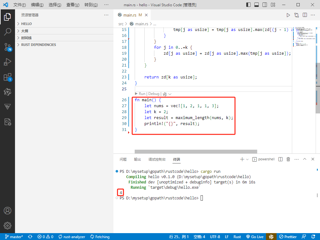

Rust完整代码如下:
use std::collections::HashMap;
fn maximum_length(nums: Vec<i32>, k: i32) -> i32 {
    let len_nums = nums.len();
    let mut dp: HashMap<i32, Vec<i32>> = HashMap::new();
    let mut zd = vec![0; (k + 1) as usize];
    for i in 0..len_nums {
        let v = nums[i];
        dp.entry(v).or_insert(vec![0; (k + 1) as usize]);
        let tmp = dp.get_mut(&v).unwrap();
        for j in 0..=k {
            tmp[j as usize] += 1;
            if j > 0 {
                tmp[j as usize] = tmp[j as usize].max(zd[(j - 1) as usize] + 1);
        for j in 0..=k {
            zd[j as usize] = zd[j as usize].max(tmp[j as usize]);
    return zd[k as usize];
fn main() {
    let nums = vec![1, 2, 1, 1, 3];
    let k = 2;
    let result = maximum_length(nums, k);
    println!("{}", result);

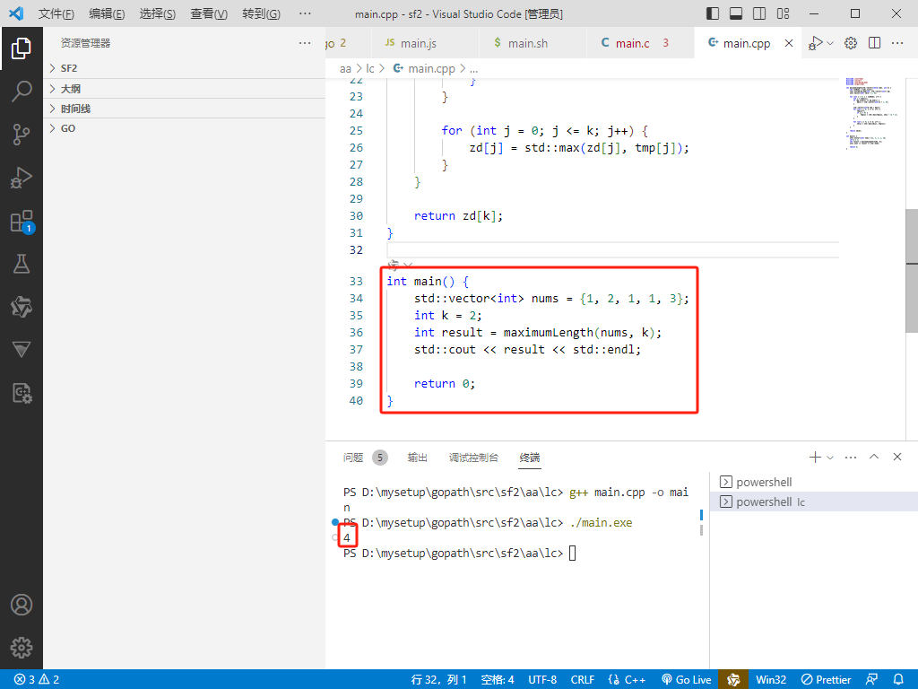

C++完整代码如下:
#include <iostream>
#include <vector>
#include <unordered_map>
#include <algorithm>
int maximumLength(std::vector<int>& nums, int k) {
    int lenNums = nums.size();
    std::unordered_map<int, std::vector<int>> dp;
    std::vector<int> zd(k + 1, 0);
    for (int i = 0; i < lenNums; i++) {
        int v = nums[i];
        if (dp.find(v) == dp.end()) {
            dp[v] = std::vector<int>(k + 1, 0);
        std::vector<int>& tmp = dp[v];
        for (int j = 0; j <= k; j++) {
            tmp[j]++;
            if (j > 0) {
                tmp[j] = std::max(tmp[j], zd[j - 1] + 1);
            zd[j] = std::max(zd[j], tmp[j]);
    return zd[k];
int main() {
    std::vector<int> nums = {1, 2, 1, 1, 3};
    int k = 2;
    int result = maximumLength(nums, k);
    std::cout << result << std::endl;
    return 0;

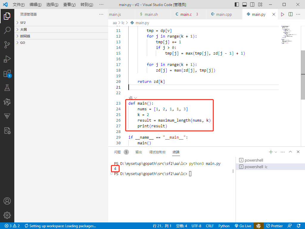

Python完整代码如下:
def maximum_length(nums, k):
    len_nums = len(nums)
    dp = {}
    zd = [0] * (k + 1)
    for i in range(len_nums):
        v = nums[i]
        if v not in dp:
            dp[v] = [0] * (k + 1)
        tmp = dp[v]
        for j in range(k + 1):
            tmp[j] += 1
            if j > 0:
    return zd[k]
def main():
    nums = [1, 2, 1, 1, 3]
    k = 2
    print(result)
if __name__ == "__main__":
    main()

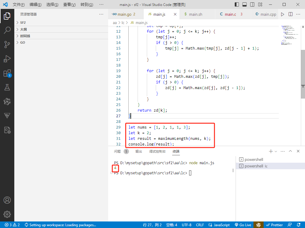

JavaScript完整代码如下:
function maximumLength(nums, k) {
    let lenNums = nums.length;
    let dp = {};
    let zd = new Array(k + 1).fill(0);
    for (let i = 0; i < lenNums; i++) {
        let v = nums[i];
        if (!(v in dp)) {
            dp[v] = new Array(k + 1).fill(0);
        let tmp = dp[v];
        for (let j = 0; j <= k; j++) {
            tmp[j]++;
            if (j > 0) {
                tmp[j] = Math.max(tmp[j], zd[j - 1] + 1);
            zd[j] = Math.max(zd[j], tmp[j]);
    return zd[k];
let nums = [1, 2, 1, 1, 3];
let k = 2;
let result = maximumLength(nums, k);
console.log(result);

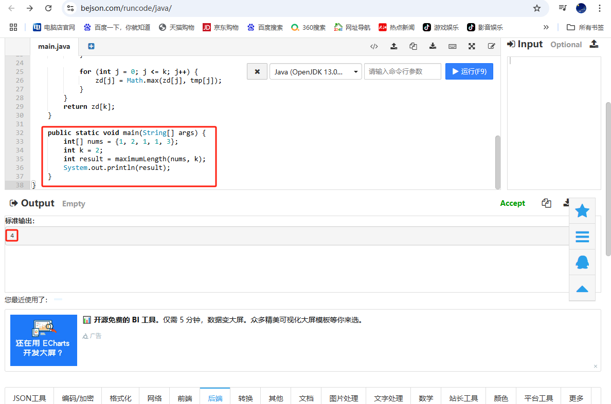

Java完整代码如下:
import java.util.HashMap;
import java.util.Map;
 public class Main {
    public static int maximumLength(int[] nums, int k) {
        int lenNums = nums.length;
        Map<Integer, int[]> dp = new HashMap<>();
        int[] zd = new int[k + 1];
            int v = nums[i];
            if (!dp.containsKey(v)) {
                dp.put(v, new int[k + 1]);
            int[] tmp = dp.get(v);
                tmp[j]++;
                if (j > 0) {
        return zd[k];
        int[] nums = {1, 2, 1, 1, 3};
        int k = 2;
        System.out.println(result);
