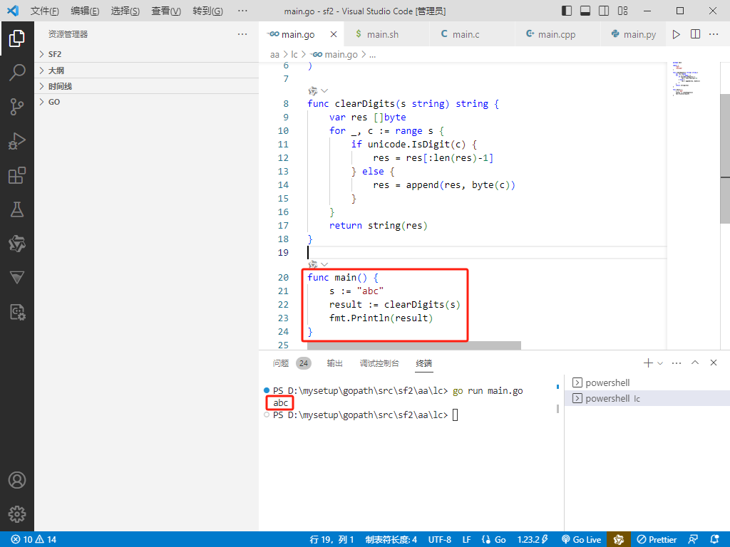

Go完整代码如下:
package main
import (
	"fmt"
	"unicode"
func clearDigits(s string) string {
	var res []byte
	for _, c := range s {
		if unicode.IsDigit(c) {
			res = res[:len(res)-1]
		} else {
			res = append(res, byte(c))
	return string(res)
func main() {
	s := "abc"
	result := clearDigits(s)
	fmt.Println(result)

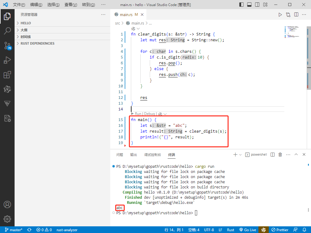

Rust完整代码如下:
fn clear_digits(s: &str) -> String {
    let mut res = String::new();
    for c in s.chars() {
        if c.is_digit(10) {
            res.pop();
        } else {
            res.push(c);
    res
fn main() {
    let s = "abc";
    let result = clear_digits(s);
    println!("{}", result);

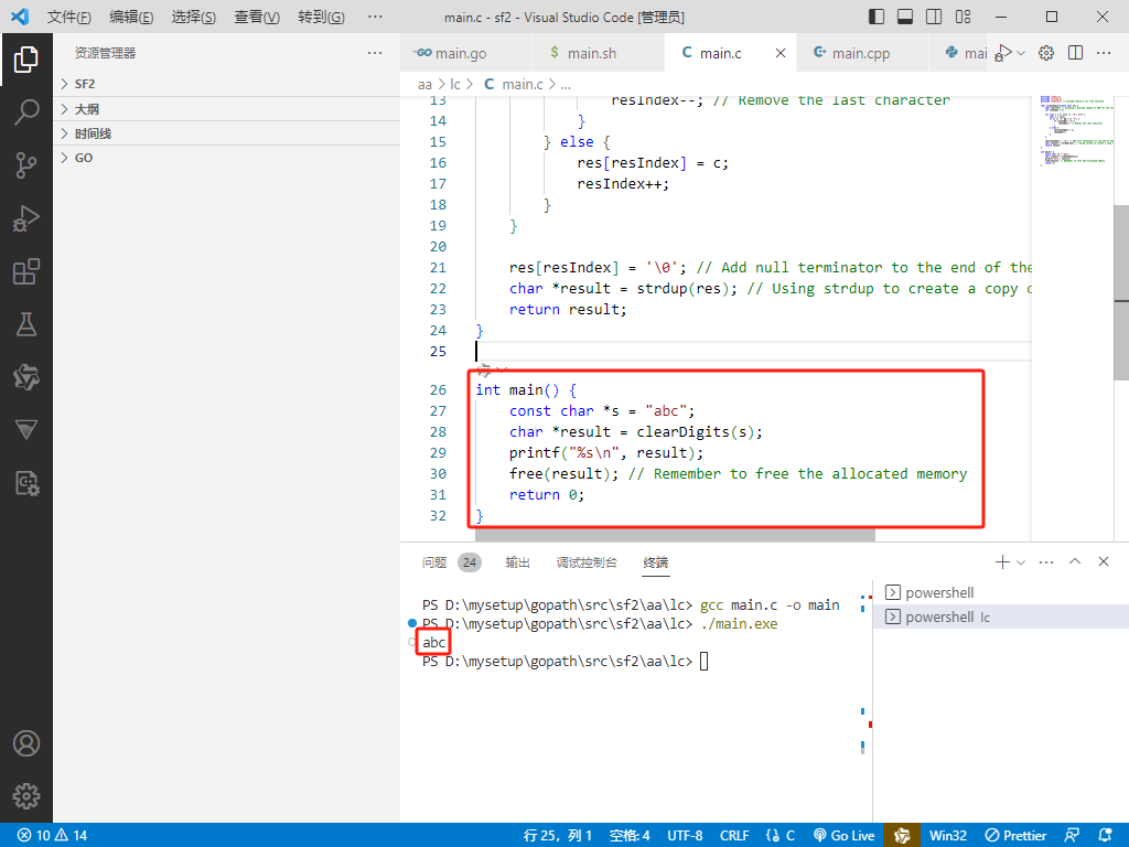

C完整代码如下:
#include <stdio.h>
#include <string.h>
#include <stdlib.h> // Include stdlib.h for free function
char *clearDigits(const char *s) {
    char res[100]; // Assuming a maximum length of 100 for the resulting string
    int resIndex = 0;
    for (int i = 0; s[i] != '\0'; i++) {
        char c = s[i];
        if (c >= '0' && c <= '9') {
            if (resIndex > 0) {
                resIndex--; // Remove the last character
        } else {
            res[resIndex] = c;
            resIndex++;
    res[resIndex] = '\0'; // Add null terminator to the end of the string
    char *result = strdup(res); // Using strdup to create a copy of the resulting string
    return result;
int main() {
    const char *s = "abc";
    char *result = clearDigits(s);
    printf("%s\n", result);
    free(result); // Remember to free the allocated memory
    return 0;

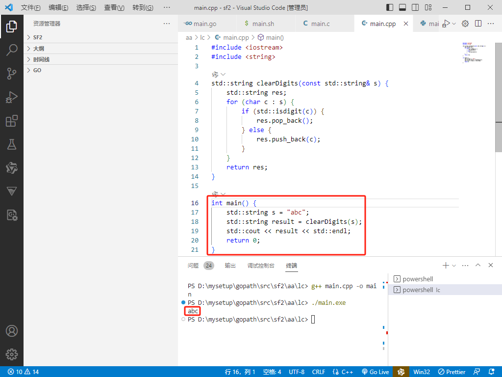

C++完整代码如下:
#include <iostream>
#include <string>
std::string clearDigits(const std::string& s) {
    std::string res;
    for (char c : s) {
        if (std::isdigit(c)) {
            res.pop_back();
        } else {
            res.push_back(c);
    return res;
int main() {
    std::string s = "abc";
    std::string result = clearDigits(s);
    std::cout << result << std::endl;
    return 0;

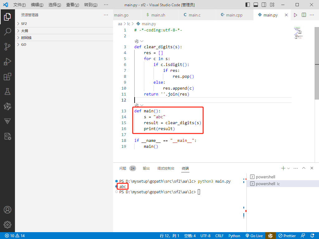

Python完整代码如下:
# -*-coding:utf-8-*-
def clear_digits(s):
    res = []
    for c in s:
        if c.isdigit():
            if res:
                res.pop()
        else:
            res.append(c)
    return ''.join(res)
def main():
    s = "abc"
    print(result)
if __name__ == "__main__":
    main()

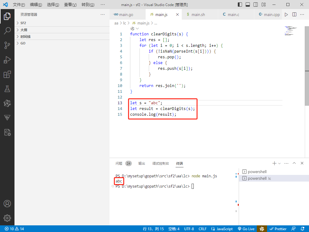

JavaScript完整代码如下:
function clearDigits(s) {
    let res = [];
    for (let i = 0; i < s.length; i++) {
        if (!isNaN(parseInt(s[i]))) {
            res.pop();
        } else {
            res.push(s[i]);
    return res.join('');
let s = "abc";
let result = clearDigits(s);
console.log(result);
