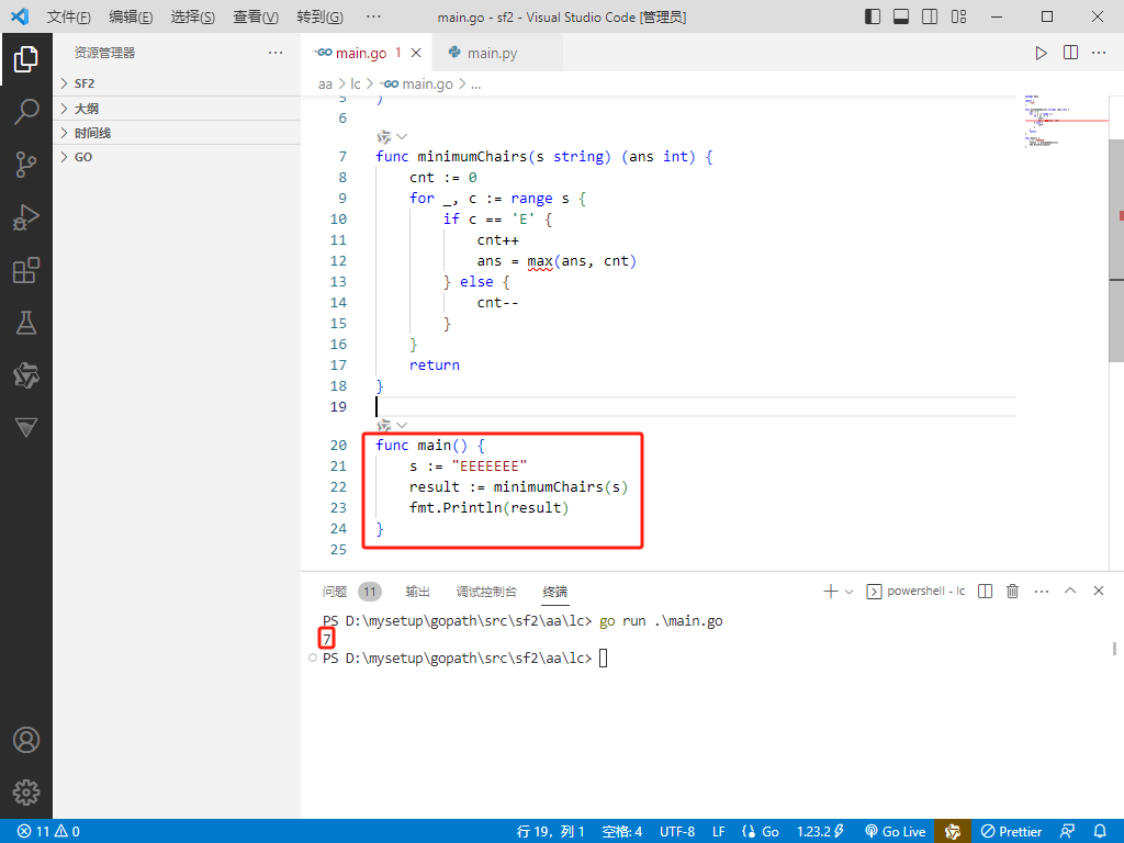

Go完整代码如下:
package main
import (
"fmt"
func minimumChairs(s string) (ans int) {
cnt := 0
for _, c := range s {
if c == 'E' {
cnt++
ans = max(ans, cnt)
} else {
cnt--
return
func main() {
s := "EEEEEEE"
result := minimumChairs(s)
fmt.Println(result)

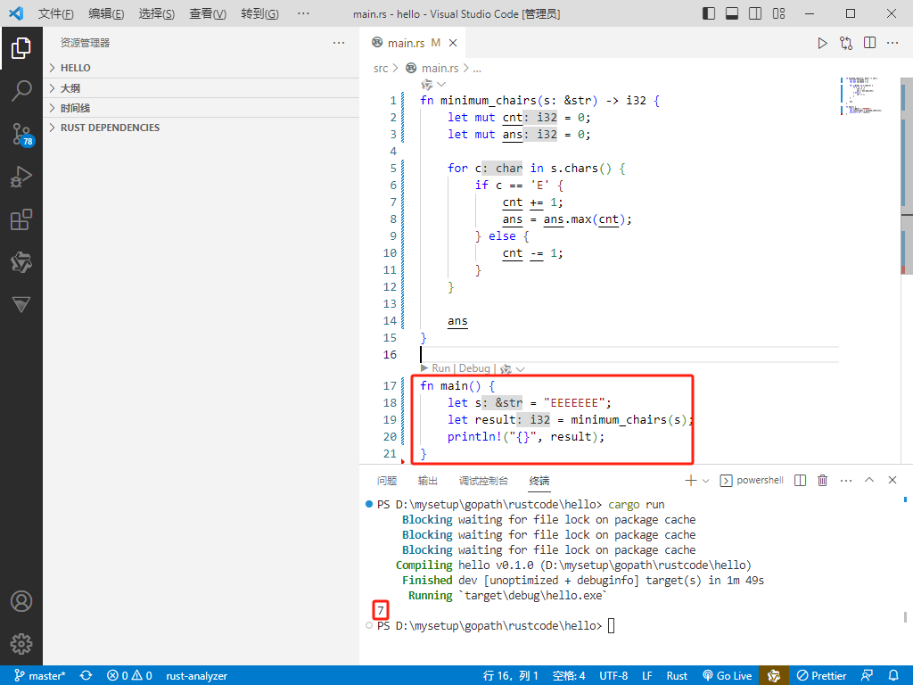

Rust完整代码如下:
fn minimum_chairs(s: &str) -> i32 {
let mut cnt = 0;
let mut ans = 0;
for c in s.chars() {
if c == 'E' {
cnt += 1;
ans = ans.max(cnt);
} else {
cnt -= 1;
ans
fn main() {
let s = "EEEEEEE";
let result = minimum_chairs(s);
println!("{}", result);

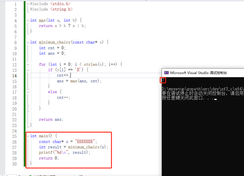

C完整代码如下:
#include <stdio.h>
#include <string.h>
int max(int a, int b) {
return a > b ? a : b;
int minimum_chairs(const char* s) {
int cnt = 0;
int ans = 0;
for (int i = 0; i < strlen(s); i++) {
if (s[i] == 'E') {
cnt++;
ans = max(ans, cnt);
else {
cnt--;
return ans;
int main() {
const char* s = "EEEEEEE";
int result = minimum_chairs(s);
printf("%d\n", result);
return 0;

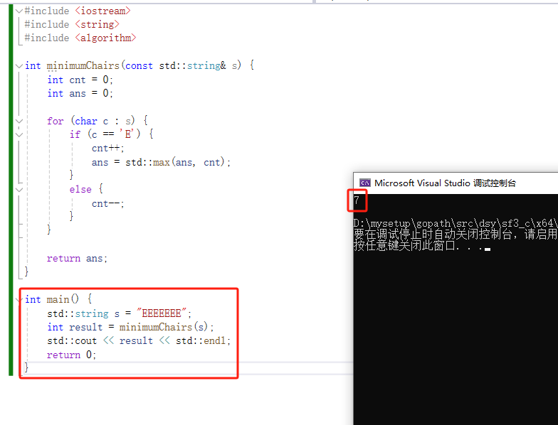

C++完整代码如下:
#include <iostream>
#include <string>
#include <algorithm>
int minimumChairs(const std::string& s) {
int cnt = 0;
int ans = 0;
for (char c : s) {
if (c == 'E') {
cnt++;
ans = std::max(ans, cnt);
else {
cnt--;
return ans;
int main() {
std::string s = "EEEEEEE";
int result = minimumChairs(s);
std::cout << result << std::endl;
return 0;

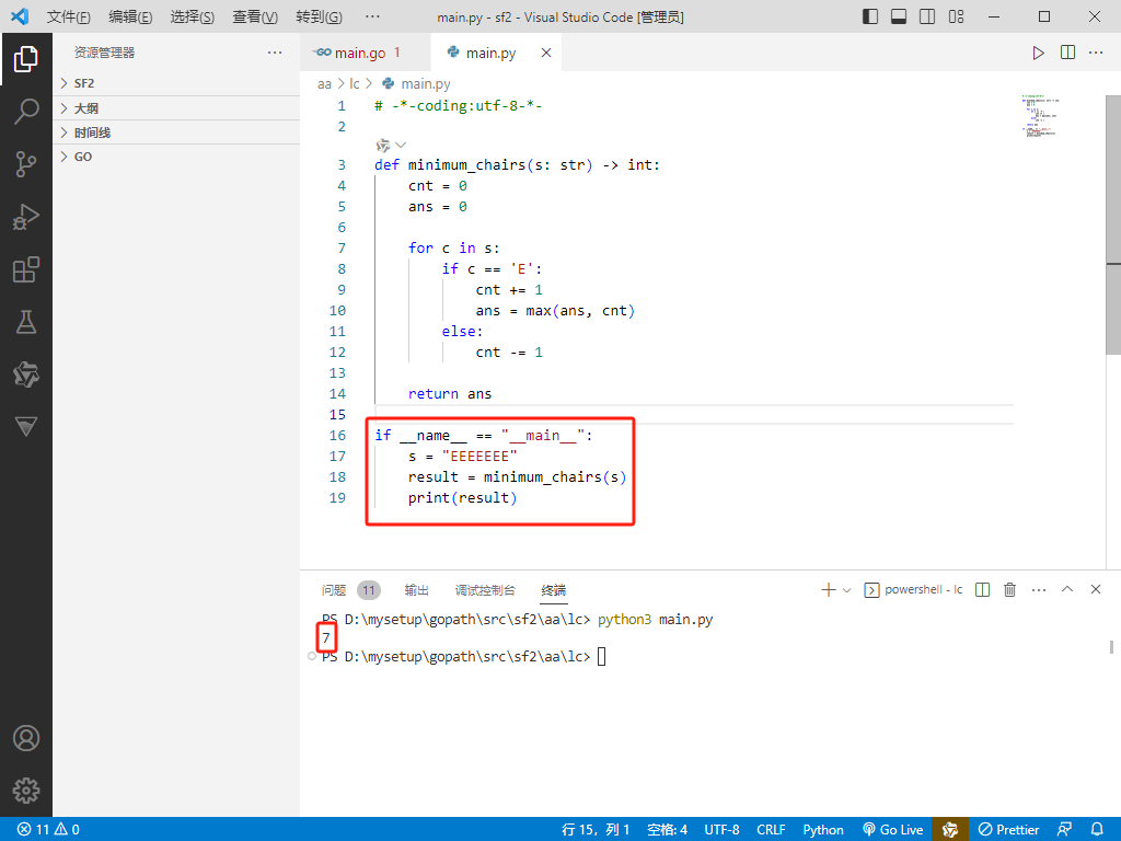

Python完整代码如下:
# -*-coding:utf-8-*-
def minimum_chairs(s: str) -> int:
cnt = 0
ans = 0
for c in s:
if c == 'E':
cnt += 1
ans = max(ans, cnt)
else:
cnt -= 1
return ans
if __name__ == "__main__":
s = "EEEEEEE"
print(result)

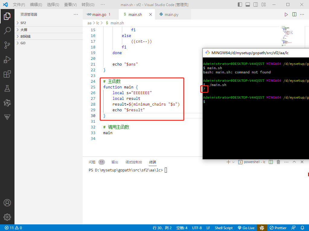

Shell完整代码如下:
#!/bin/bash
# 计算所需的最小椅子数量
function minimum_chairs {
local s="$1"
local cnt=0
local ans=0
for (( i=0; i<${#s}; i++ )); do
local c="${s:i:1}"
if [[ "$c" == "E" ]]; then
((cnt++))
if (( cnt > ans )); then
ans=$cnt
fi
else
((cnt--))
fi
done
echo "$ans"
# 主函数
function main {
local s="EEEEEEE"
local result
result=$(minimum_chairs "$s")
echo "$result"
# 调用主函数
main
