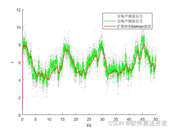

figure
scatter(tt*Ts,y1,20,[0.75,0.75,0.75],'.'); % 绘制噪声半径测量点
hold on
plot(tt*Ts,y0,'g:','LineWidth',2); % 绘制清洁半径轨迹
hold on
plot(tt*Ts,y_est(2,tt),'r','LineWidth',1); % 绘制DMK估计的半径轨迹
hold on
xlabel('t/s');
ylabel('r')
legend('含噪声测量信号','无噪声测量信号','扩散映射kalman滤波');

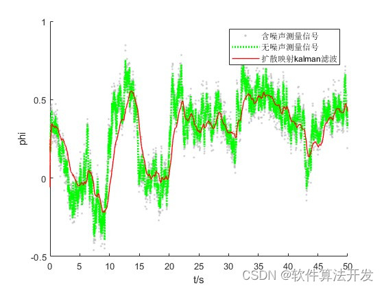

figure
scatter(tt*Ts,x1,20,[0.74,0.74,0.74],'.'); % 绘制噪声角度测量点
hold on
plot(tt*Ts,x0,'g:','LineWidth',2); % 绘制清洁角度轨迹
hold on
plot(tt*Ts,y_est(1,tt),'r','LineWidth',1); % 绘制DMK估计的角度轨迹
hold off;
xlabel('t/s');
ylabel('phi')
