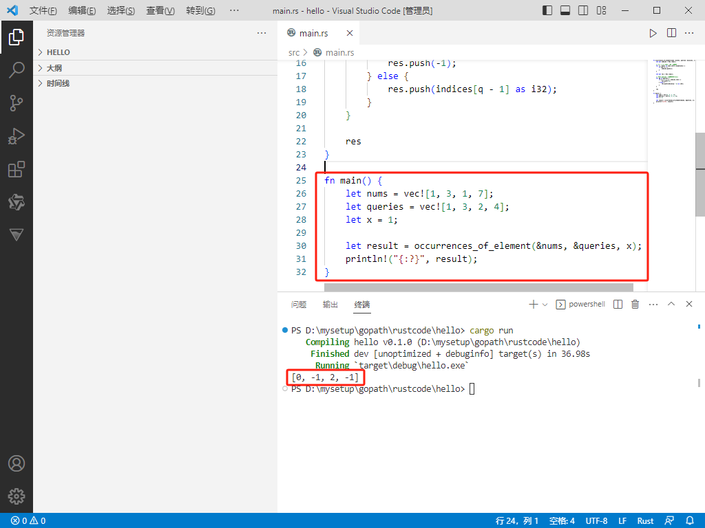

Rust完整代码如下:
fn occurrences_of_element(nums: &[i32], queries: &[usize], x: i32) -> Vec<i32> {
    let mut indices = Vec::new();
    // 找出 x 在 nums 中的所有索引
    for (i, &num) in nums.iter().enumerate() {
        if num == x {
            indices.push(i);
    let mut res = Vec::new();
    // 根据 queries 中的索引返回结果
    for &q in queries {
        if q == 0 || q > indices.len() {
            res.push(-1);
        } else {
            res.push(indices[q - 1] as i32);
    res
fn main() {
    let nums = vec![1, 3, 1, 7];
    let queries = vec![1, 3, 2, 4];
    let x = 1;
    let result = occurrences_of_element(&nums, &queries, x);
    println!("{:?}", result);
