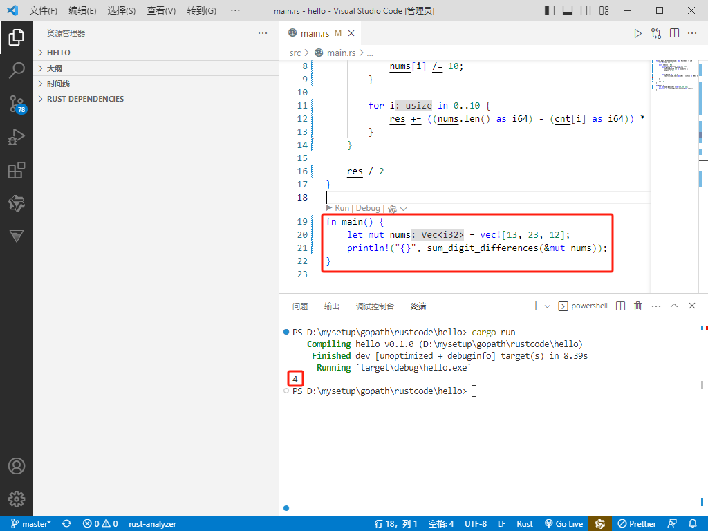

func main() {
	nums := []int{13, 23, 12}
	fmt.Println(sumDigitDifferences(nums))
Rust完整代码如下:
fn sum_digit_differences(nums: &mut Vec<i32>) -> i64 {
    let mut res: i64 = 0;
    while nums[0] > 0 {
        let mut cnt = vec![0; 10];
        for i in 0..nums.len() {
            cnt[(nums[i] % 10) as usize] += 1;
            nums[i] /= 10;
        for i in 0..10 {
            res += ((nums.len() as i64) - (cnt[i] as i64)) * (cnt[i] as i64);
    res / 2
fn main() {
    let mut nums = vec![13, 23, 12];
    println!("{}", sum_digit_differences(&mut nums));
