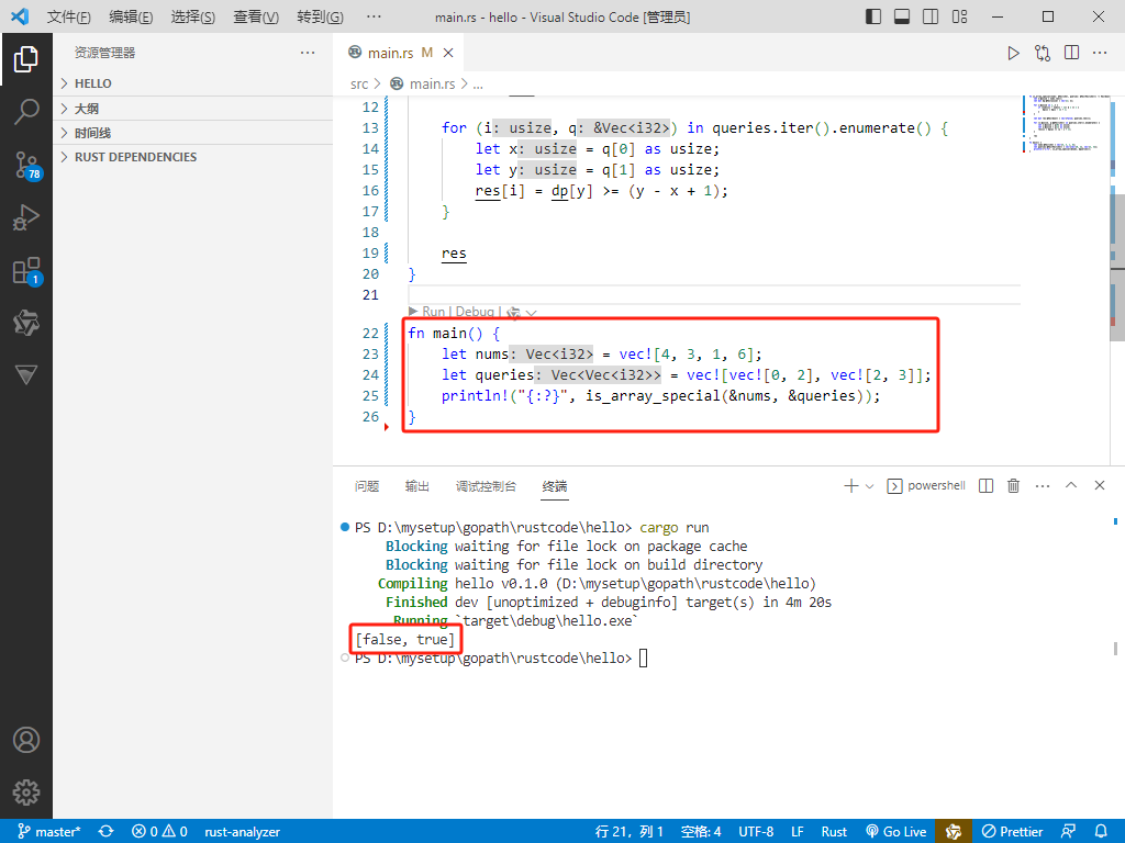

Rust完整代码如下:
fn is_array_special(nums: &Vec<i32>, queries: &Vec<Vec<i32>>) -> Vec<bool> {
    let n = nums.len();
    let mut dp = vec![1; n];
    for i in 1..n {
        if (nums[i] ^ nums[i - 1]) & 1 == 1 {
            dp[i] = dp[i - 1] + 1;
    let mut res = vec![false; queries.len()];
    for (i, q) in queries.iter().enumerate() {
        let x = q[0] as usize;
        let y = q[1] as usize;
        res[i] = dp[y] >= (y - x + 1);
    res
fn main() {
    let nums = vec![4, 3, 1, 6];
    let queries = vec![vec![0, 2], vec![2, 3]];
    println!("{:?}", is_array_special(&nums, &queries));
