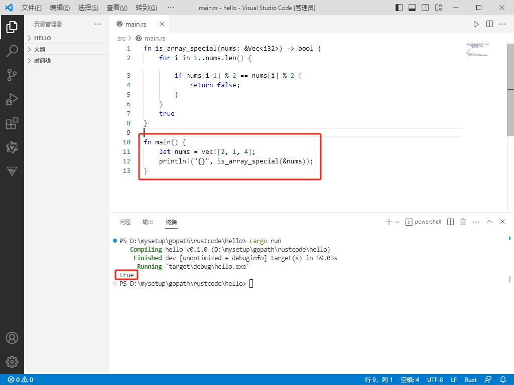

Rust完整代码如下:
fn is_array_special(nums: &Vec<i32>) -> bool {
    for i in 1..nums.len() {
        if nums[i-1] % 2 == nums[i] % 2 {
            return false;
    true
fn main() {
    let nums = vec![2, 1, 4];
    println!("{}", is_array_special(&nums));
