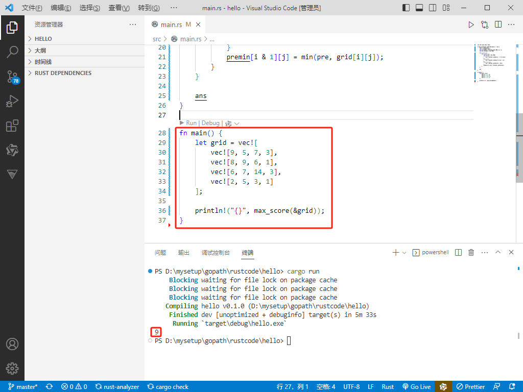

Rust完整代码如下:
use std::cmp::{min, max};
fn max_score(grid: &Vec<Vec<i32>>) -> i32 {
    let m = grid.len();
    let n = grid[0].len();
    let mut premin = vec![vec![i32::MAX; n]; 2];
    let mut ans = i32::MIN;
    for i in 0..m {
        for j in 0..n {
            let mut pre = i32::MAX;
            if i > 0 {
                pre = min(pre, premin[(i - 1) & 1][j]);
            if j > 0 {
                pre = min(pre, premin[i & 1][j - 1]);
            if i + j > 0 {
                ans = max(ans, grid[i][j] - pre);
            premin[i & 1][j] = min(pre, grid[i][j]);
    ans
fn main() {
    let grid = vec![
        vec![9, 5, 7, 3],
        vec![8, 9, 6, 1],
        vec![6, 7, 14, 3],
        vec![2, 5, 3, 1]
    println!("{}", max_score(&grid));
