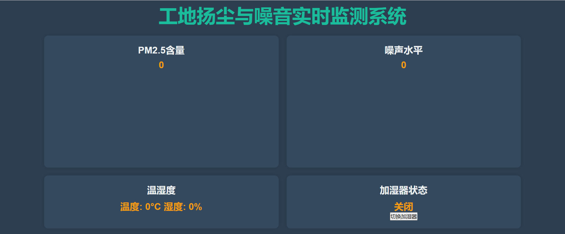

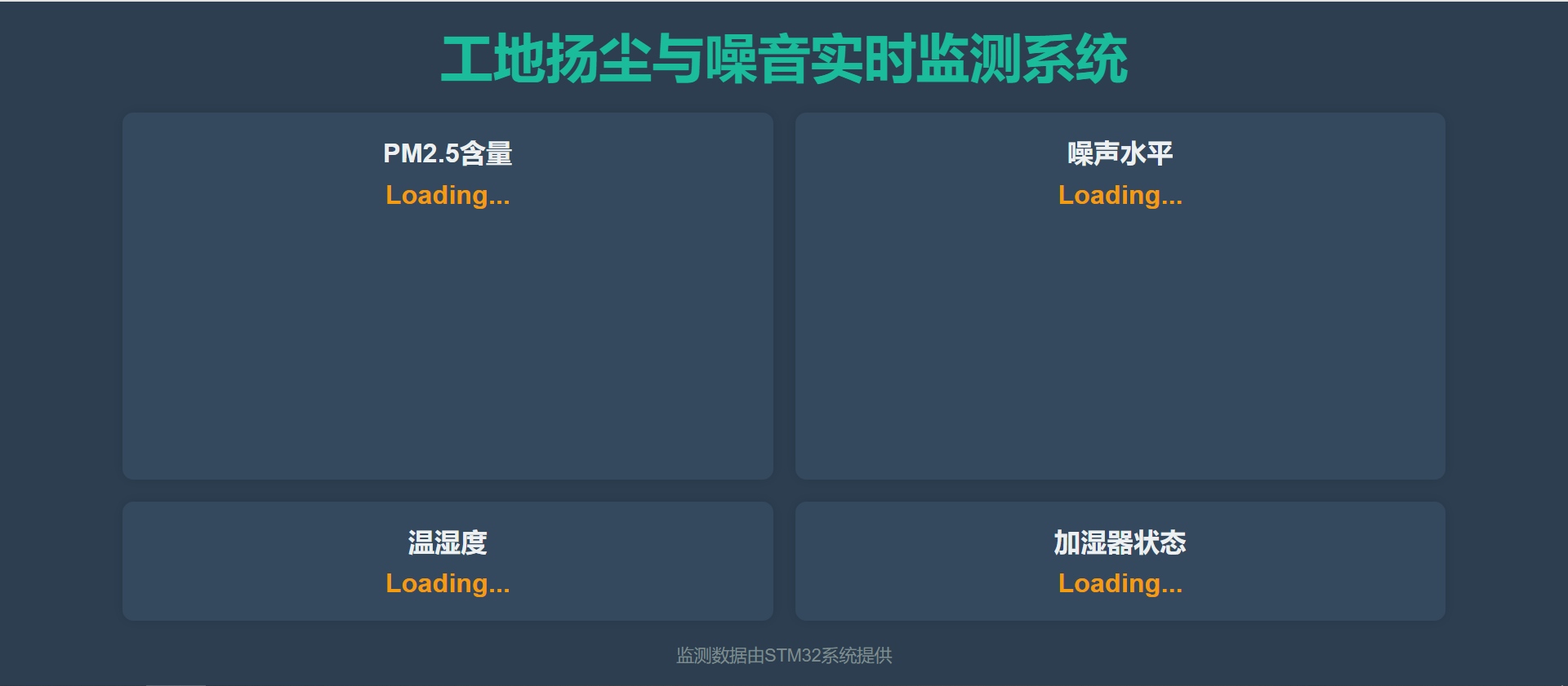

3.2 HTML前端代码(index.html)
<!DOCTYPE html>
<html lang="zh">
<head>
    <meta charset="UTF-8">
    <meta name="viewport" content="width=device-width, initial-scale=1.0">
    <title>工地扬尘与噪音监测系统</title>
    <link rel="stylesheet" href="style.css">
    <script src="https://cdn.jsdelivr.net/npm/chart.js"></script> <!-- 图表库 -->
    <script src="https://cdn.jsdelivr.net/npm/echarts@5.4.2/dist/echarts.min.js"></script> <!-- ECharts图表库 -->
</head>
<body>
    <div class="container">
        <header>
            <h1>工地扬尘与噪音实时监测系统</h1>
        </header>
        <section class="dashboard">
            <!-- PM2.5 -->
            <div class="card pm25">
                <h2>PM2.5含量</h2>
                <div id="pm25-value">0</div>
                <canvas id="pm25-chart"></canvas>
            </div>
            <!-- 噪音 -->
            <div class="card noise">
                <h2>噪声水平</h2>
                <div id="noise-value">0</div>
                <canvas id="noise-chart"></canvas>
            </div>
            <!-- 温湿度 -->
            <div class="card temp-humidity">
                <h2>温湿度</h2>
                <div id="temp-humidity-value">温度: 0°C 湿度: 0%</div>
            </div>
            <!-- 加湿器状态 -->
            <div class="card humidifier">
                <h2>加湿器状态</h2>
                <div id="humidifier-status">关闭</div>
                <button id="humidifier-toggle">切换加湿器</button>
            </div>
        </section>
        <footer>
            <p>监测数据由STM32系统提供</p>
        </footer>
    </div>
    <script src="script.js"></script>
</body>
</html>

3.5 运行效果
image-20241214005600960
image-20241214005548798
