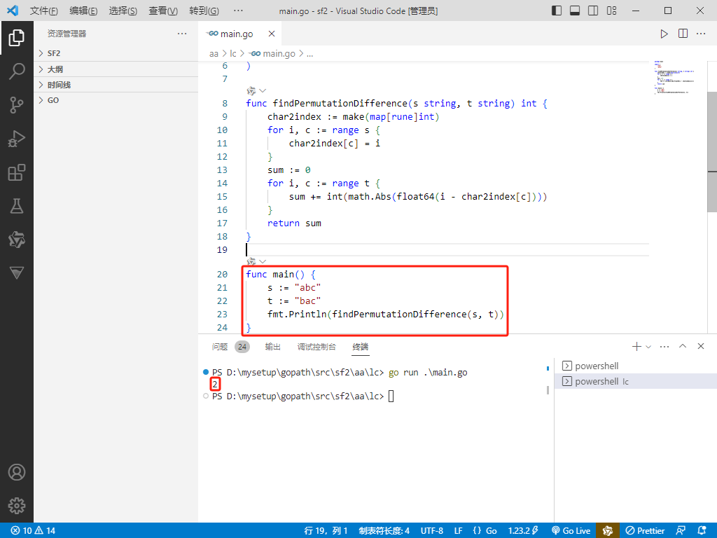

Go完整代码如下:
package main
import (
	"fmt"
	"math"
func findPermutationDifference(s string, t string) int {
	char2index := make(map[rune]int)
	for i, c := range s {
		char2index[c] = i
	sum := 0
	for i, c := range t {
		sum += int(math.Abs(float64(i - char2index[c])))
	return sum
func main() {
	s := "abc"
	t := "bac"
	fmt.Println(findPermutationDifference(s, t))

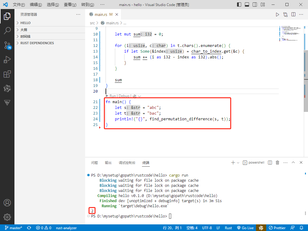

Rust完整代码如下:
use std::collections::HashMap;
fn find_permutation_difference(s: &str, t: &str) -> i32 {
    let mut char_to_index: HashMap<char, usize> = HashMap::new();
    for (i, c) in s.chars().enumerate() {
        char_to_index.insert(c, i);
    let mut sum = 0;
    for (i, c) in t.chars().enumerate() {
        if let Some(&index) = char_to_index.get(&c) {
            sum += (i as i32 - index as i32).abs();
    sum
fn main() {
    let s = "abc";
    let t = "bac";
    println!("{}", find_permutation_difference(s, t));
